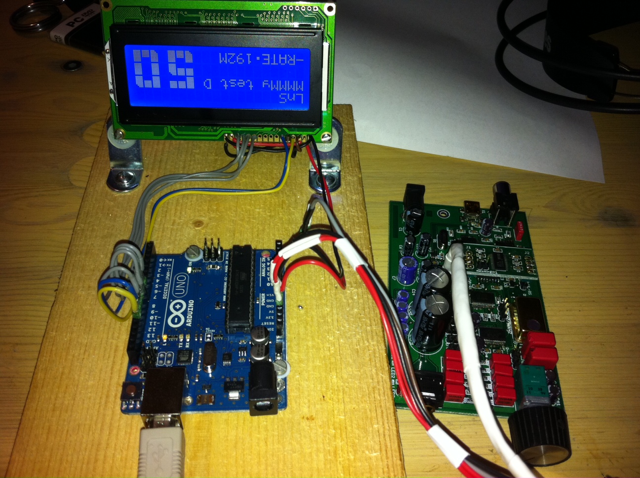

So far...
Board is ready and functioning.
Arduino and LCD are functioning.
The code is now almost ported to arduino 1.0 and new LiquidCrystal lib. I haven't tested the contrast or brightness stuff yet nor the volume or anything that needs the rotatonal encoder or the remote. I have of course tested the default volume setting and it changes volume (but it's of course a PIA to compile for evert volumechange needed ;-) ) The code looks as it will work without any major tweaks needed.
Are the codes for the serial and parallel settings the same for brightness and contrast (should be...)? I couln't find these in the buffalocode or I missed them...
So, tomorrow is the day to hunt down one Apple remote and rotational encoder. Updates are coming and when done the code if not someone is eager and needs it right away. Just tell and I'll upload what I have.
Brgds
