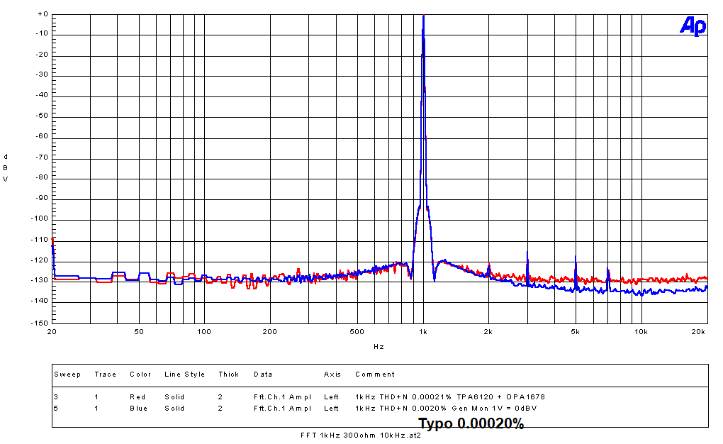

Have you tried a non-inverting configuration, similar to the one Bamboszek has used ? Do you have an opinion on the performance of the one from Basboszek (and perhaps the Topping L30, using the OPA1612 and a slightly different compensation compared to Bamboszeks) compared to your inverting design?
One of things I wanted to examine was inverting vs non-inverting configuration effect on distortion. That was reason why I decided to try OPA1602. You probably seen those posts, but anyway:
https://www.diyaudio.com/forums/vendor-s-bazaar/283672-audio-op-amp-opa1622-3.html#post4554515
https://www.diyaudio.com/forums/vendor-s-bazaar/283672-audio-op-amp-opa1622-9.html#post4636374
https://www.diyaudio.com/forums/vendor-s-bazaar/283672-audio-op-amp-opa1622-10.html#post4637092
I already reached performance cap of APx525 so didn't bothered with inverting topology as higher input impedance and preserved absolute polarity is rather useful. But inverting topology is indeed worth trying if we want to squeeze last dBs of THD.

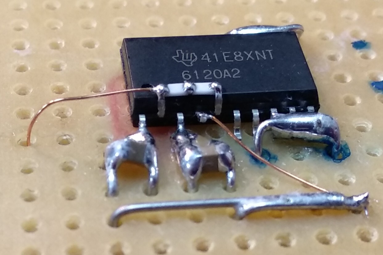

My current design Tpa6120 use 0 ohm output resistor.
BamboszeK is absolutely correct in my opinion. You throw around the term stability and claim to have a design with 0 Ohm output resistor, but how exactly did you verify stability and what kinds of phase margins are we talking into typical headphone loads?
It isn't TPA6120 specific. To maintain loop stability, output of the amplifier need to be isolated from capacitive load. Resistor is cheapest way of doing it.
Some opamps are stable up to certain load capatiance without additional isolation, up to couple hundreds of pF usually. That's why you often won't see any resistor at output of headphone amplifiers.
Inductor is the better way of doing it, but it's considerably larger and more expensive. Doesn't limit power and output impedance however. Standard practice in speaker amplifiers.
I really simplified things. More in-depth explanation could be found in most books about analog design or this article Op Amps Driving Capacitive Loads | Analog Devices
