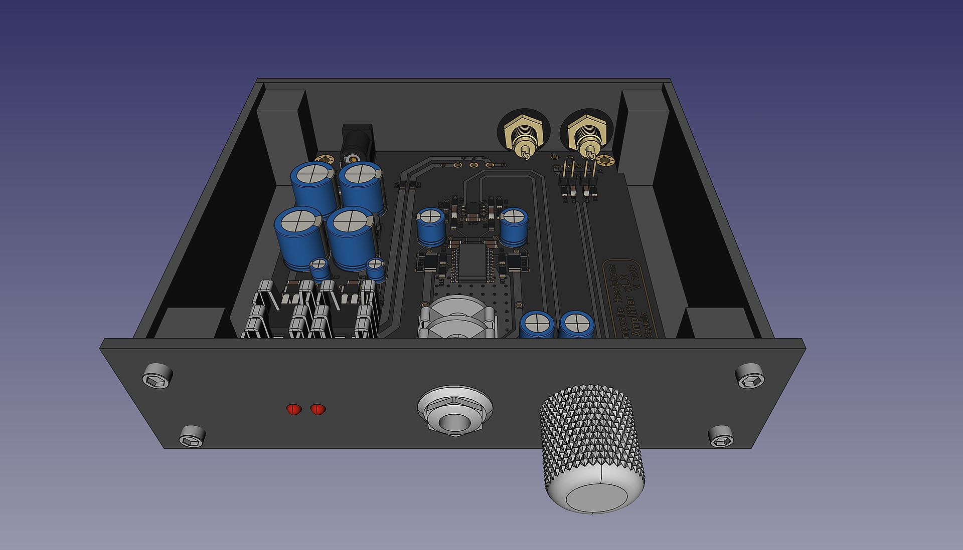

However I tried to design some enclosure. It's not that ugly, especially considering that was first time I did mechanical design and used CAD software 🙄
I need to admit that KiCad is much more intuitive than FreeCAD. I guess commercial software like Inventor is much better in that field.

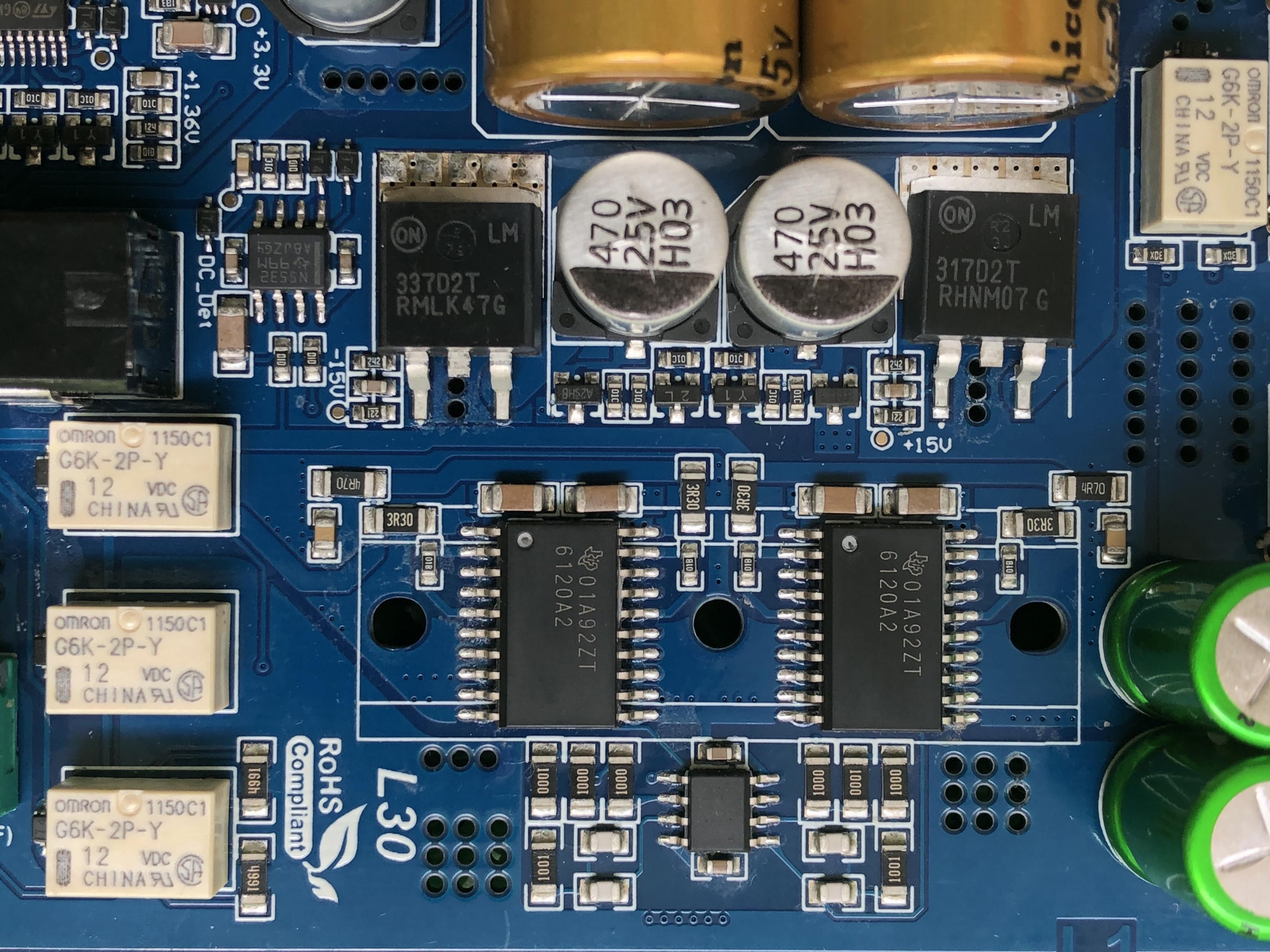

Topping L30, as evident from the "L30" silkscreen. The feedback network in the inner loop is interesting, I haven't seen that exact arrangement before.

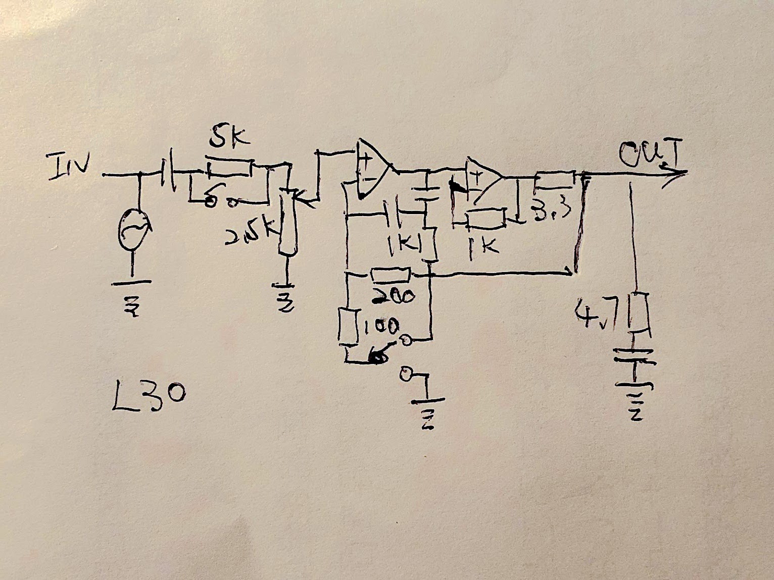

Thanks for schematic. Topology is similar to my amplifier, yet feedback circuit is a bit more clever than mine. Topping L30 is new price/performance ratio king 😉You might find this useful...

TPA6120A2 is current-feedback amplifier. Compared to more popular VFA inverting input can't be connected directly output when used as a non inverting buffer. Value of feedback resistors sets closed loop bandwidth, instead of capacitor in feedback loop like in VFA. But that's right, I didn't seen that topology often.Topping L30, as evident from the "L30" silkscreen. The feedback network in the inner loop is interesting, I haven't seen that exact arrangement before.
When I was referring to the "inner loop" I obviously meant the "inner" global loop, not the local loop around the TPA6120A2, because there is really nothing "interesting" about that.
it looks like tpa6120 being used in unity gain which lowers the slew rate significantly and probably it makes it more stable.Yet we know nothing abot any possible components on the bottom layer....Topping L30, as evident from the "L30" silkscreen. The feedback network in the inner loop is interesting, I haven't seen that exact arrangement before.
