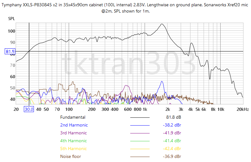

20 years ago the Peerless P830845 was Klippel'ed and it dialled in at 13mm x-max:

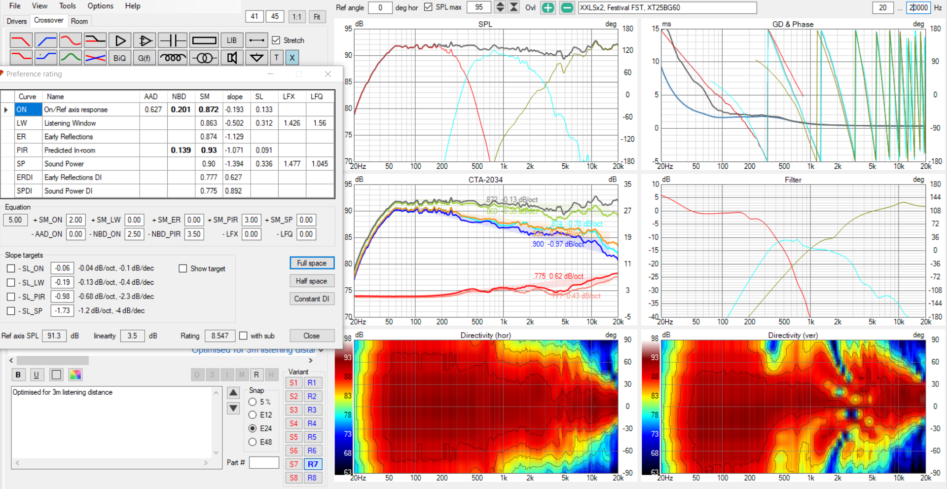

I designed a speaker with a pair of them. It simulates like this:
Here is a ground plane measurements from some time ago, with a basic electret condenser microphone:
I took this to check the 4pi simulation with VituixCAD2.
The dip at 500Hz is real, and the rise in H3 / H2 due to the cone resonance can be eliminated with a series notch filter for the 1.8KHz resonance, just as demonstrated on the datasheet:
The harmonics are likely even lower, in level, because of the limitation of the measurement technique (noise floor affected by outdoor noise, microphone self-noise affects ability to resolve harmonics etc)
I never documented the build/design, mainly because the mid-range and woofers were not readily available to buy.
I run it LR4 @380Hz:

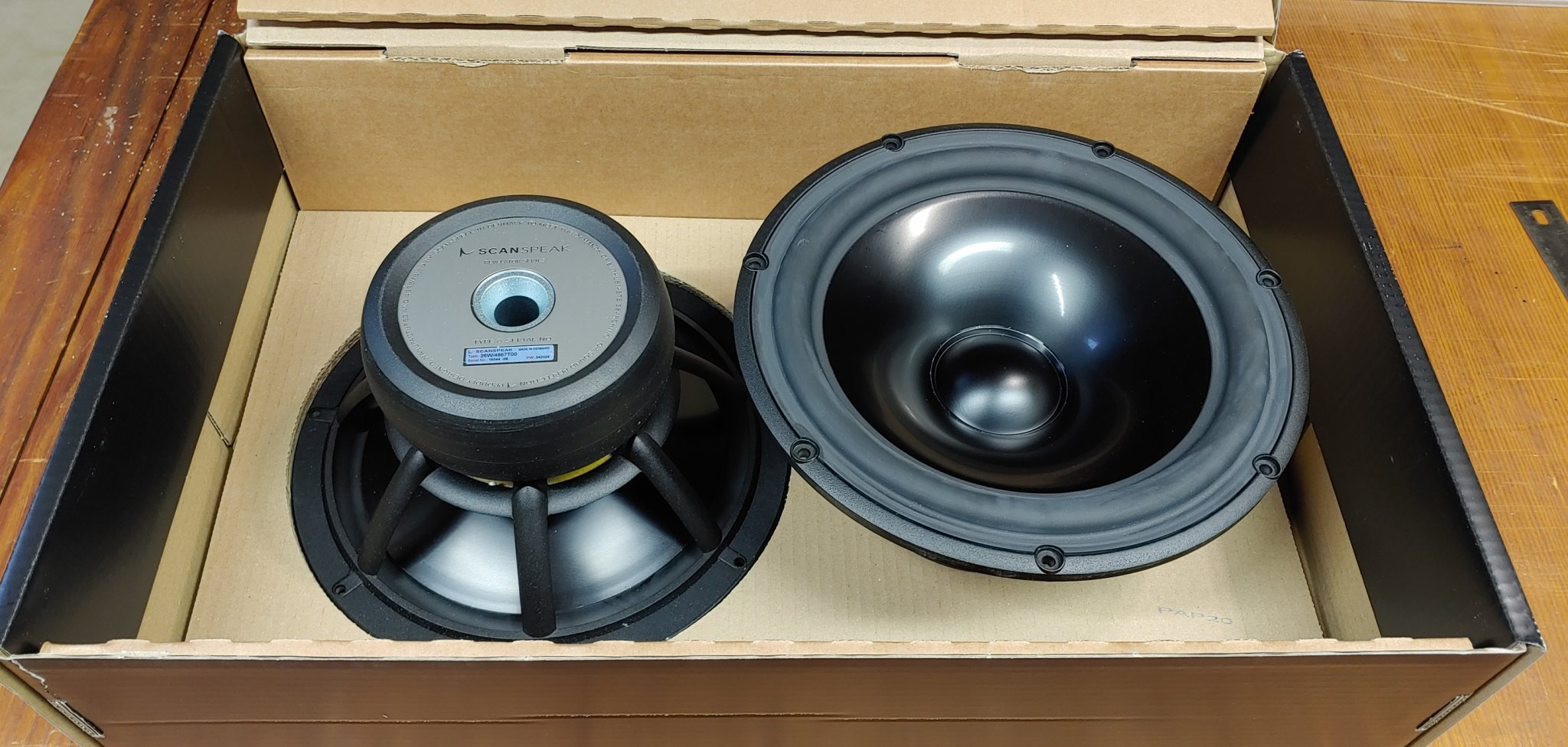

The woofers arrived. The SS Revelator 26W/4867T was packed well and shipped from Madisound without any problems.

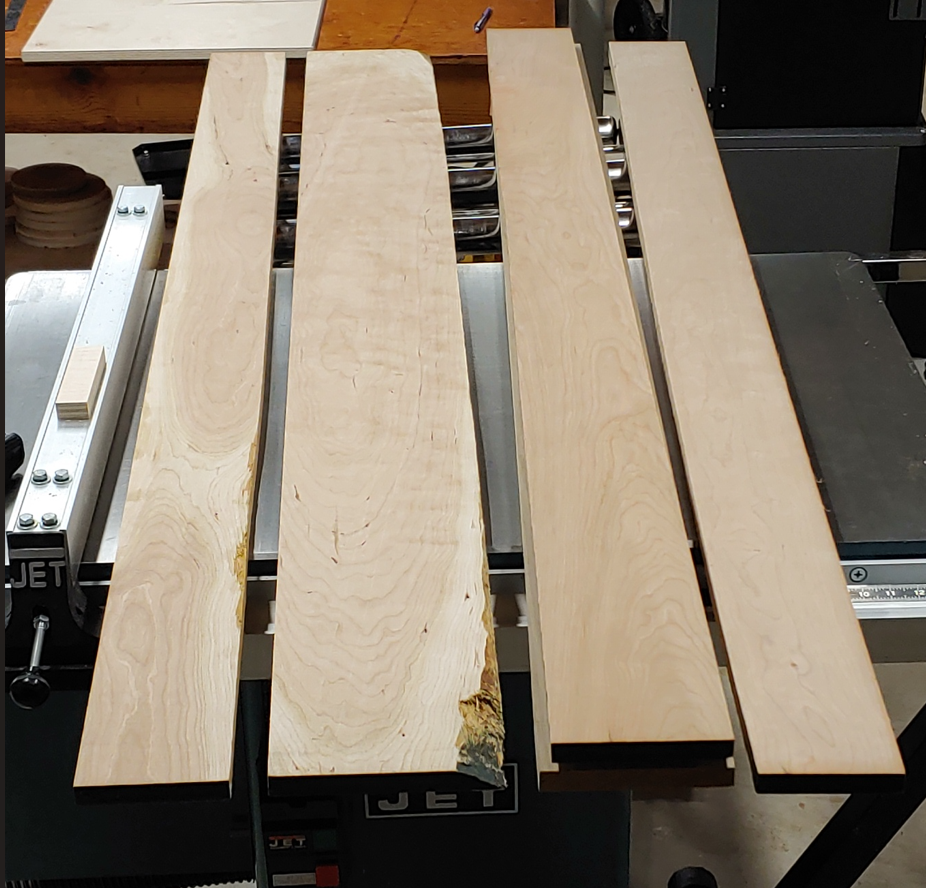

I also bought the hardwood lumber I will need to make the laminated baffle
