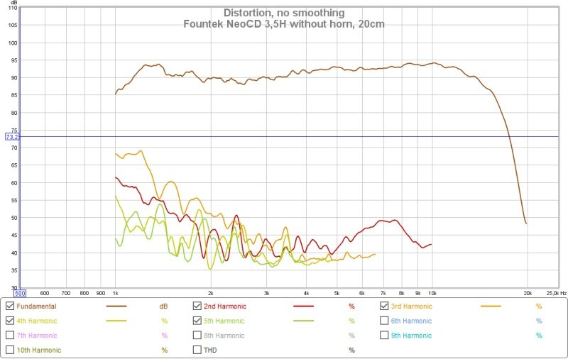

One of the challenges is interpreting the distortion from a -dB graph.
The tweeter appears to rise below about 2.5K according to Yevgeniy’s measurements… but it is rising from a very low -60dB.
One must take into account the absolute SPL. As @IamJF has demonstrated, the twin woofers have more THD than the tweeters or mids, which is not unusual.
I’ve often wondered whether this is why ribbon tweeters can still sound “good” despite having higher THD; they are high only when compared to their some cousins, but not when compared to their midrange or woofers they make friends with in a complete speaker.

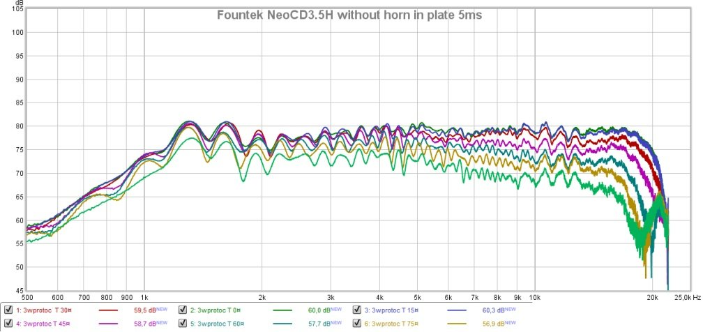

And, as I have recently discovered, although ribbons have relatively high directivity in the vertical plane, they have a low, constant directivity-like projection in the horizontal plane:

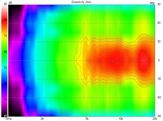

Given the scale, that’s one the most even HF horizontal dispersion drivers ever.One of the challenges is interpreting the distortion from a -dB graph.

The problem is the uneven directivity in the vertical plane! It's a "long" line and directivity totally changes in the 2kHz to 20kHz range.And, as I have recently discovered, although ribbons have relatively high directivity in the vertical plane, they have a low, constant directivity-like projection in the horizontal plane:
