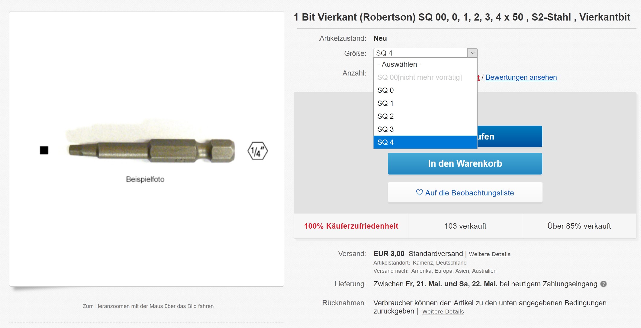

Huh, that's so bizarre, I just searched and you're right. I searched before and all I could find was weird listings... thanks a lot for pointing this out!
Same supplier, but two versions (select the size from the drop down options) 4 in stock of the first, 5 for the second listing:
1 Bit Square (Robertson) SQ 00, 0, 1, 2, 3, 4 x 25, S2 Steel, vierkantbit | eBay
1 Bit Square (Robertson) SQ 00, 0, 1, 2, 3, 4 x 50, S2 Steel, vierkantbit | eBay
Thanks - yeah, I messaged him and he updated his stock and now I'm going to order them from him (as soon as he updates something else, too).

I'd like to report that I received the Robertson bits. All the measurements that I could find online suck. They all indicated I'd need an S00 / SQ00 / ROB00 bit. However, I needed an S0 / SQ0 / ROB0 bit.
