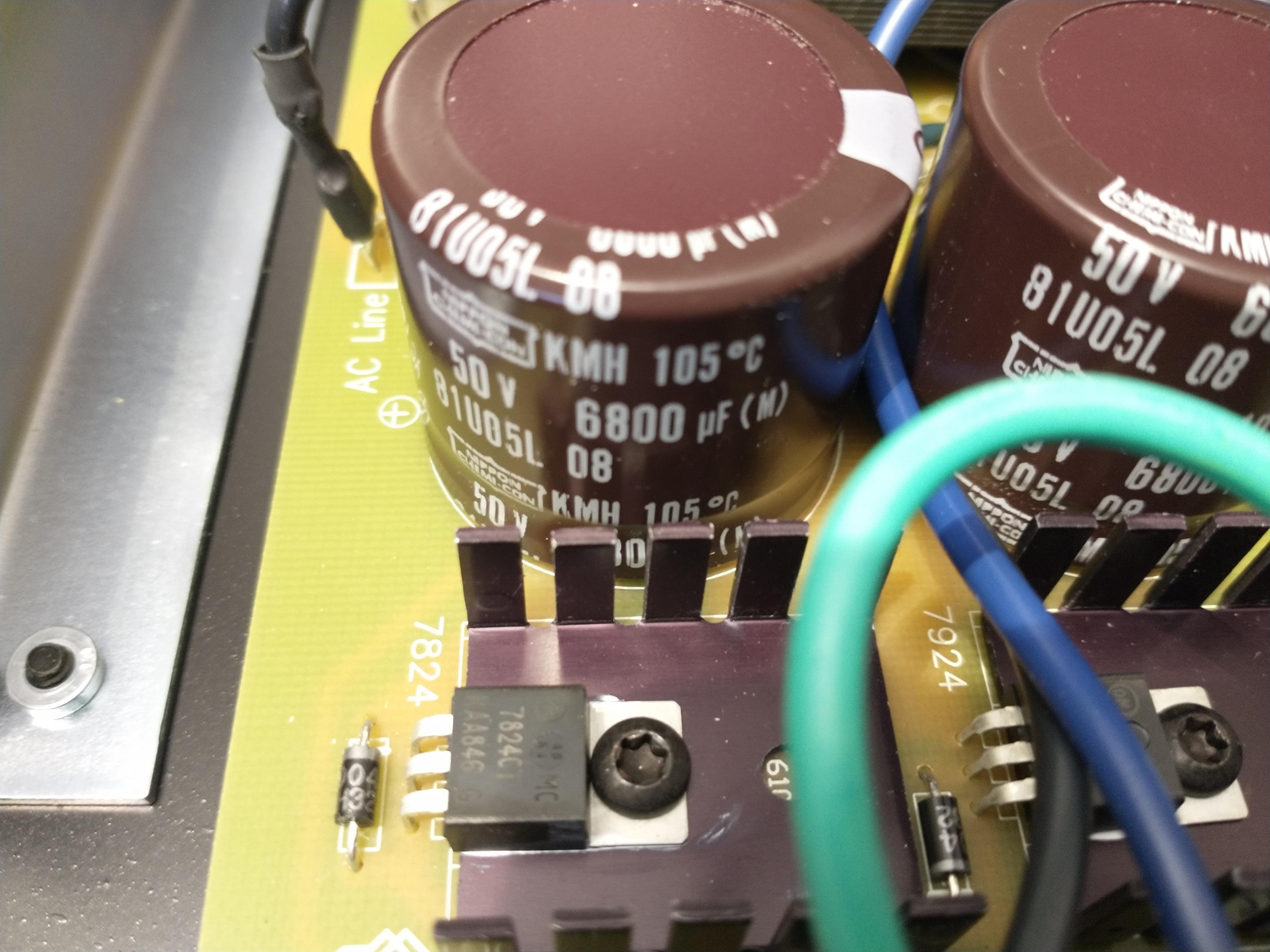

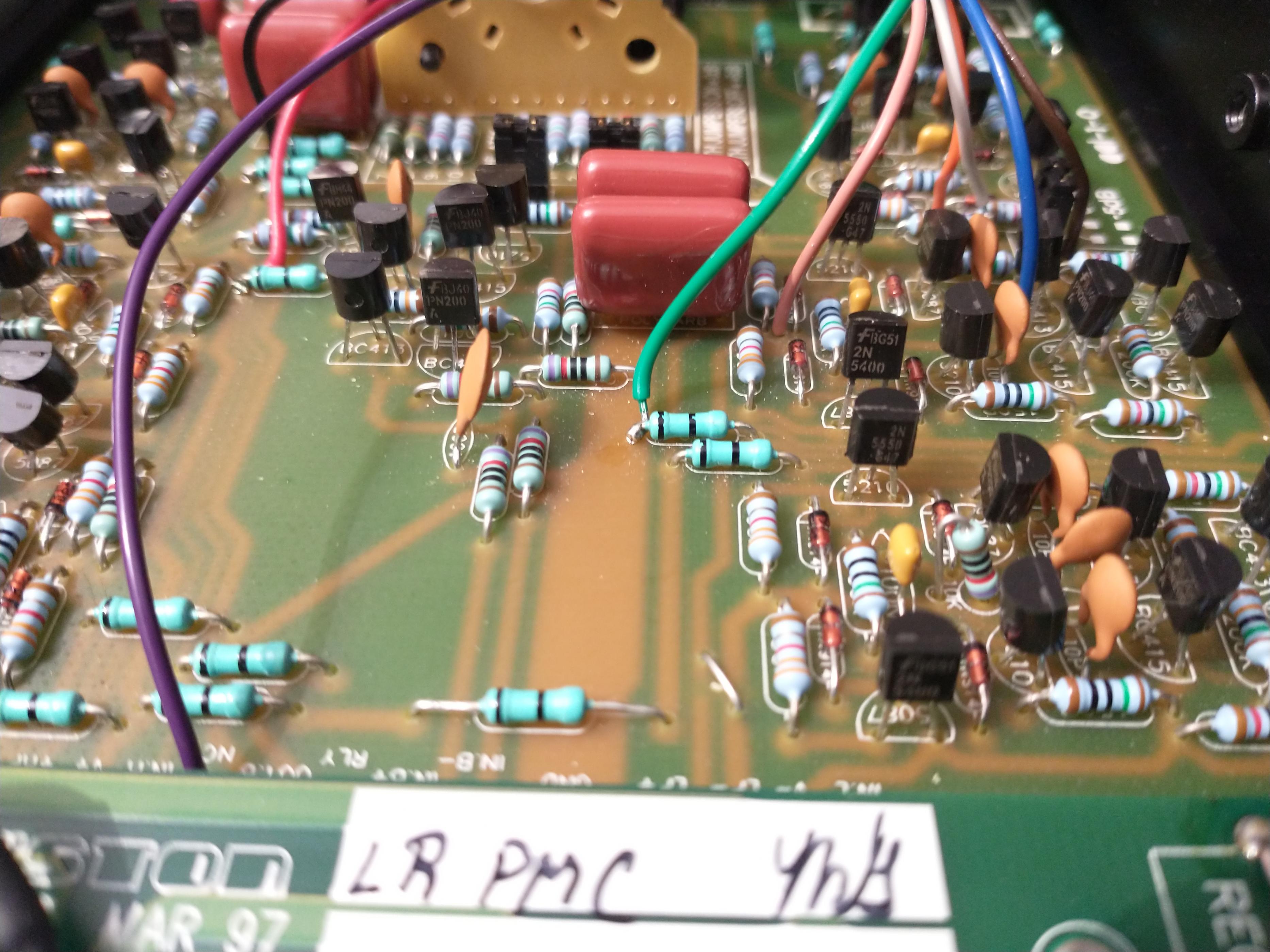

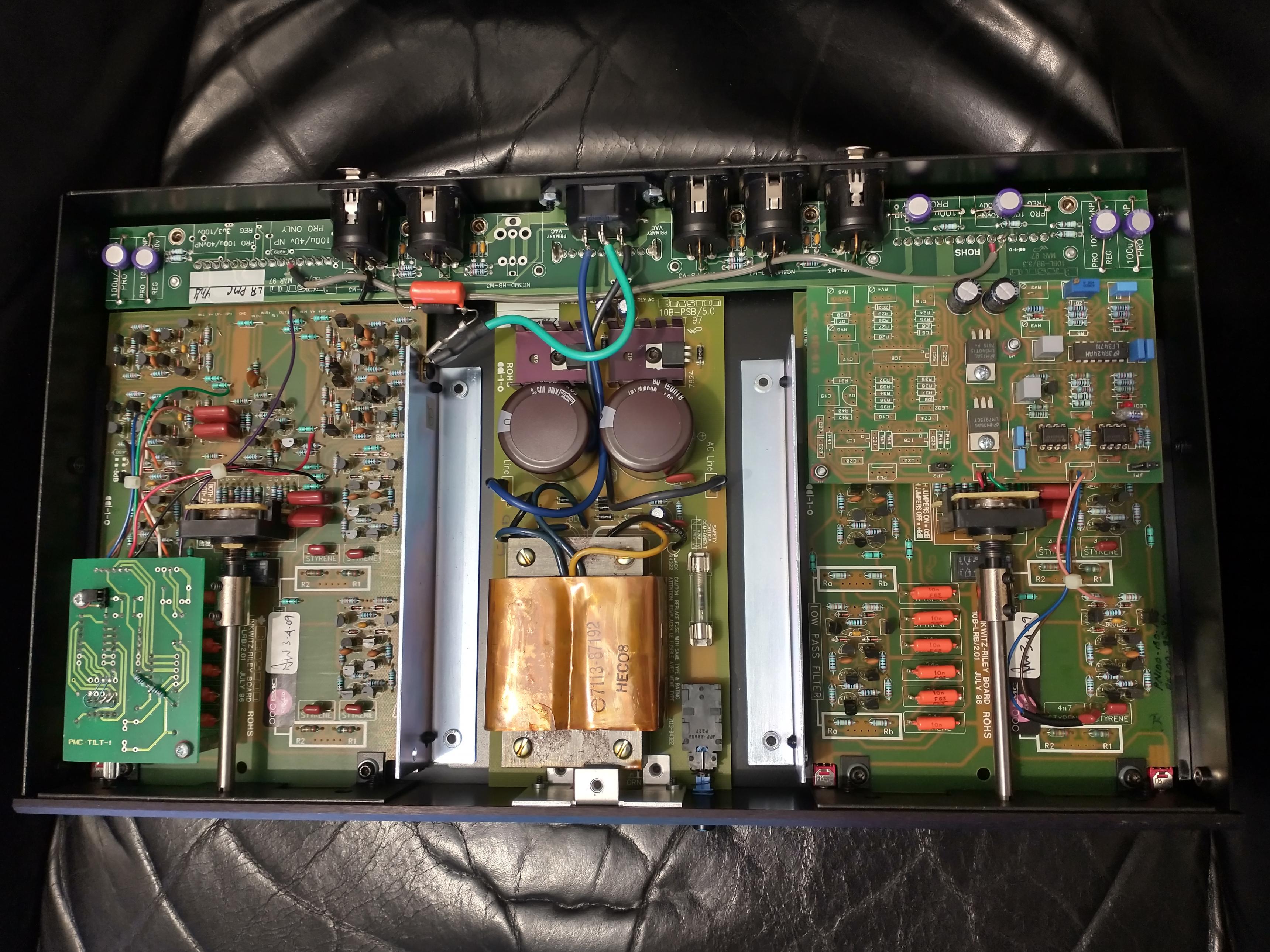

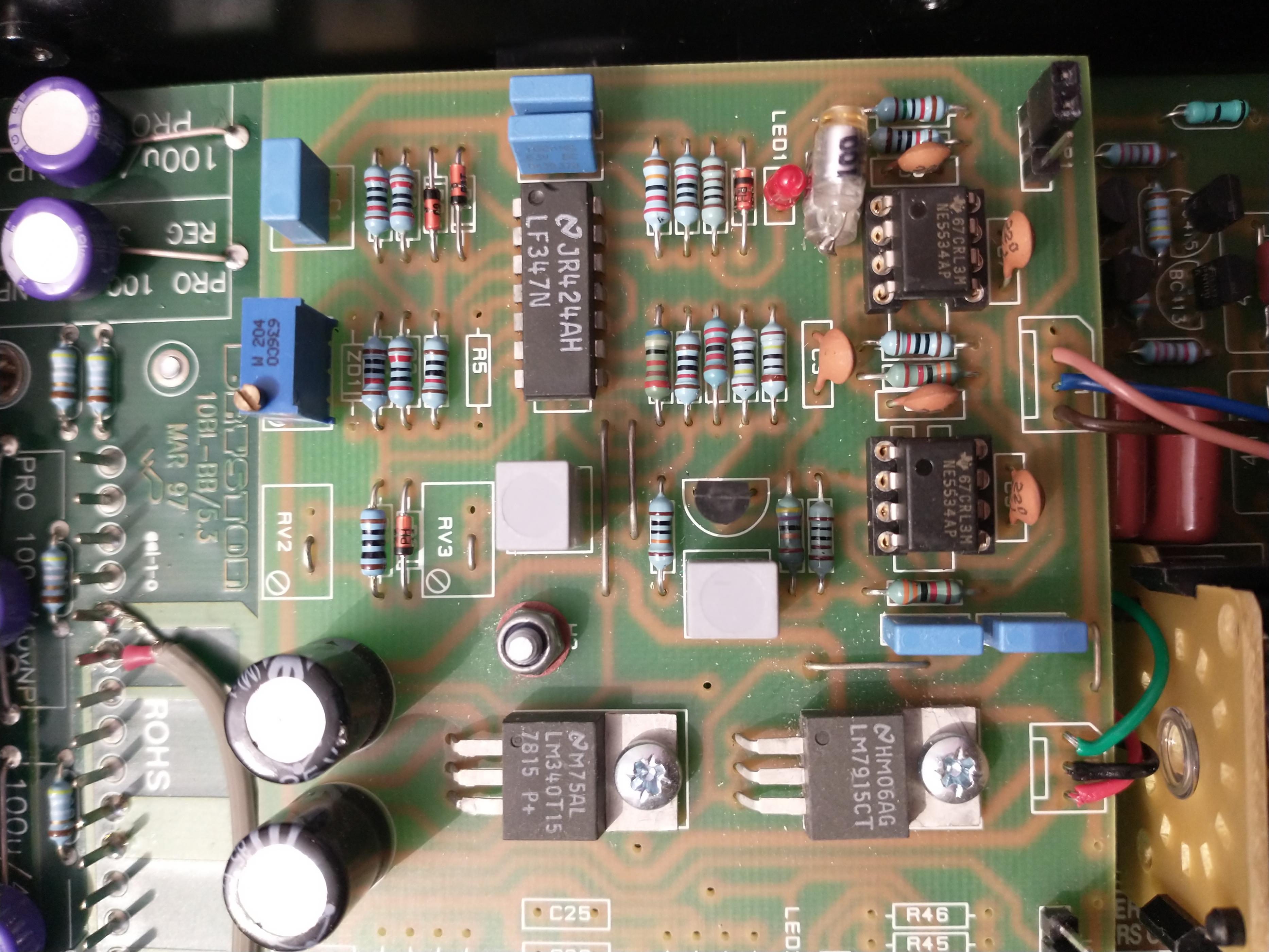

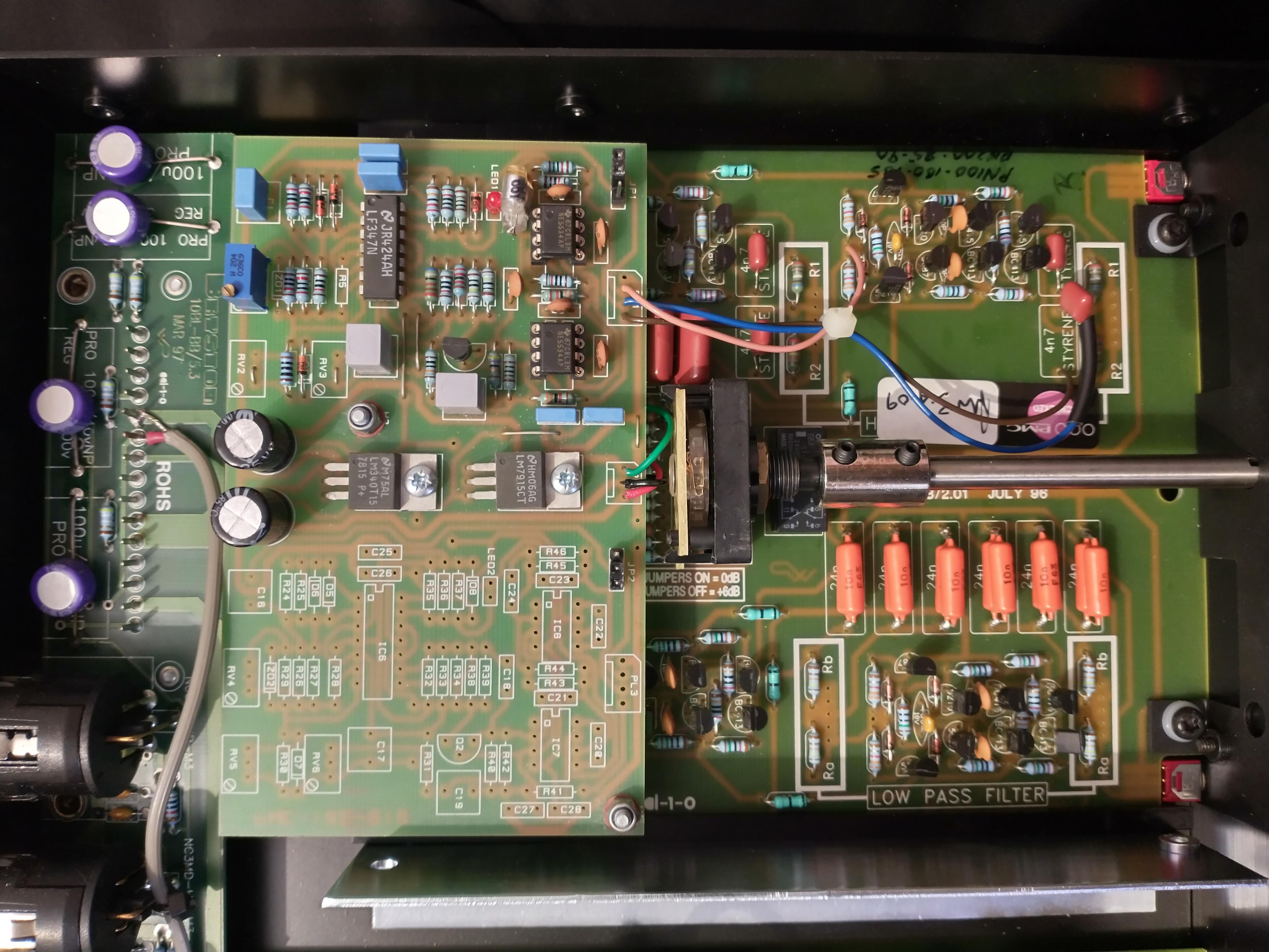

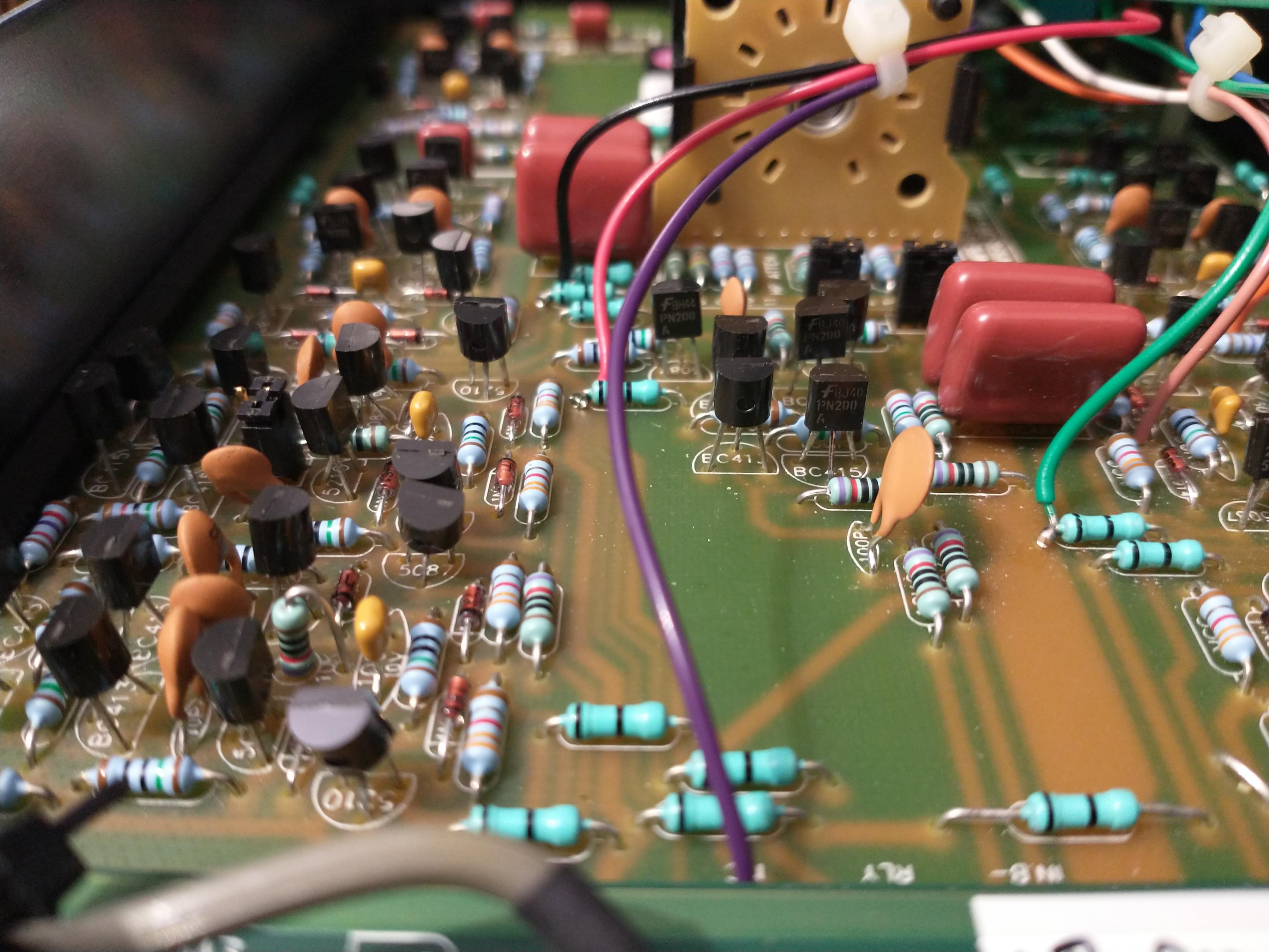

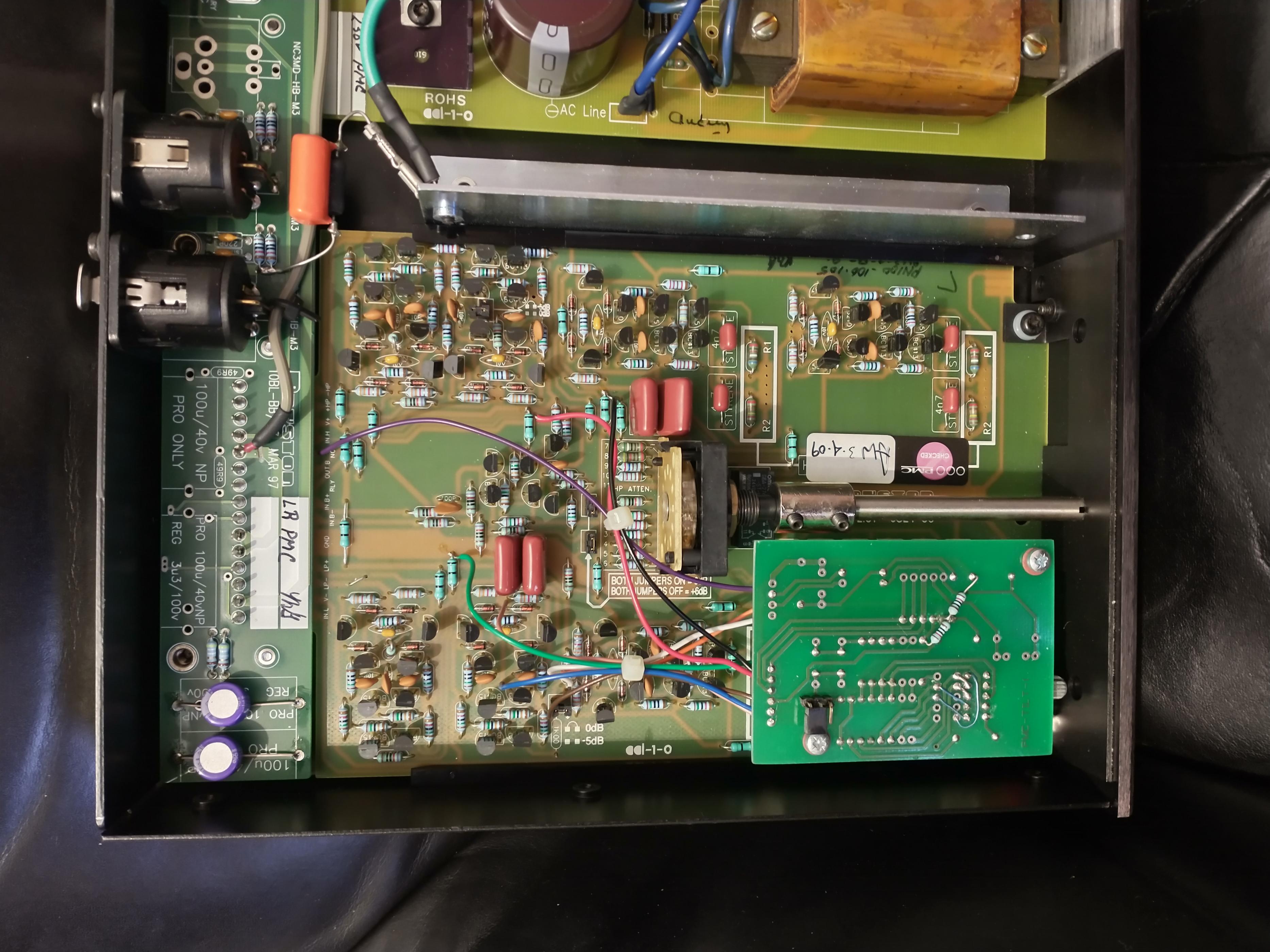

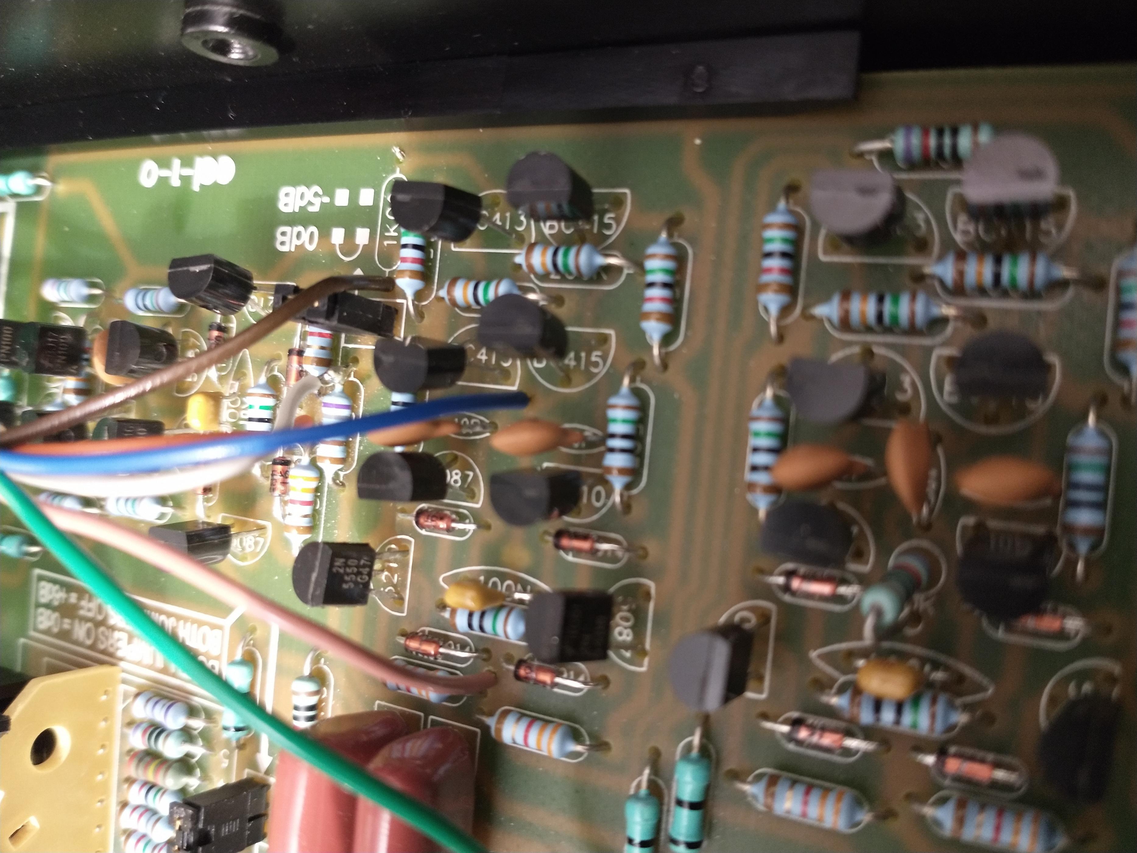

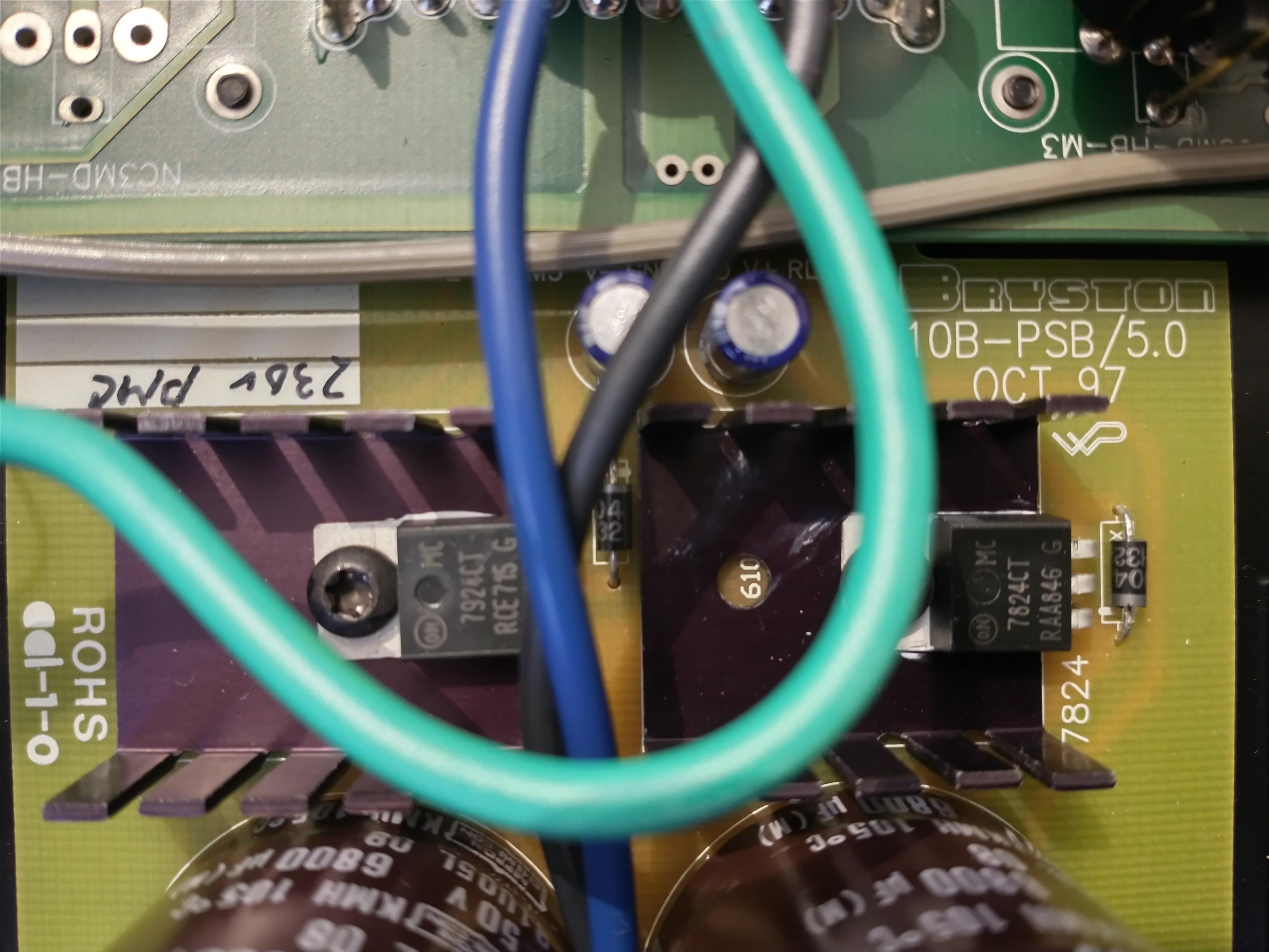

I'll upload pictures later, but I've written down all the semiconductors used in the PMC 10B.
The structure is as follows:
the basic structure of the stereo 10B is that it has a main power supply and then two large boards, marked L and R, which are used in parallel for the left and right channel. They have the same discrete filter structure built up 9 times on each board using transistors I list below, as well as ceramic capacitors, and some styrene capacitors as well.
This is then repurposed as stage 1 and 2 in the "LR" version which is put in "Three Way Mono" mode.
The "R" board has a small daughterboard on top which has its own power regulation and some op amps.
The "L" board has a small daughterboard with a discrete filter module which itself is an even smaller daughterboard again, and this is the only thing using SMD.

Voltage regulators:
Main:
(ON) MC
7824CT
RAA846 G
(ON) MC
7924CT
RCE715 G
Daughter board:
(N) HM06AG
LM7915CT
(N)M75AL
LM340T15
7815 P+
Transistors:
(f)BJ16
PN100
A
(f)BJ17
PN100
A
(f)BJ40
PN200
A
(f)BH44
PN200
A
(f)BG51
2N
5400
(no marked logo)
2N
5550
-G47
SMD transistors on discrete filter module:
3M D
2Q 4
N1A 3
N2A 3

I seriously doubt that the regulators are at fault, or would be the source of the noise in the outputs. With the setup as described there is possibly ~20dB too much gain. The output noise is rated at -90db but then you are adding ~30dB of gain in the amplifiers, bringing the noise floor up to just -60dB or so - you'd have to be deaf not to hear some noise.
The gain structure should be optimised before you start looking for faults. The Bryston 10B has a number of internal links for optimising gain structure; not sure about the PMC version. Even then you still need to pad the amplifier inputs.

OK, so looking at the datasheets for the 7824C and 7924C (attached), I see the following specs:
7824C (+24V regulator):
Ripple rejection: 54 dB
Output noise 10 Hz...100 kHz: 10 uV/V_O (which I take to mean 240 uV at 24V)
7924C (-24V regulator):
Ripple rejection: 56 dB
Output noise 10 Hz...100 kHz: 170 uV at 24V (it's specified as a total unlike 7824C)
That's 410 uV / 48V = -101.3691543923506 dB.
That's only 12 dB less than the stated noise of -90dB. If every stage in the filter (8 transistors) just adds that amount of noise (my guess is it might be more) then just the 9 stages the HF goes through should easily hit -90dB noise. Would you agree with this?
One problem here is that there don't seem to be 24V 1A regulators with less than that amount of noise. There only seems to be this regulator from ON Semi and then the BA178 from ROHM which is 170 uV, which isn't that much better. What does one do to get lower noise on the voltage rails? I mean there are loads of devices there that are beyond the -90 dB or -102 dB barrier...
On the other hand, again exploring your gain staging suggestion, in a normal signal, the treble (which is the culprit here) will be anywhere near -50..-40 dB. So if I'm listening at -30 dB, then HF is at -80..-70 dB, which makes it noticeably close to -90 dB. So you're right that it's a good idea to stage the gain a little better. But I'd still like to explore whether it's possible to make the 10B's inherent noise lower.
Regarding padding. You mention internal links in the Bryston 10B. Where can I find them? How do I set them? Thanks.
The schematics mention jumpers - they're already in the lower output setting on my units - is that what you meant by internal links? Thanks.
The output noise level from the regulators is not directly related to the noise level of the circuit that is supplied by those regulators; it depends on the circuit design. Typically a competently designed circuit will have ~60-100dB of rejection of power supply noise.
Also the amplifiers do not have more headroom than the crossover, they actually have much less. At an output of 0dBv the 10B has 26dB or more headroom but at 0dBv input the amplifiers have 0dB or 6dB of headroom depending on the input sensitivity setting. With a 20dB pad on the input of the amplifiers, it becomes 20dB or 26dB of headroom for a 0dBv input, which THEN more closely matches the headroom of the 10B.
images inside 1
or go to PMC Bryston 10B Linkwitz-Riley Crossover Noise Issue + Inside/Teardown - Album on Imgur
