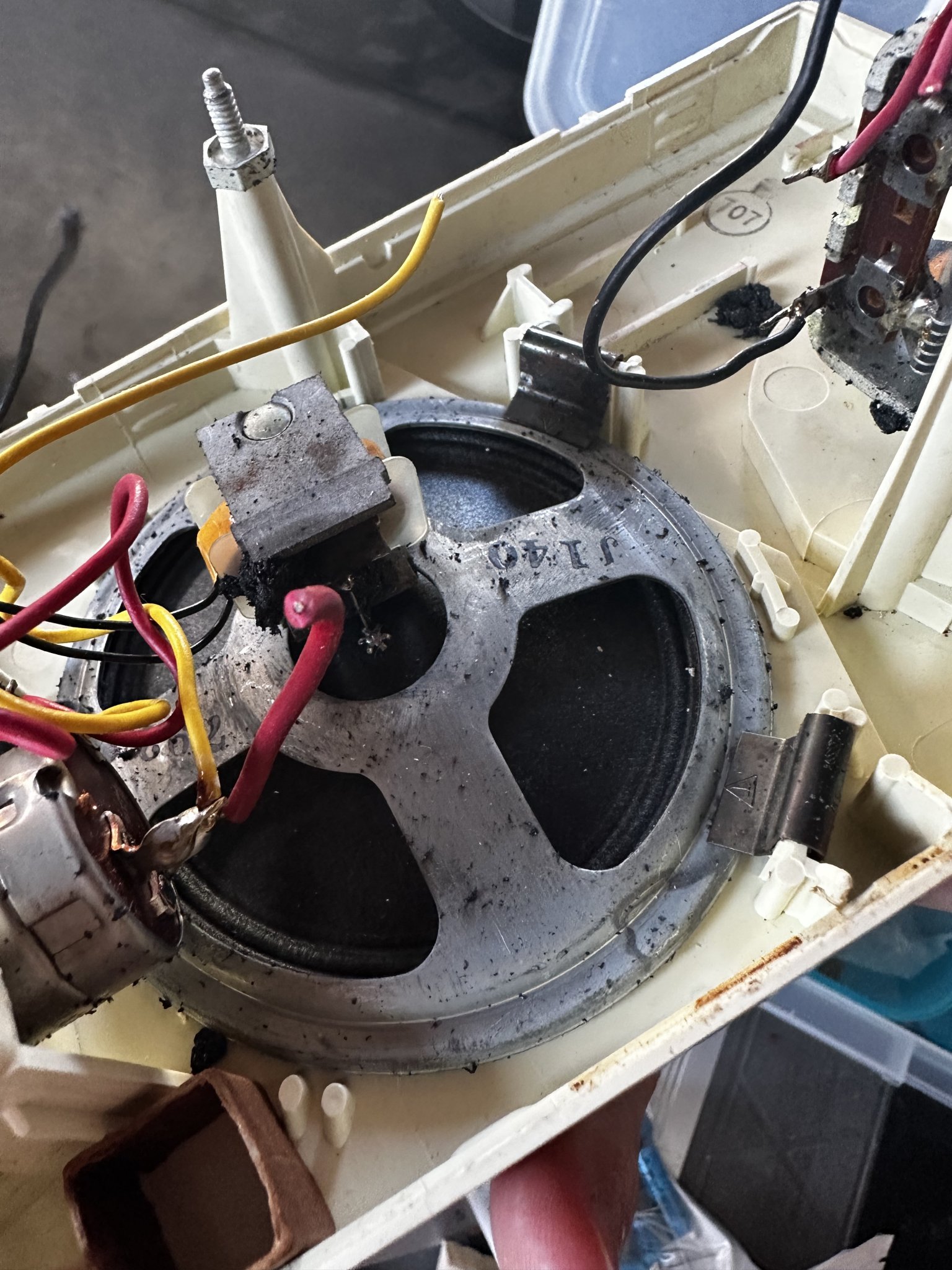

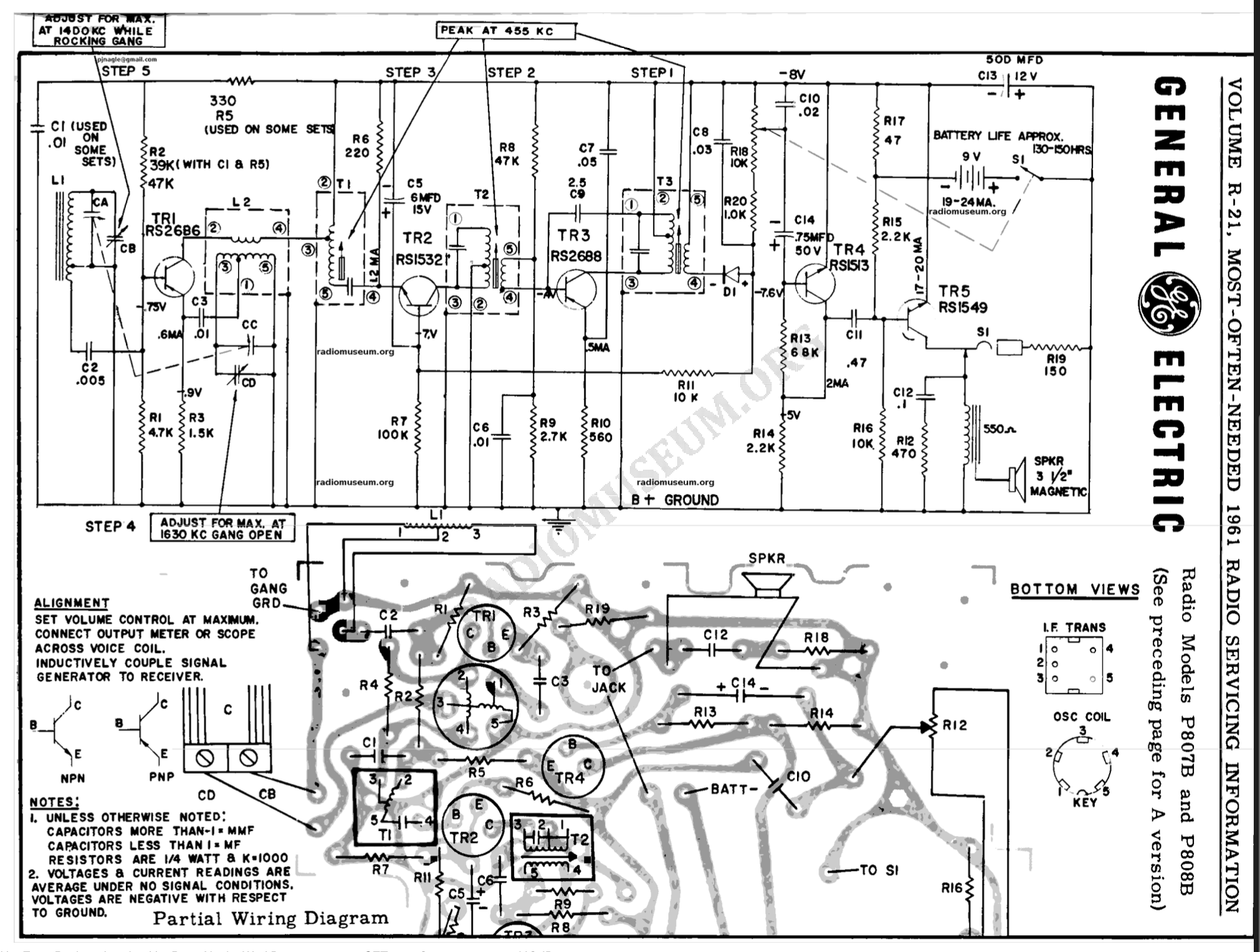

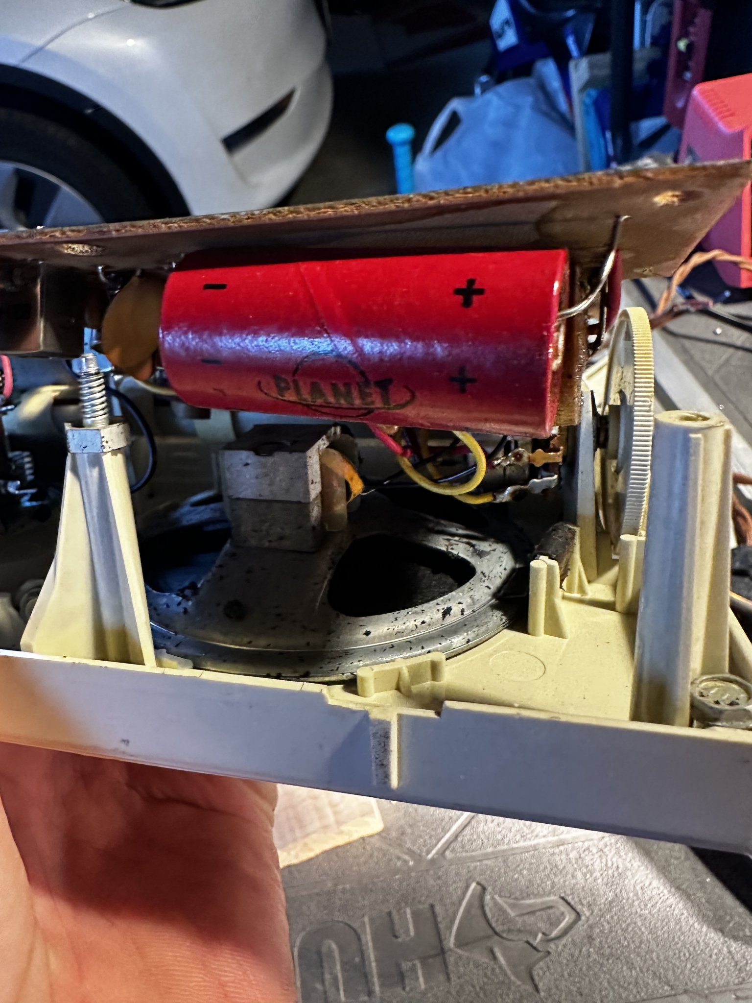

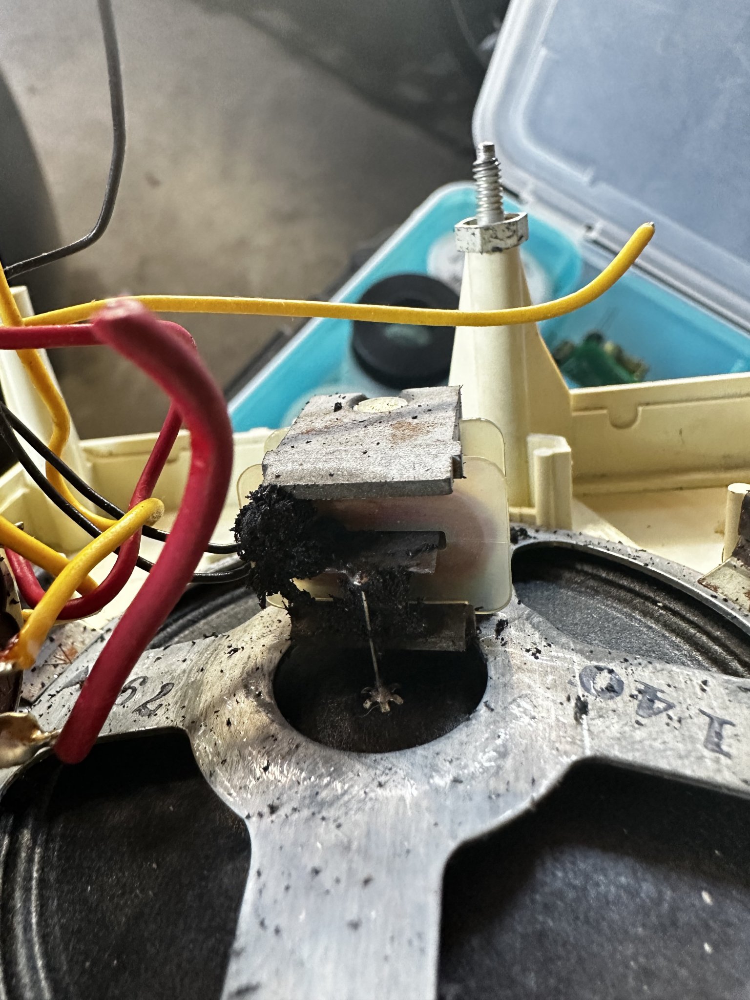

I haven't tried it yet, because I'm still waiting on a few parts for the amp (ran out of capacitors). Here's a picture of the speaker, still in the radio. The schematic for the radio is here:
a reed-type speaker
The point of G.E.'s reed speakers was that they were VERY efficient and would make decent sound on very small amplifiers.
I am sure you will get "some" sound. Enough to hear across the room.
FWIW: I have a reed in my ear. So do many stage musicians. The balanced armature (reed) earpiece is used in all good hearing-aids and most in-ear monitors. Yes, it has severe limitations compared to voice-coil drivers but within limits makes 5X to 10X the sound power per electrical milliwatt. OTOH it is fussy about alignment and may not have aged well.
