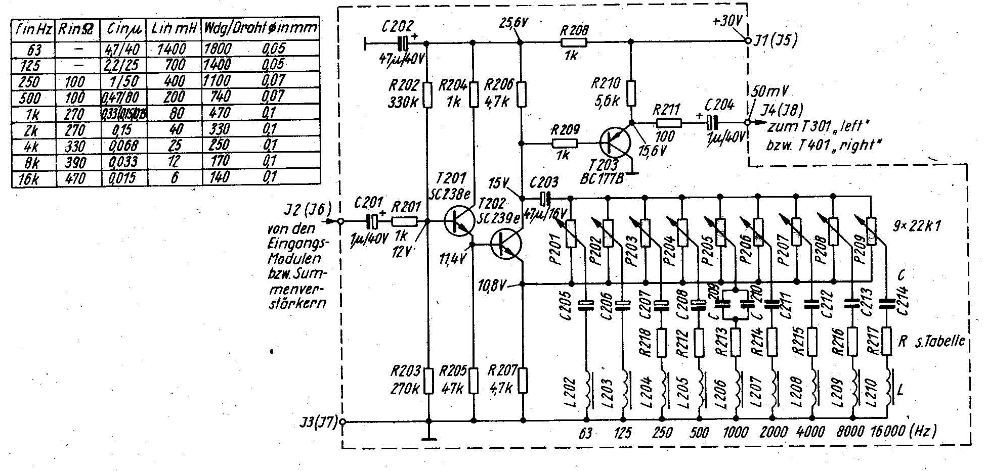

Thank you for considering all of that.
Meanwhile, back to this:
The entire middle section, with what appears to be 6 channels, looks extremely easy since you just make 1 and then 5 copies, with, apparently minor filter variations. So, most of what fills that box is not frightening, not complicated, not difficult and not expensive at all.
It does have a couple of frights though, the three boards at far left, three boards at far right and large collection of the most expensive controls. . . have got me bluffed a bit. Can those areas be done at reduced complexity and costs?
![fd1718b4-1.jpg](https://i277.photobucket.com/albums/kk71/zzxzzy/File%20from%20Oct%2026%202010/fd1718b4-1.jpg)
Well, there are a lot of around USD each J-Fets used in the discrete circuitry. It gets expensive quick...
I have reason to believe that the circuit is BROADLY (not exactly) related to Project 75 on the ESP Site. Generally this kind of design is an (IMNSHO unnecessary) Op-Amp-Grave with little actual benefit (performance or other) over different structures with much greater simplicity.
Well, that depends on what you want.

It seems that we've successfully narrowed the options down to 2:
Nite3d and East German EQ.
Meanwhile, back to this thing:
![273858d1332735474-high-end-tone-control-minimal-eq.jpg](https://www.diyaudio.com/forums/attachments/analog-line-level/273858d1332735474-high-end-tone-control-minimal-eq.jpg)
Now, on the East German EQ, I really like the 3 simple transistors and the simplicity of the passive circuits as well. The inductors have me bluffed but I think that a quick briefing on where to buy them or what to do for them would succeed.
On the Nite3d is where I'd like to see some Class A bias. One wouldn't want to crank up the air control with crossover distortion present. I don't really care what sort of op-amp's you'd pick for this, but discrete might be and stay more specific.
Which one of the remaining two options do you like the best for the new 6 band tone amp, East German EQ or Nite3d?
