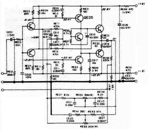

In my personal view the benefits argue strongly for the inclusion of tone controls in a true HiFi System and I would contend that the negatives that are often listed, while real, can be addressed.
The "quintessential modern" tone control, found in almost all references looks like this:
Headwize said:An externally hosted image should be here but it was not working when we last tested it.
The Tone Stack is a classic active Baxandall. which has the benefit that it can use linear law and hence easily obtained potentiometers, that it is flat in the center position and is calculated without much work. These benefits have made it essentially the completely ubiquitous solution for tone controls in consumer equipment...
The issues that this circuit has low and variable input impedance and inverts polarity is addressed by adding an inverting unity gain buffer in the example. In other cases the polarity inversion is ignored and only the tone control circuit is looped in following a low impedance stage. This can be seen in the schematic of the Adcom GFP-565:
Adcom said:An externally hosted image should be here but it was not working when we last tested it.
The practice of ignoring the polarity inversion of this circuit may raise some eyebrows, the tradeoff is the need to add another stage or to live with the polarity inversion if the tone controls are used. Neither option seems ideal, but life is full compromises and TANSTAAFL...
Such a circuit as in in the example may be inserted either between source selection and volume control (which may lead to issues with overload margins, but minimises additional noise or after an active preamp stage as seen in above's Adcom example with or without buffer.
Noise needs to be watched, in the above example the two 100K resistors in the buffer stage will produce around -108dBV Johnson noise and if the Op-Amp has significant current noise on the input (e.g. is not a Fet Input Type) the noise may be much higher, on the other hand if we lower the resistors to 10K (giving -118dBV noise) we increase the loading onto the circuit driving the buffer and conceivably reduce the preceding circuits linearity.
The same also goes for the Tone Control circuit itself, if we have too high impedances in the tone control noise will increase yet if we lower the impedances too much, linearity will be compromised.
On a positive note, this kind of circuit can also be extended with additional controls and IN PRINCIPLE at least could be extended enough to offer similar adjustments as the (in)Famous Cello Palette.

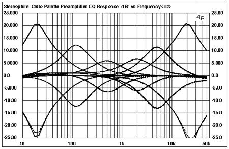

The Cello Palette is IMNSHO among the better solutions to problem or a program "re-equaliser" for non-sound engineers (compared to classic graphic EQ's or Parametric EQ's which likely get nods of approval from fellow sound engineers).
Even a numbers of Studio's prefer using the Palette over other equalisers, I suspect mainly because of the very intuitive way it is operated. Above it can be seen in the setup used by Wilma Cozart Fine for re-mastring the Mercury "Living Presence" Tapes and Films for release on CD and SACD.
The linked article at Headwize contains all the math needed and for example Tina-Ti, the free simulator from Texas Instruments may be used to simulate such a system, it already contains a tone control as shown above to get started. Stereophile measured the Palette Preamplifier and hence the curves are available to be implemented in a "DIY Palette":
Stereophile said:
The exercise to produce the schematic for an "Active Baxandall" Palette is left to the Reader, it'd be trivial enough.

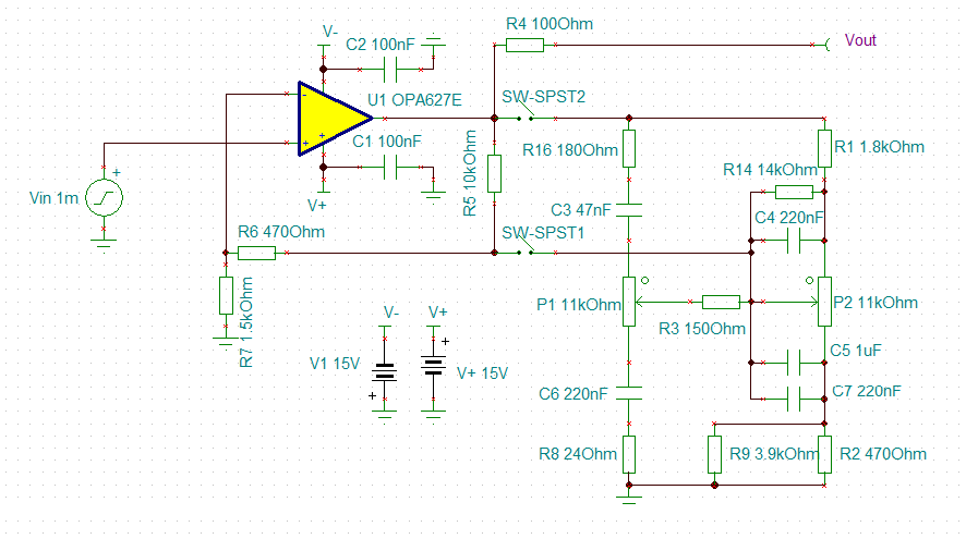

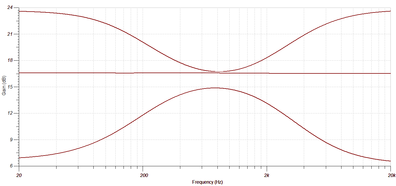

This is basically a classic graphic EQ circuit. Instead of op-amp gyrators they can also be made with single transistors or J-Fets (or even tubes) and real inductors are also an option.
The Main Op-Amp can be discrete. While non-inverting the input impedance is also quite low, so many of the issues remain and it is STILL an addition.
It is even possible to use this kind of circuit with what would look nominally like a Concertina Tube Phase Splitter (unity gain) to make a completely Tube based, minimalist EQ.
I'm undecided if this is better than a multi-way parallel Baxandall, at 6 Ways Palette style at least, which also comes in "tube". Maybe.
There comes a point where it is clearly one of the ways to go though...
Ciao T

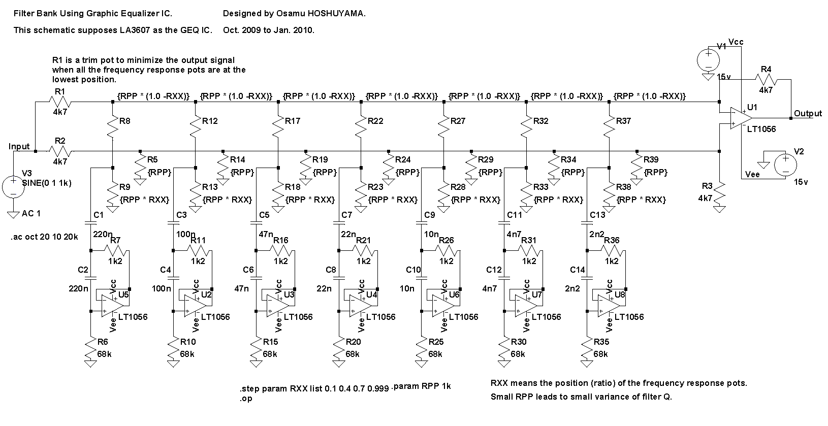

I was wondering what took you so long. 😉
How would you rate this one ?
It is easy enough to change the buffer to discrete.

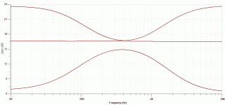

Ciao T
The Baxandall has a buffer stage upfront.
Doing the same will solve the input impedance issues.
The Hoshuyama needs a lot more active devices, which is arguably a disadvantage.

Okay, here is one scheme that delivers the following:
It is in essence the combination of a standard line stage and a passive Baxandall/James tone stack in the feedback loop.
This used to be quite common and was found among others in the Marshall Leach preamplifier from 1979, certain GAS designs and various Hafler preamplifiers and it was widely used by the Japanese electronics industry.
I have attached both the schematic (from Tina Ti) and the frequency response for the pots centred as well at max boost/cut. This example is based on an extract out of a Luxman pre finetuned to suit my precise application and stock of parts...
It requires "C-Law" (aka anti-log) potentiometers if potentiometers are used. These are nowadays hard to get, I lucked into a few very nice quality ones (above Alps Blue) so this is what I will use. It also has a slightly asymmetric adjustment response, there is a dB or so more cut than boost.
This is a result of optimising the circuit for parts I have and for minimal gain changes and maximal gain flatness when switching the tone control set to flat and switched in and out.
The adjustment range is +6.5dB / -7.5dB @ 50Hz and +7dB / -7.5dB @ 10KHz, which is enough for some fine adjustment of tonal balance.
The gain circuit shown as OPA627 can be any sort of Op-Amp with enough open loop gain, John Curls JC-2 linestage could for example be used, or any nice discrete Op-Amp you have in mind for line stage duties, Fet Input should be seriously considered.
- No effect on the audio circuit when defeated
- Minimal added circuitry
- Minimal effect of tone control circuitry on fidelity when engaged
