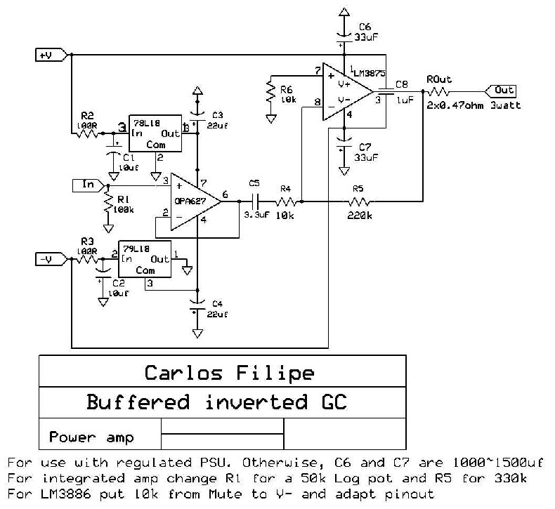

Just one question
Have still one question about the tube buffer.
I want to regulated the supply of it to.
Think the LM317 will do the job, or do some of you have
a better idea?
a better idea?
You can use the LM317.
But then, you'll need a transformer at around 2x27~2x30v, because you're regulating at 35v for the buffer.

So if I go dual mono, with two regs per channel (one for plus and one for minus), how much current must each of the four regulators be able to handle?
3.4 amps divided by 4?
jackinnj said:
I(pk) with 31 V rails wll be 3.4 Amps according to the National Semi interactive chipamp tool. http://www.national.com/appinfo/audio/files/Overture_Design_Guide14.xls
At best this will cause the regulators to shutdown, at worst, it will blow your regulators.
There is no need for regulating the chipamp power supply.
Re: Re: Re: question about circuit for rvbnigc
Each mono-channel is going to draw 3.4 amps, peak, into an 8 ohm load. If your load is lower impedance (which it usually is in real life) the current will be greater. The math is all worked out for you in the form of an Excel spreadsheet on Nat Semi's website.

You're talking about absolute maximum current and this is not a class A amp, an music is not a continuous tone!
The LM338 handles 12A absolute maximum, enough for two LM3875 or LM3886 chips, and MUCH better than with an unregulated PSU with 1000uf per rail (the compromise this chips need to sound good).

BTW, looking at the data sheet, it seems the 338 is better than the 1086 in the higher freq range on ripple rejection and output resistance. 338 seems a good choice here, I didn't know the chip.
