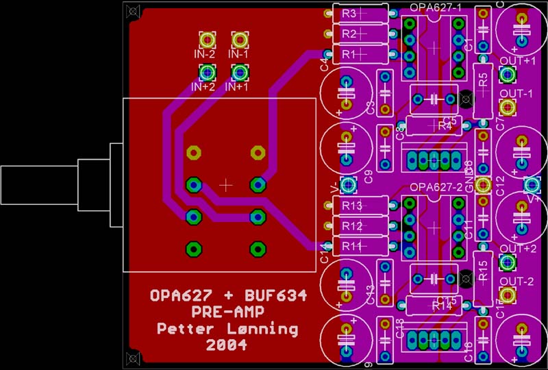

Hi Alcaid,
Some comments on your BUF pre,
This is probably splitting hairs but ideally the current charging
the main reservoir caps C11,12 should not be conveyed by tracks passing right underneath the opamp
If however you plan to do a copper pour on say the top layer connected to GND then you might get
away with routing only +15, -15 on the bottom layer below the opamp
This sed I still believe that you could gain from supplying power from the BUF's side of the board and
moving C11,12 to either side of the BUF so as not to increase the distance between the opamp and the BUF
I hope this helped
Regards
I hope this helped
Regards

Don't know if I understood you correctly, or you understood me. The red layer is the top layer, and it is a groundplane. The blue is the bottom layer, and it only contains V+, V- and signal routing.
Hi Alcaid,
I was revering to the smaller version of the board without the pot
but I see that the final version is done quite differently and I can't spot any problems there.
Best of luck
Skilpad
Best of luck
Skilpad
