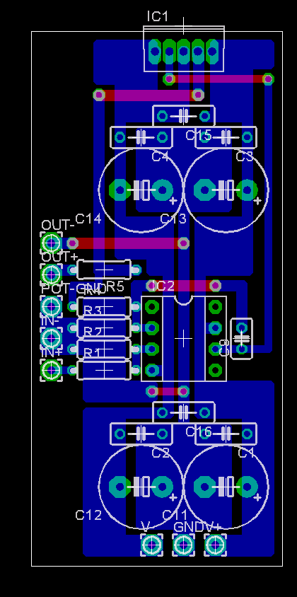

Any comments on my PCB?
I've made a PCB for a this preamp with the BUF634T at the end of the PCB so I can attach it to the cabinet which has heatsink-walls.
Any comments about the layout? Is the decoupling/coupling ok? I Intend to use 100nF ceramic and 100uF electrolytics (Panasonic FC). The red traces will be wire links.

Nice job, Alcaid.
I would like to comment a little bit. Keep the shortest distance between the BUF and the OpAmp. Probably you would like to use a groundplane.
The power dissipation of the BUF is not critical.

Just a suggestion and I may be wrong here, but if you use a cap across the supply pins of both IC's, you should be OK with just one set of electrolytics for both chips.
You could then remove the caps between the two IC's and move them even closer together.

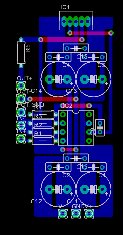

Alcaid said:I managed to shrink the distance a bit. Are they close enough? Will I get any problems like oscillation? (hard to answer, I know)
As Nuuk has said, you can move electrolytes. For bypassing reasons, the ceramics are important. I do not suppose the oscillation problem, but it is customary to keep the shortest distance between the BUF and the OA, just to minimalize signal and feedback tracks. Then you'll get lowest distortion, best RFI imunity and low stray capacitances.
