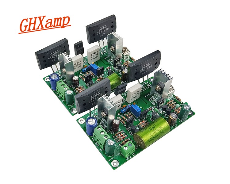

Indeed, some Chip Amps may be good options but your rails appear to be a bit too high. You may experience problems with heat transfer too. You may use this Chinese variant of The Blameless (see the image below). I have measured it and it appears to be fine for such power supply. It has low heat dissipation. Distortion is low and frequency response is fine. It is almost verbatim copy of The Blameless with all transistors still available from trustworthy suppliers, if you want to be sure everything is fine.
Good luck.

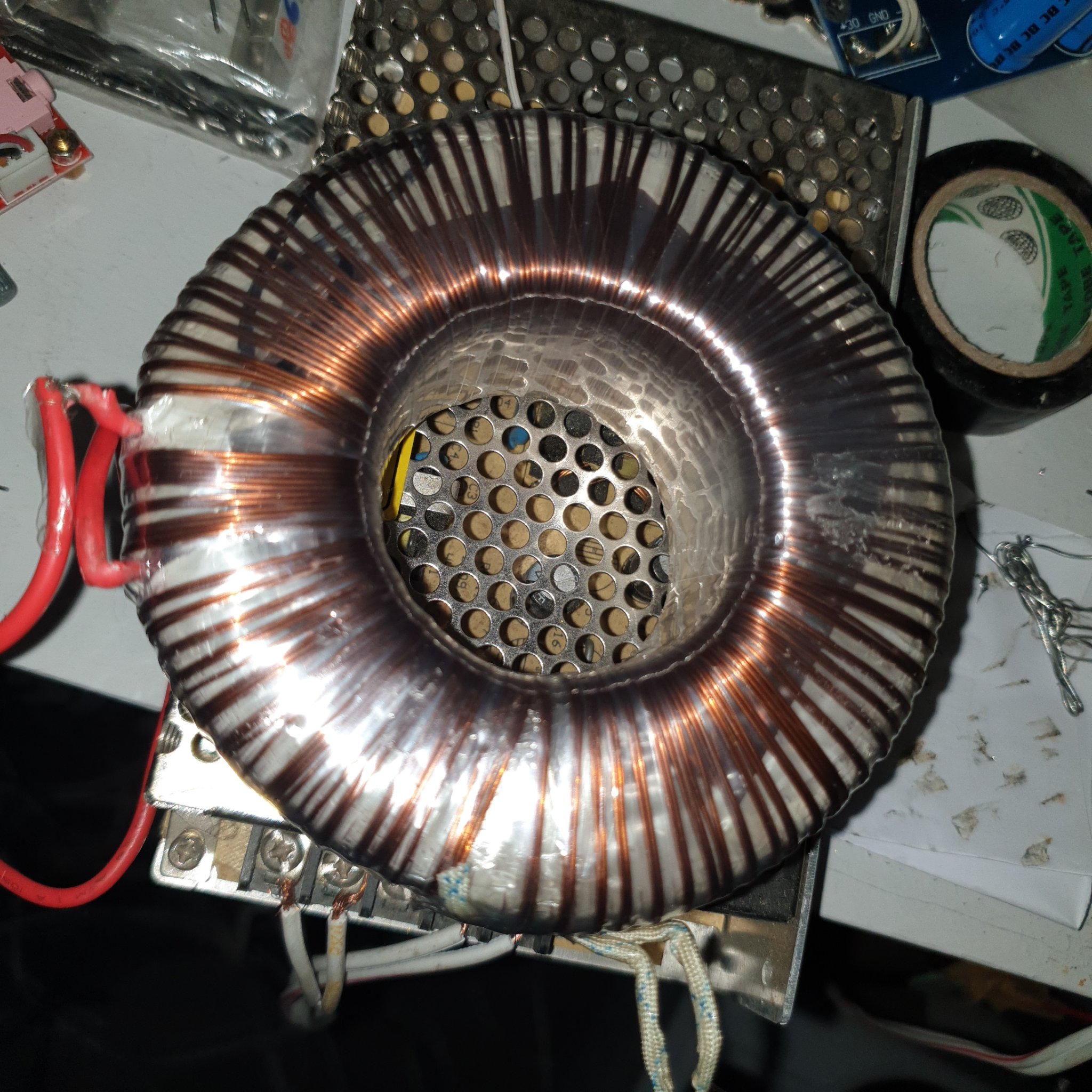

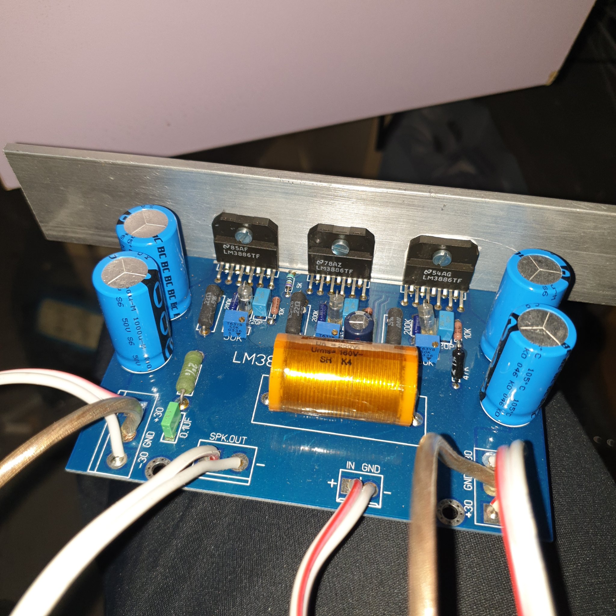

Hi. I already bought these blameless clones and waiting seller to ship since Sunday. He marked as shipped today but no tracking info yet. I will make 2-3 amplifiers including Tda2050 utc ( i can supply it cheap here ) Lm3886 paralelled which i bought many years ago.And blameless amp. I found 2-3 more transformers. I should rewind toroidal one and I will make case for all.

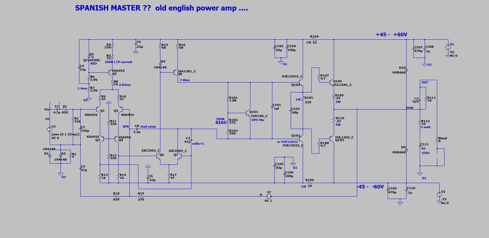

Here is a nice simple one .... .01% 20Khz/8R . not bad for 1980 type designs.
A lot of english companies used this to power Hitachi lateral MOSFET output stages. Works swell with a standard EF2 !
The THD this does have is H2 dominant. Cute amp.
