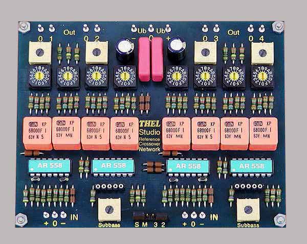

So I set up an excel sheet to easily calculate voltage levels of the filter outputs given the sensitivities of the drivers. Setting up the filters with the obtained results was 10 minutes work. It turned out that bass was too loud (had to be reduced as well as treble).
That done, the whole picture fell into place. Bass had disappeared, treble was no longer there, no more midranges. Just music. I lost track of time that night. CD after CD disappeared in the drawer of the player and every time I was staggered what information was hidden on my CD's. Information I never heard before. I thought I knew my CD collection, but I can start over again to discover what's hidden on all those discs. Amazing.

Sorry, I think I was a bit short on additional information here.
The THEL filter is adjustable with 16-position DIP switches. With these switches, the user selects a resistor value from a resistor bank which, combined with the value of the capacitor, will give a certain roll off frequency. Since this is a 4th order filter, there are 4 DIP switches and 4 C's per channel.
This set-up works more accurately than a multi-potmeter setup, where there is always a difference of resistance values between the potmeters.
Drawback of only 16 preselectable frequencies is, that either the range is large and the selectability is very coarse, or vice versa. THEL sets up their filters with a 2-3 octave range to have sufficient selectivity. With a set of C's, a specific range can be selected.
Left column is switch setting, column right of that is the resistor value that is configured with that switch setting. Top row is the chosen capacitor value. At the moment I have 47 nF in my filters, and I ordered 15 nF.

The C2-90 starts to seriously distort below 200 Hz. In order to have sufficient attenuation at 200 Hz, a crossover frequency of approx. one octave higher is recommendable. (400 Hz crossover would mean a -24 dB output at 200 Hz for the C2-90) I estimate that currently the level at 200 Hz is approximately -8 dB.
Furthermore, putting the C2-90 in a closed box enclosure of 3-4 litres will cause the C2-90 to gently roll off below 300Hz, causing a slight dip (+/- -1dB) in total response.
So... Mission not entirely accomplisched yet, but we're getting there. 😀
Yep. At least excursion is rising and therefore causing more 2nd harmonic. I just thought 450Hz is a bit high for a 7" midrange. I had C2-77 Accutons some time ago and they performed well with 250Hz 4th order highpass. That was adequate to kill the distorsion rise at lower frequences. At least up to 95dB SPL in anechoic room.
Jussi
Things really go pearshaped only below 100 Hz. 😎
So 257Hz is borderline OK from a distortion point of view. Also the C2-79 is slightly milder with distortion in the 100Hz-200Hz band, for some odd reason.
Anyway, I'm still going to insert these smaller caps, to have some more margin to play in, and to deal with the low-end roll-off of the C2-90.
