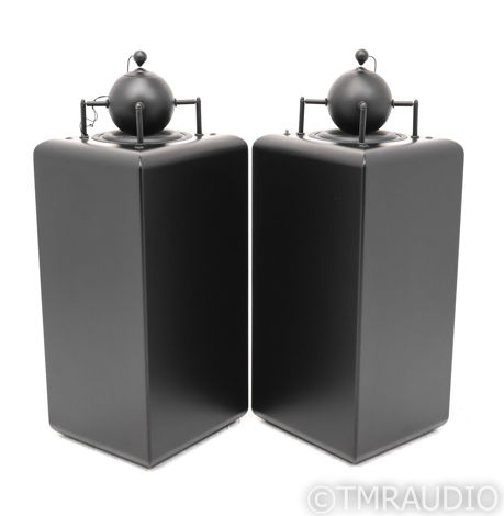

Funny you show this, I'm all the time thinking about an half sphere or b&w mid like enclosure since I read about the 0.5db baffle diffraction of spheres. My idea is to make it from concrete as it would reduce the cost.
You may be interested in the Morrison Audio 29 approach.
Morrison Audio 29
