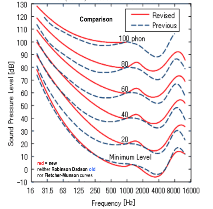

Efficiency or cone area makes no difference in perception at low SPL.
The equal loudness contour of your hearing response does make a difference in perception.
Most (young) people with average hearing can only start to hear 31.5Hz (Low B fundamental on a 5 string bass) at 60dB, 60dB more SPL than the minimum of audibility at 4000Hz, where hearing is most sensitive.
@weltersys wow ! thank you !
i had to google an article for a better understanding of this.
well, i see there are not really benefits of having high effecieny speakers, so i think i my new project will based on a question i had all the time.
narrow baffle 3 way. because all my speakers where more or less hugh bathtubes (150L+) in the past and i was always asking myself, what if .... if its narrow.
and at least it doesnt eat that space in the living room.
thx to all for your input, it was important to me to find a decision.

Where can I find the full document about "revised" equal-loudness curves?
Do you have a link to that article? I am interested in that same topic!i had to google an article for a better understanding of this

Thank you... I knew his issue was with the Hypex setup, and I was trying to remember the details. Then you posted...You have used the mode Auto detect in your Hypex Filter Designer. Page 6 of the HFD manual:
Efficiency or cone area makes no difference in perception at low SPL.what are the behavior of high effeciency speakers at really low spl ? are they performing better then speakers with, eg say 86db/1w ?
or is this effect also depending at the cone area ? more is better ?
No disagreement about the human piece/loudness contours, but was surprised to see that response from @weltersys w/ so much experience in HE. It's been my own experience that larger HE speakers (say 96 on up) still have some semblance of dynamics at low levels whereas the mid 8X dB stuff just sounds flat and dead. And I remember running the old '50's/'60's coaxes (Univ, EV, etc) that didn't need a bunch of juice to "come alive" (light moving masses, low power ratings) at low levels, too. They had other problems, but were quite different in that respect from more "modern" drivers now built to survive much more power. I don't claim to have the answers to those first two innocent sounding questions of the OP, I just think it's all more complicated. It doesn't take away from human preferences exactly analogous to food prefs and the OP might not like HE, I just think everything is worth auditioning and living-with for yourself for a while. FWIW.
