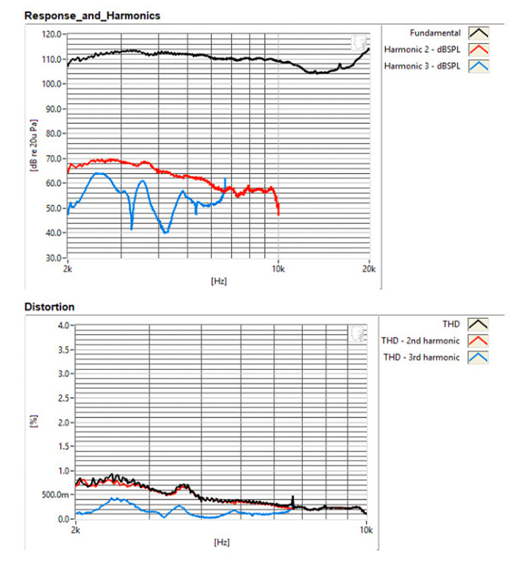

I have been a fan of Yevgeniy’s HIficompass website for sometime (donate if you can!) but, apart from the compression driver, no other has been taken to the 110dB level.
The T34A/B have a good chance, as well as the waveguided Satori- both of which was tested up to 108dB at 10KHz.
I might have to review the physics of whether it’s possible to even reach 110dB for a dome tweeter…
This is why I posted the audioxpress link. They do 110db.
Good luck with the hunt!
Thanks Headshake. The problem with Voice Coil is that sometimes the details are hidden in the text, but not in the legend of the graph. As Vance wrote:
"For the last objective test, I used a noise stimulus to set the 1 m SPL to 94 dB (3.20 V) and measured the second (red curve) and third (green curve) harmonic distortion at 10 cm (see Figure 9)."

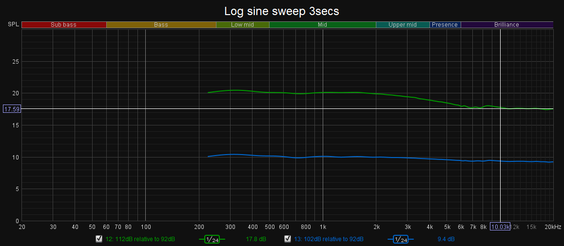

Upon investigating this further, my system CAN do 110dB@1m.
the dynamic compression is due to the measurement technique. REW does not use MLS for measurements; but log sine sweep, the length of which is adjustable from 128K samples all the way to 4M samples.
Using the 128 or 256K samples; sweeps are short and there is NO loss in output at the top octave.
I had the measurement set at 512K samples from my precious setting when measureing at 2.83V.
Do NOT use 1M+ samples for stress testing small transducers.
The test duration is very long (20+ seconds) of continuous power at 28.3V.
No dome tweeter is able that much heat- don’t let out the magic smoke.

This testing is part of QC testing to verify that my design meets modelling expectations. In this case I am looking to see if my HF or LF driver limits the useful output of my system; and when to apply the limiters to protect the drivers from misuse.
