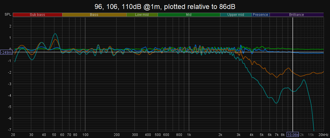

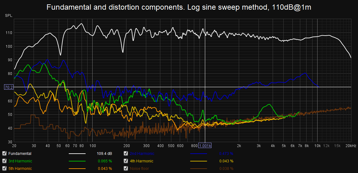

Upon investigating this further, my system CAN do 110dB@1m.

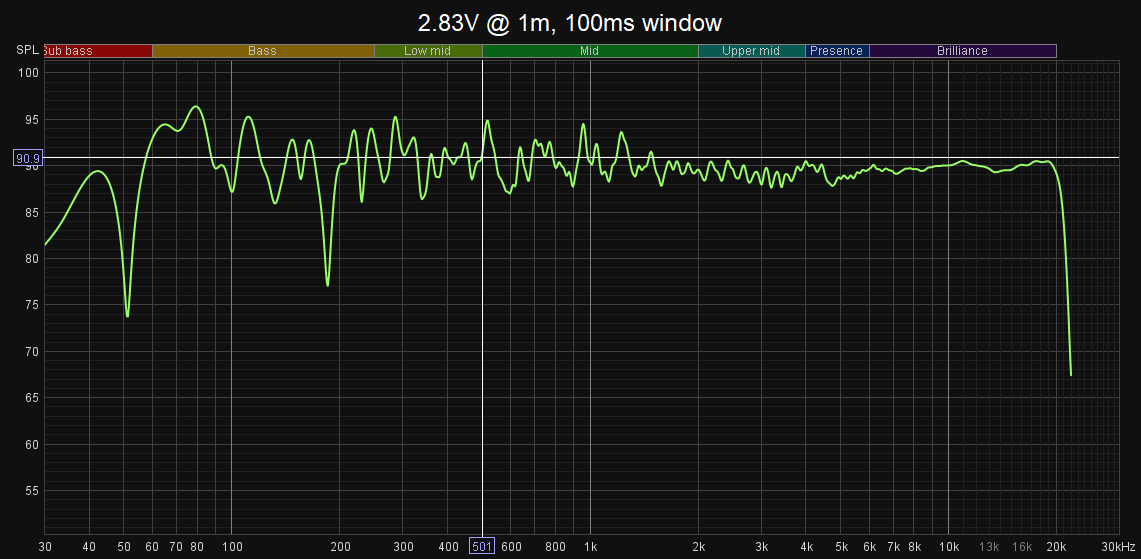

the dynamic compression is due to the measurement technique. REW does not use MLS for measurements; but log sine sweep, the length of which is adjustable from 128K samples all the way to 4M samples.
Using the 128 or 256K samples; sweeps are short and there is NO loss in output at the top octave.
I had the measurement set at 512K samples from my precious setting when measureing at 2.83V.
Do NOT use 1M+ samples for stress testing small transducers.
The test duration is very long (20+ seconds) of continuous power at 28.3V.
No dome tweeter is able that much heat- don’t let out the magic smoke.

That makes sense. When I saw your compression test comparisons in post # 14, I suspected there might be some measurement error, but I had no ideas on how you should proceed.
