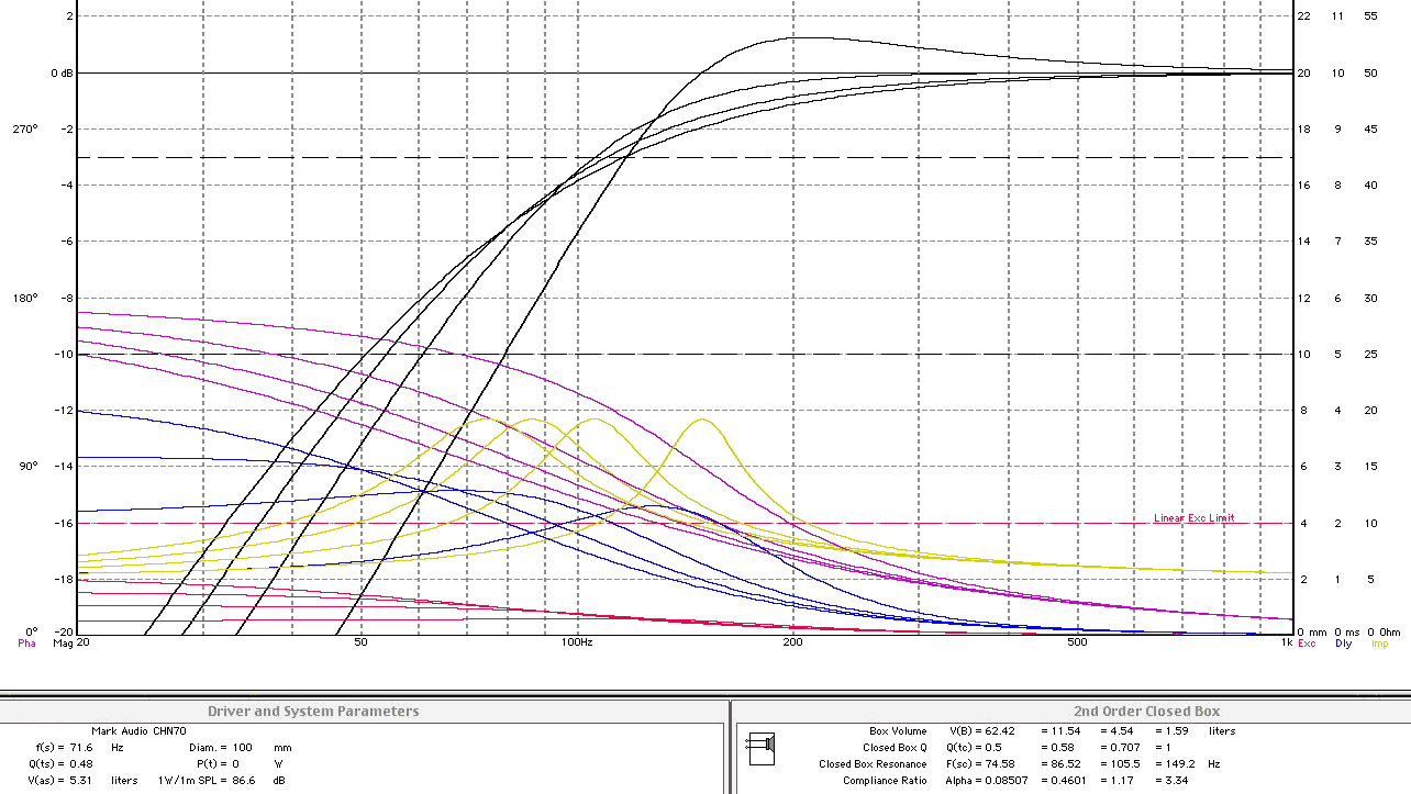

F3 moves higher, but that is the nominal -3dB point of the high pass filter. Toole has shown that F3 has nomeaning to our ear/brain and we should be looking at F6 or F10.
From the arbitrary sealed sim attachec, lower Q actually goes lower by this criteria.

Okay, well that's interesting. In the past I've seen posts referring to F6 and F10 and didn't understand what that was all about. I thought that F3 was the most important roll-off frequency.
Possibly I could argue that bass roll-off with respect to Qtc = 0.5 starting at a higher frequency than where Qtc= 0.7 is more influential than the lower F10 of Qtc = 0.5. The earlier starting roll-off of the frequency response for Qtc = 0.5, relative to that of Qtc = 0.7 looks to be not more than -1 dB, but it does extend over a fairly wide frequency bandwidth.
Ray Alden in his book Advanced Speaker Systems attributes less bass response from choosing Qtc = 0.5 to bass roll-off (for frequency above F3) starting at a higher frequency, compared to a Qtc > 0.5.
Initially it was in my head that choosing Qtc = 0.5 resulted in a loss of bass response, but as I discovered I really didn't understand what that might derive from.
