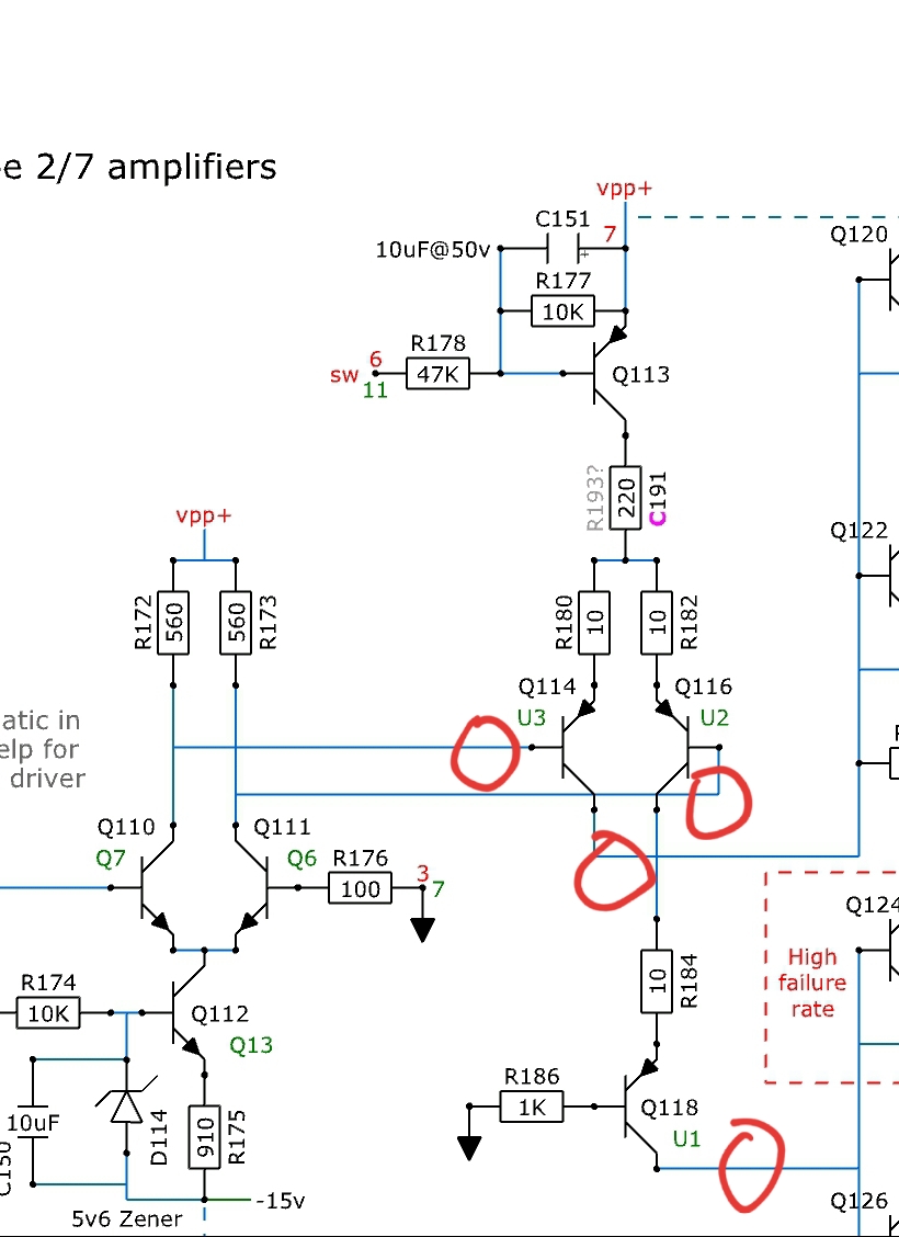

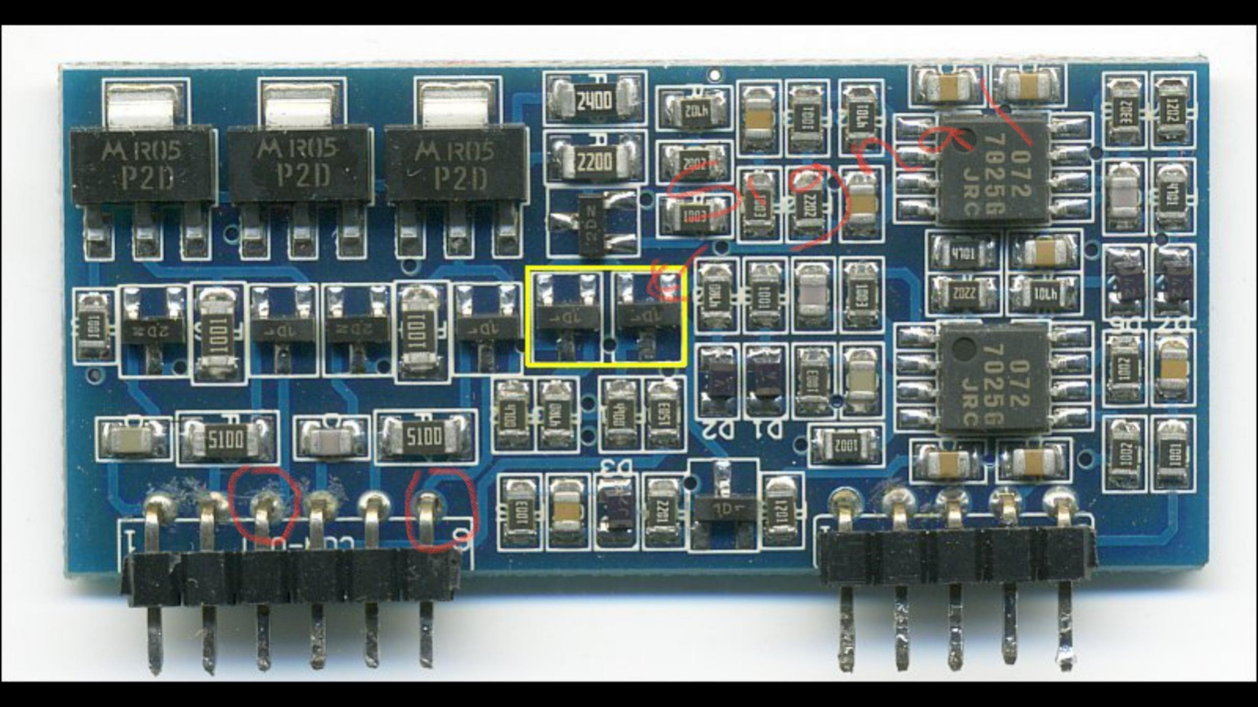

I think the diode is wrong and the resistor is blown. I have the resistor as an 8,2v Zener in notes. I know that it should be a 17v Zener with the J2 mark but that may not be right.
Oky I think it's wrong here pin 3, I have on the rails +47 and -47, on pin 3 -47v and pin 6 + 60v but a dont know wy
Those drive emitter followers so a standard drive signal is what you can expect to see.
Q13 isn't an audio transistor. It's the CCS.
