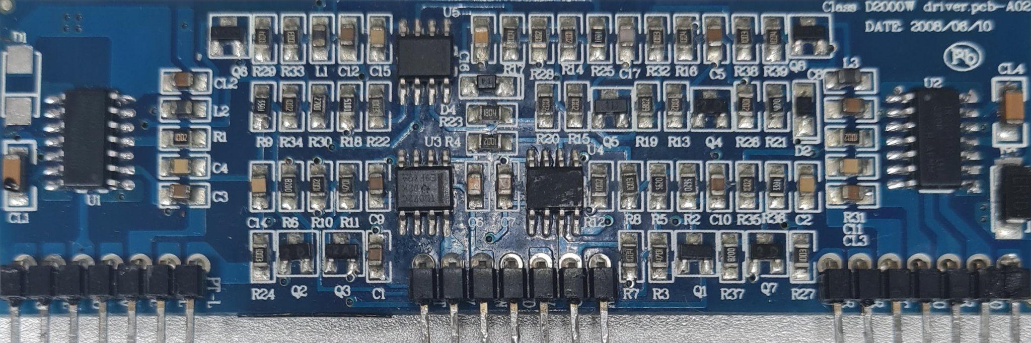

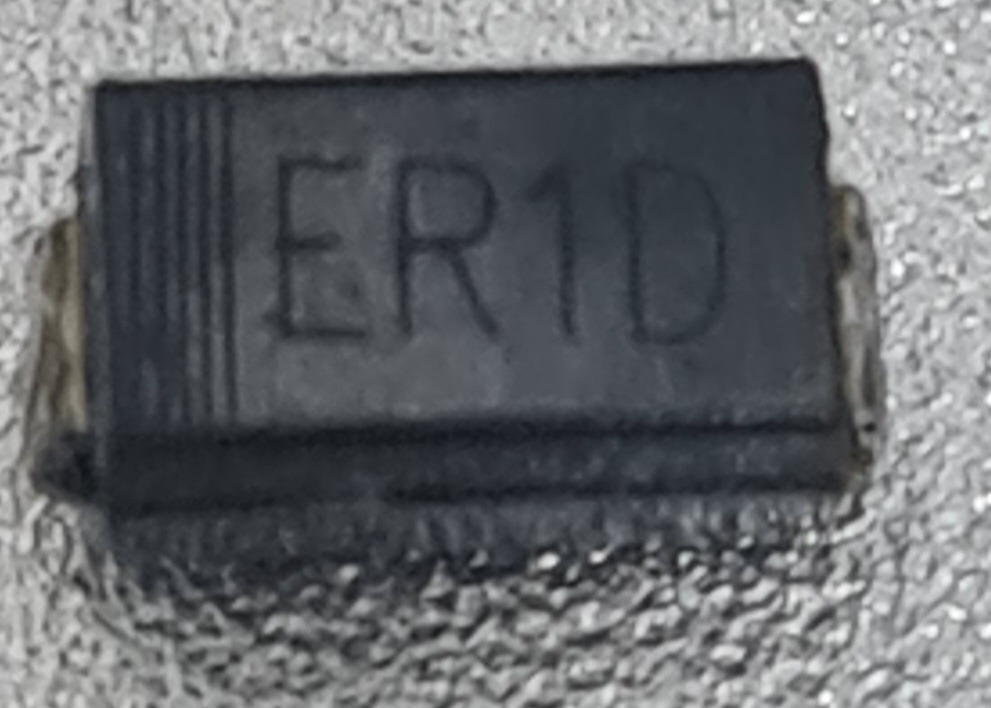

Started doing some rework on driver pcb, after some strange values meassuring on pins of pcb. Replaced 21488's. Found the ER1D diode that had some strange values. Desoldered it, and tested it without anything else connected to it. In forward value ok. But in reverse 1020mv on diode test. Also dead diode D1. The short must have damged a lot of parts on this side of the amp. Rest of transistors and diodes on pwm board ok. Now i have to wait for the ER1D diodes. Tvs diodes didn't arrive yet. So wait a few days more, to do some more rework on the amp..

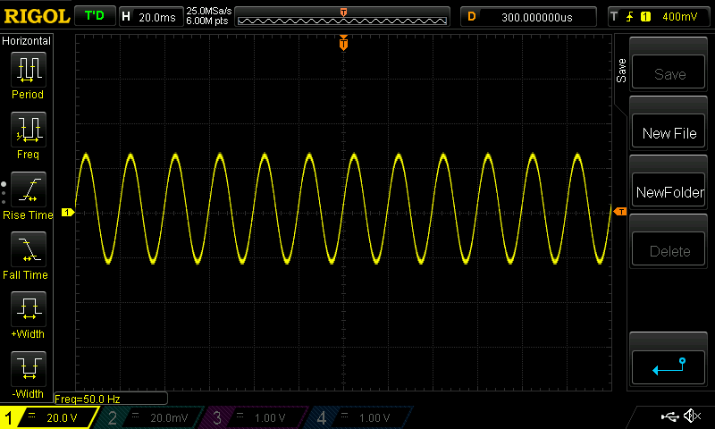

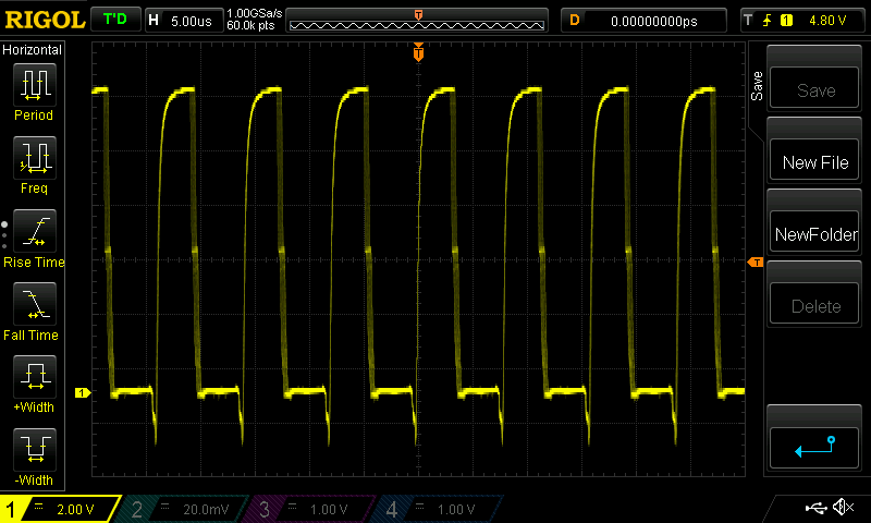

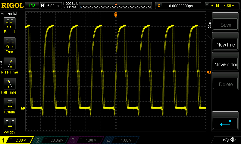

yesterday i installed the driver board, and installed the fets in one channel. Went well, installed the new ones in channel one. I'm little curious about the gate signal.. Is this normal?
After it stayed on, i inserted a 50Hz signal with signalgenerator. Works well.. Without any stange signals. see output 50HZ speaker output.

The ch2 gate has slightly more slope on the rising side than I'd expect, especially when having the other channel for comparison. Is everything for both channels identical?

I think that de difference is that, channel one has the new type Fets FDA38N30, en channel two has the FQA38N30 that where standaard in the Amp.
I did that to compare. But if that ai'nt gonna be a problem, i leave them inside.

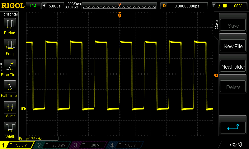

I also checked it with Fets out of the board.. Square wave is super sharp. so think signal alters with fets inside the board..

The capacitance of the gate of the FETs and the gate resistance alter the wave shape.
