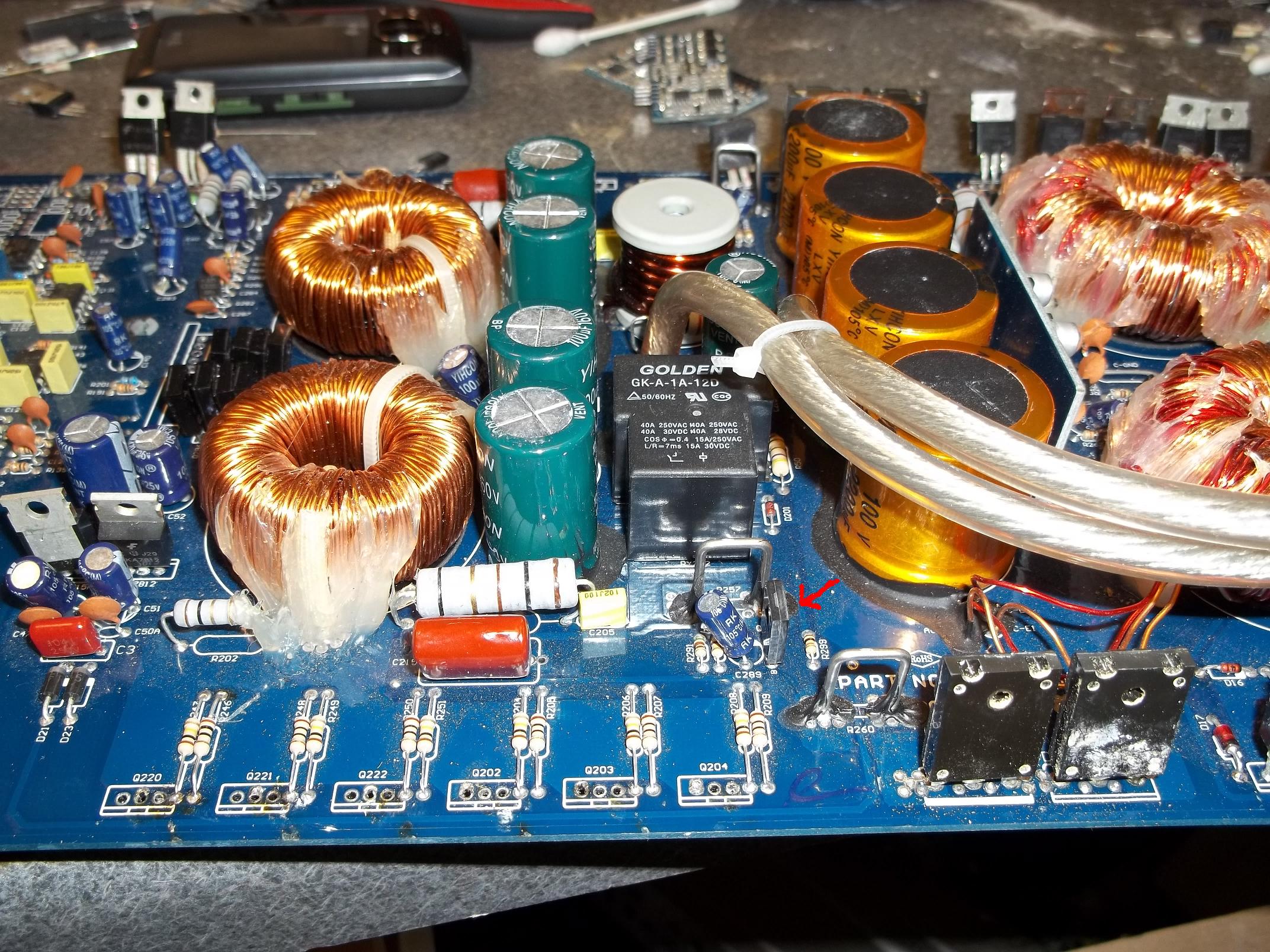

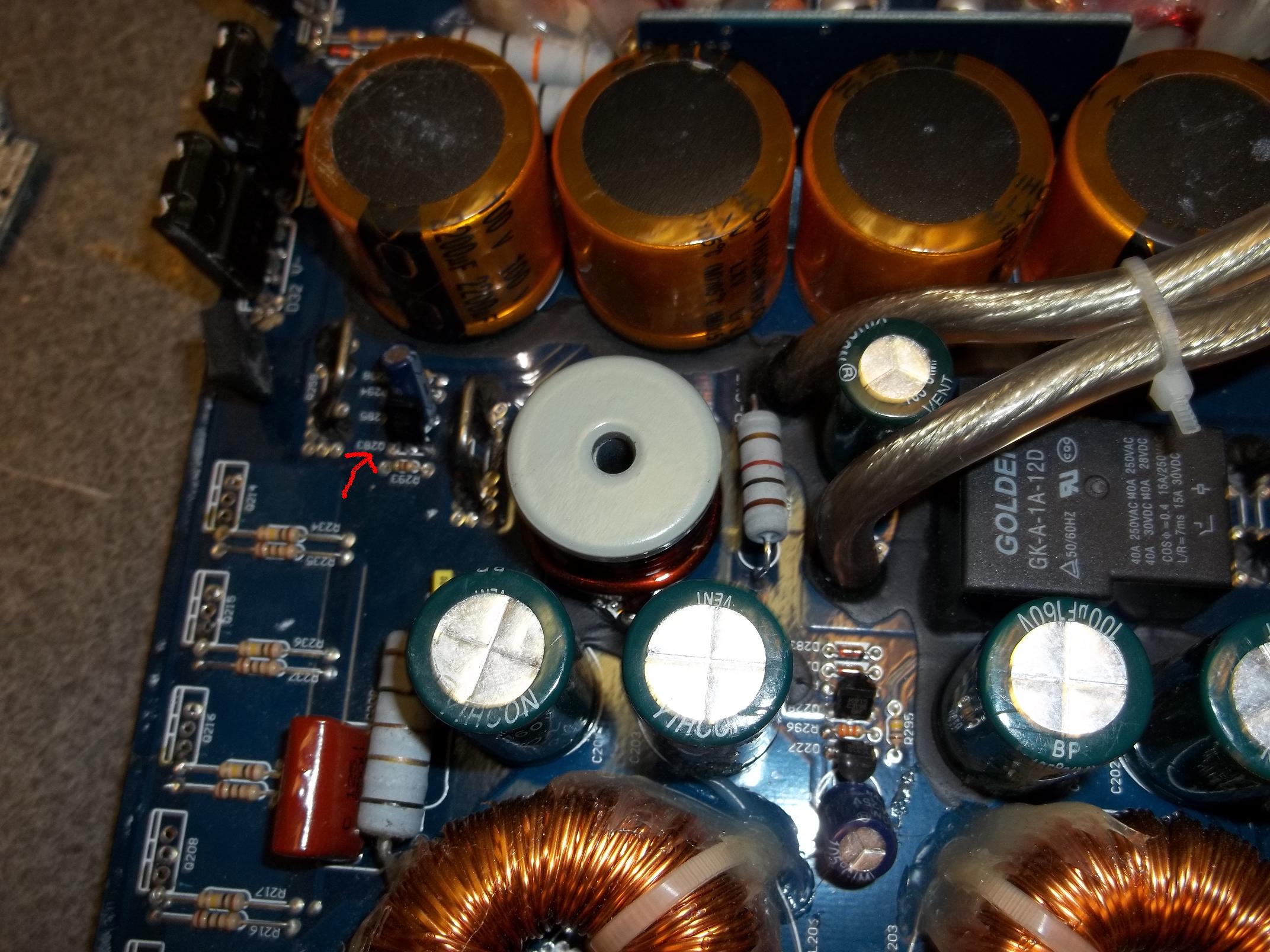

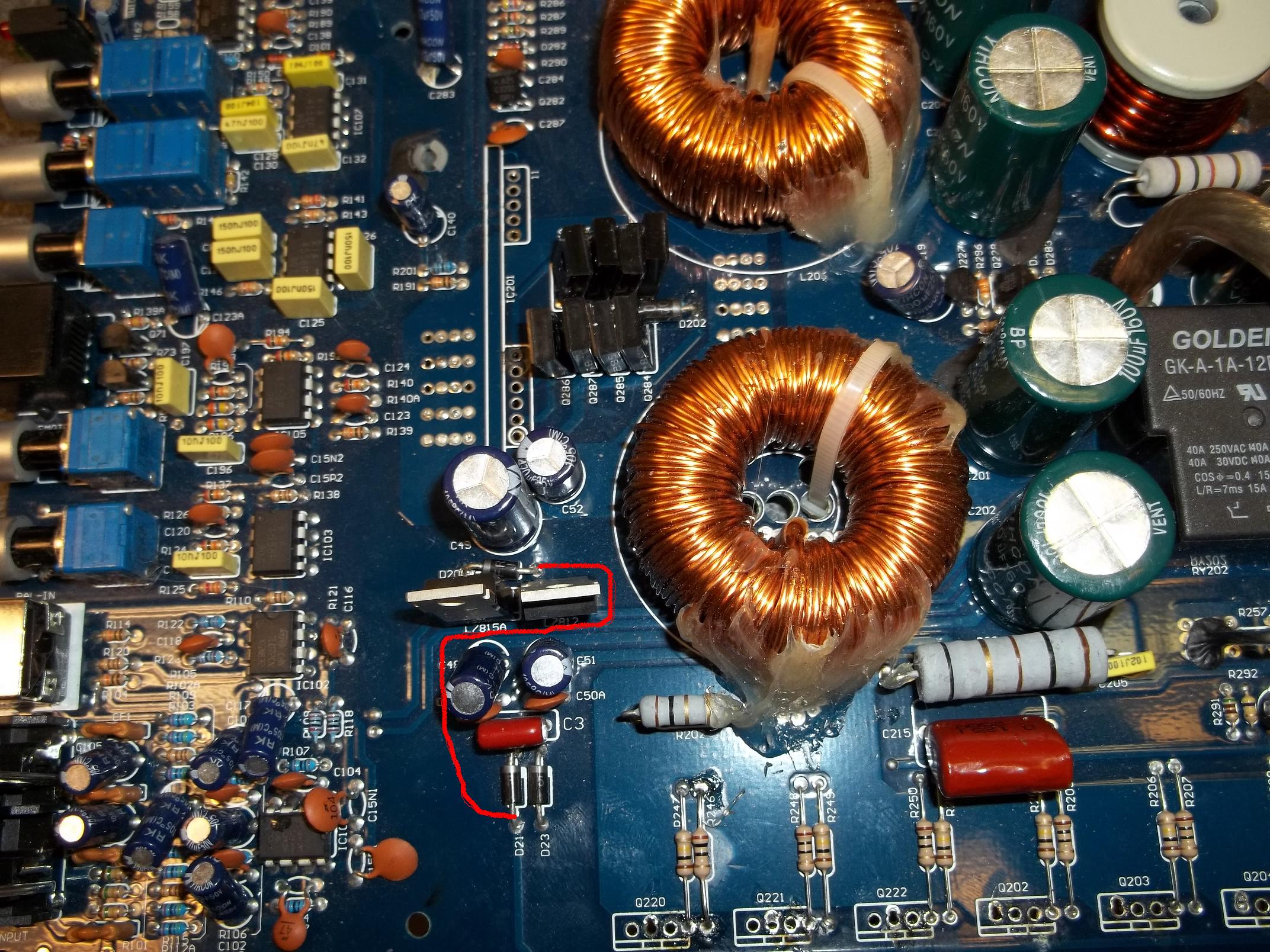

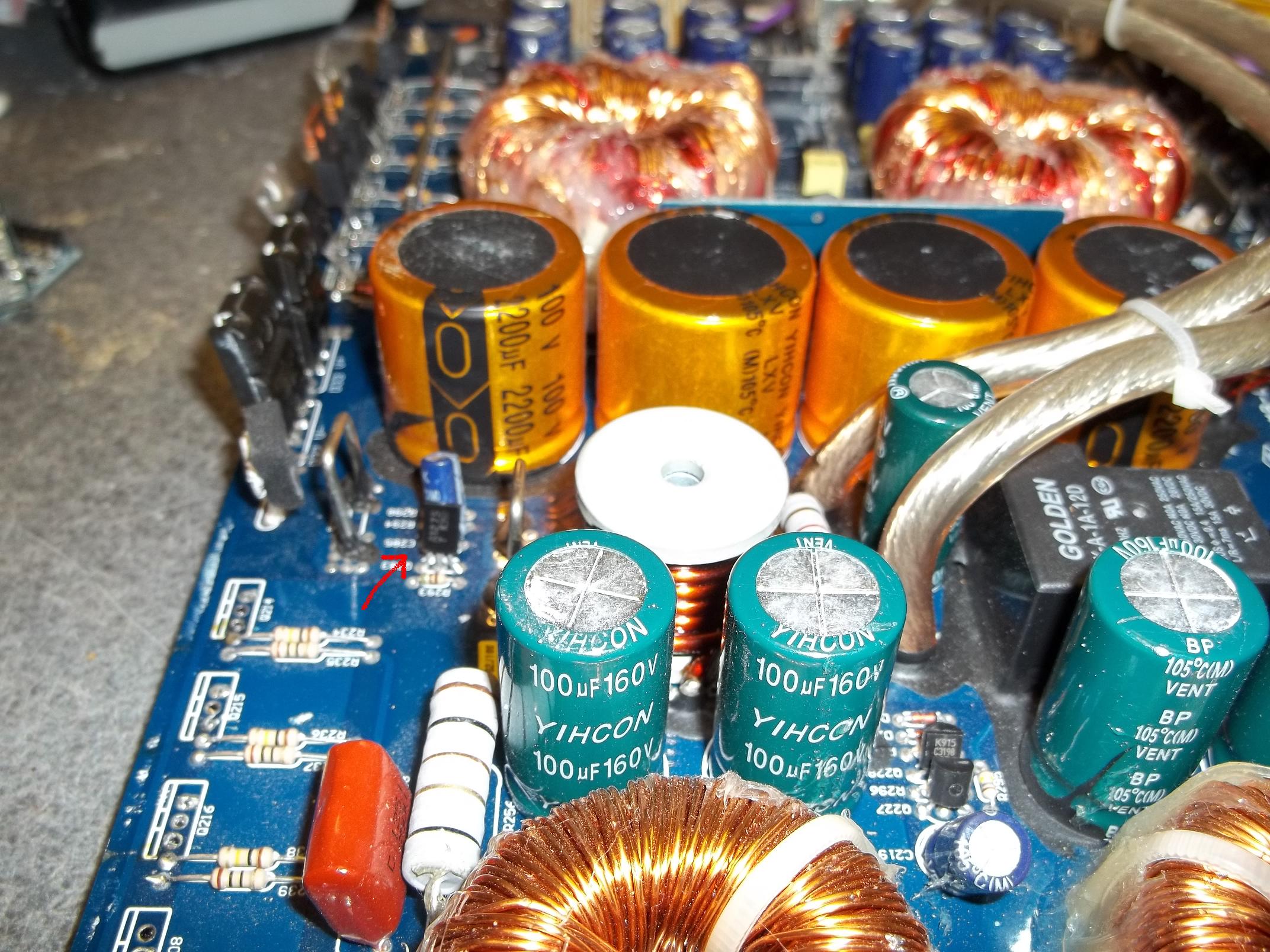

Checked the diode and it tests fine. Replaced the A1275 that its connected to also. Amp is still stuck in protection
The diode location Is D20 1 end connects to the Middle leg of the 7815 and the same side of the diode also connects to the first leg of an A1275 (Q238) and also connects to D21

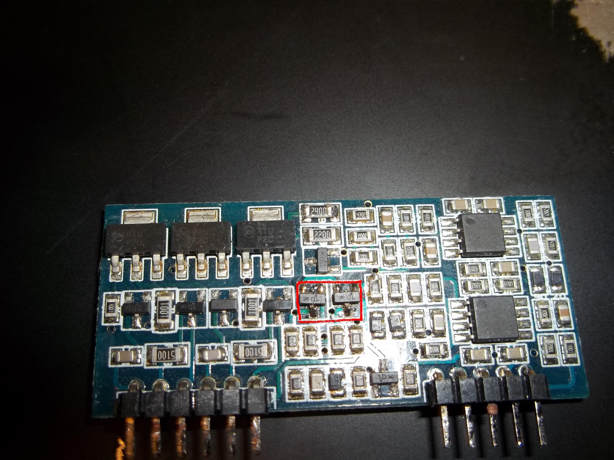

Are the two transistors near the shunt resistors (rectangular metal loop resistors) connected to the shunt resistors (via smaller resistors possibly)?
If so, have you checked those transistors?

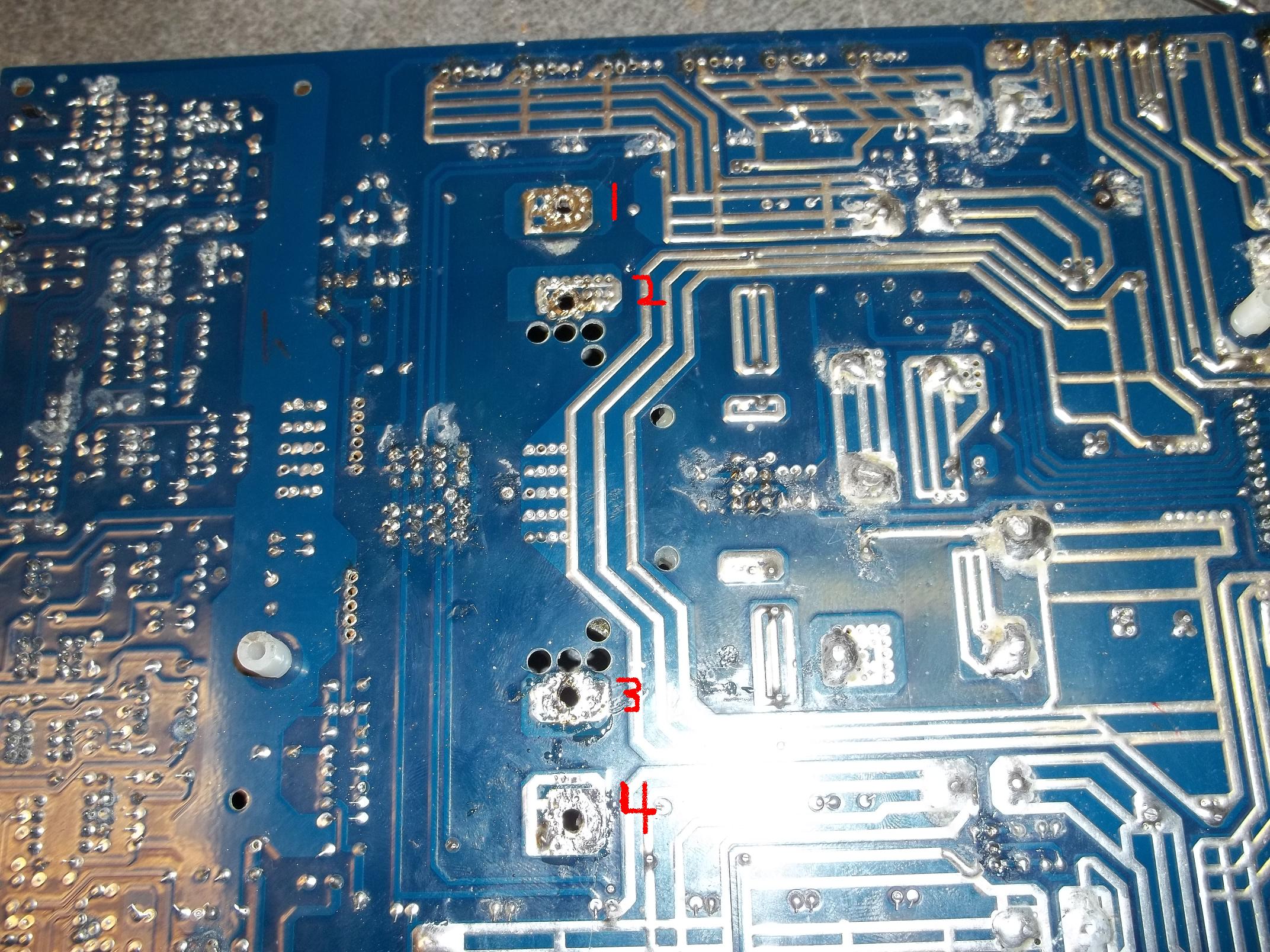

I placed black meter probe on leg 3's pad for the outputs and red probe on the output inductors pad
1:0.04 ohms
2:2.4 ohms
1:0.04 ohms
2:2.4 ohms
