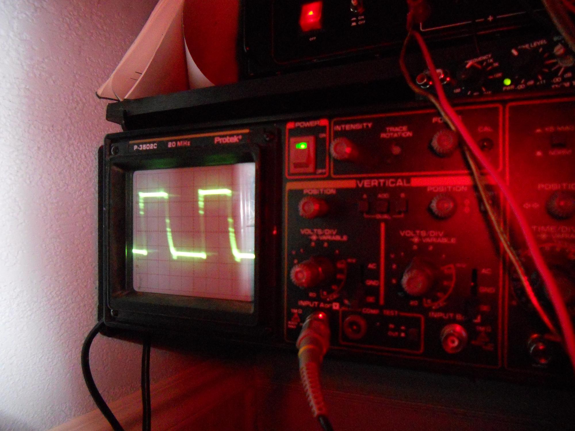

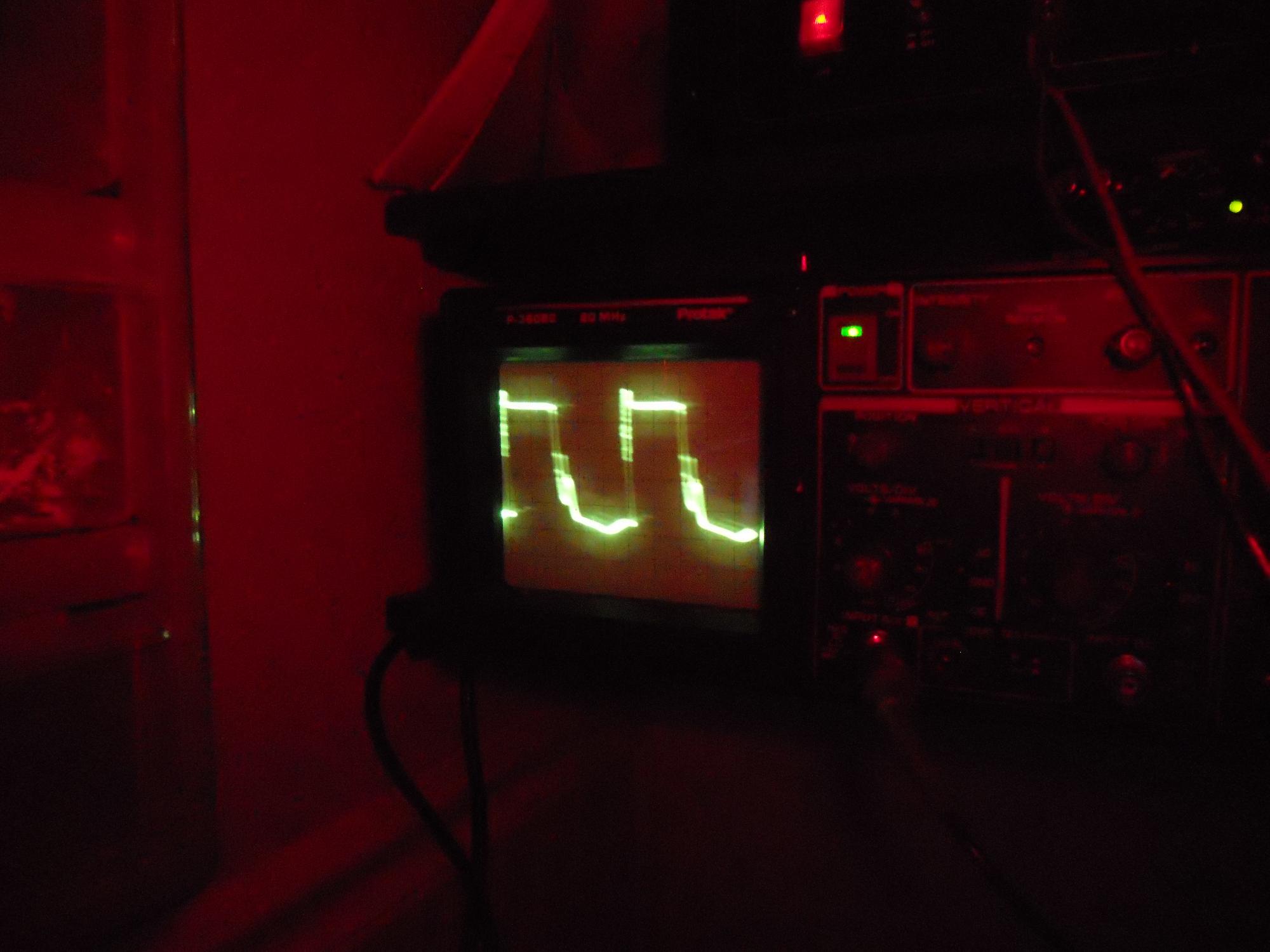

Ok i put another 1 in and have 1K on both of them now and .465K from emitter to ground on both. Power amp up and the fets get red hot still.
The current draw seems to be greater than the waveform would cause. Have you tried twisting/pushing/pulling on the transformer to see if the current draw decreased?

For the last two waveforms, it appears that the left signal is driving the FETs off but it's not well controlled. The one on the right appears that it's not switching any FETs off.
Measure the resistance from the non-FET side of the gate resistors to ground. What resistance do you read?
Do this for all FETs in case there's a break in the circuit.
