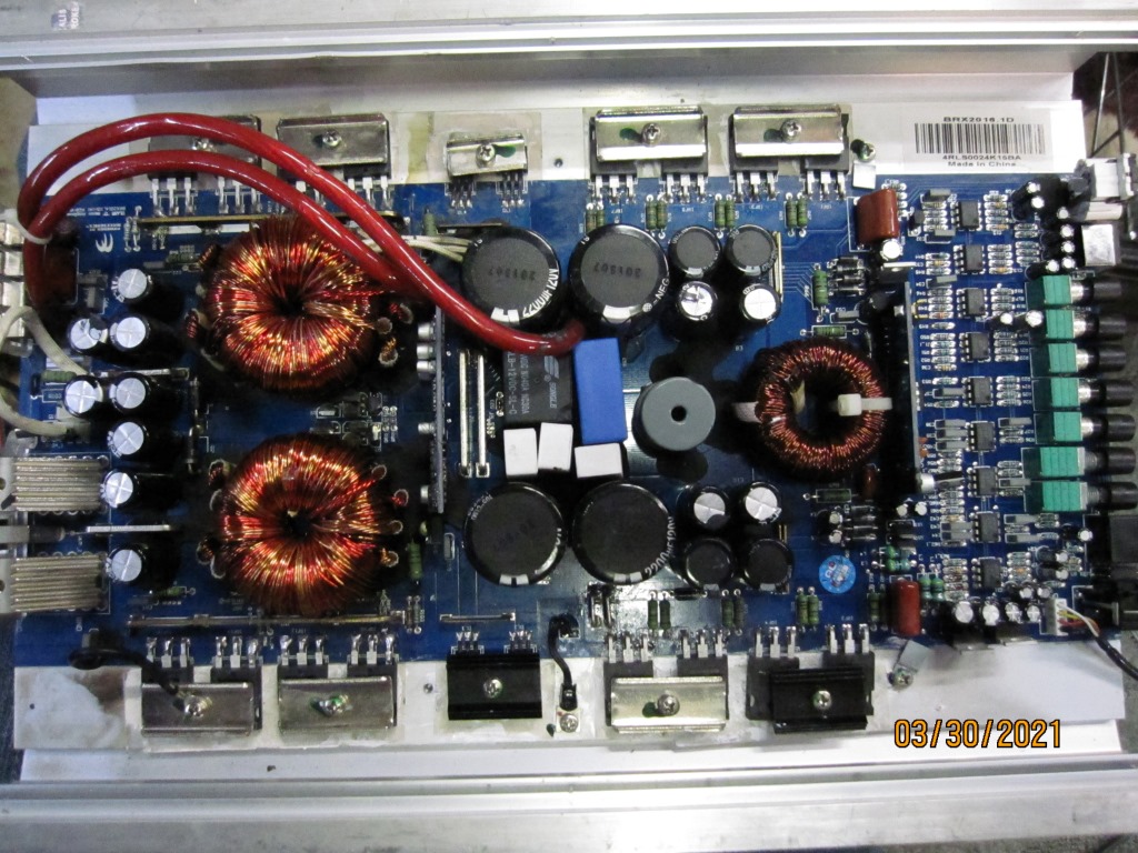

so i have a hifonics brutus 2016.1d that powers up but has no sound except a loud pop when i turn off the power.. thinking about it this it might be cuz im just cutting the power supply and not turning off the remote first.. ill try that next time..
1 side of output fets read 77.5 volts on the drain and the other side reads 77.5 volts on the gate and source is that normal?

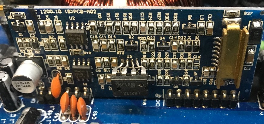

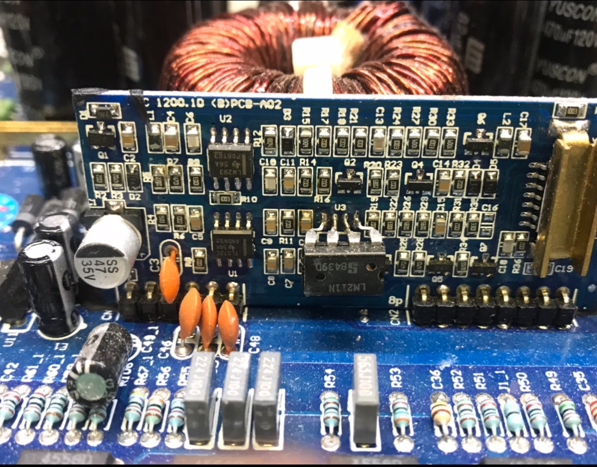

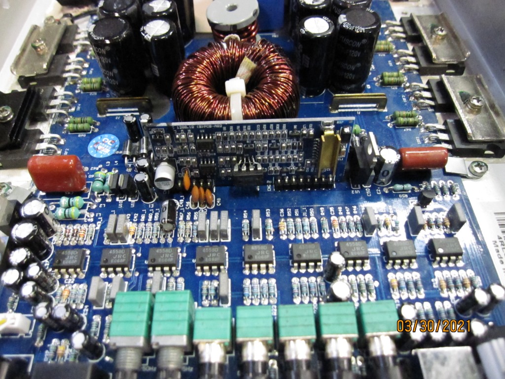

i found a chip on the driverboard was burnt so i ordered a new one based on what i found online was chip lm211 and it was a bit larger than the one on the board.. i put it on anyway.. i know not the right move im sure but what should i be checking and whats the correct part to order?
yes the lm211 had a raised white spot on the chip.. model was not readable on the chip itself and google was giving unsure results so i cross referenced driver board on another amp that matched 2 out 3 chips so i figured would be a good assumption to go 3 for 3 and say was lm211.. the one i ordered said lm211 but reads lm211n and is twice as big as you can see..

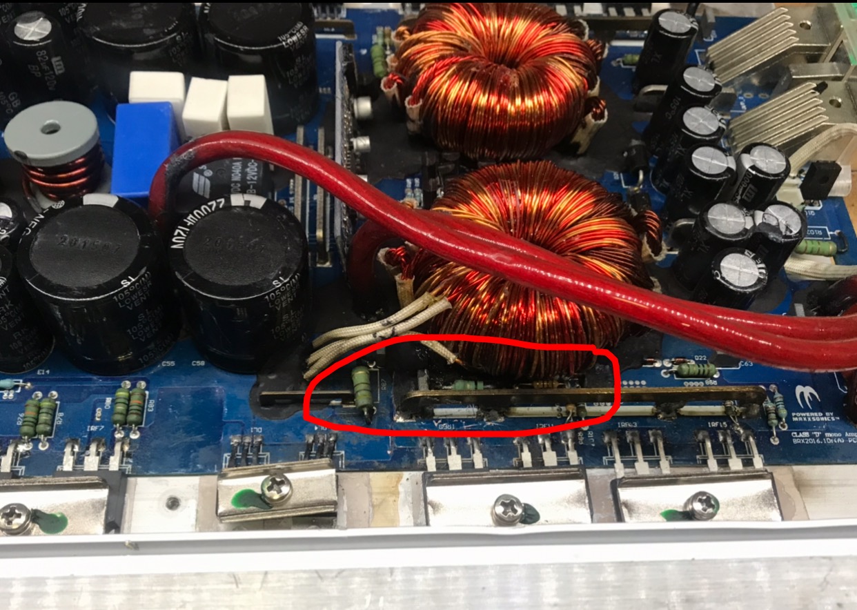

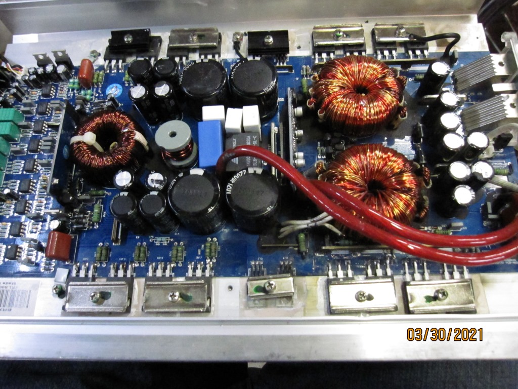

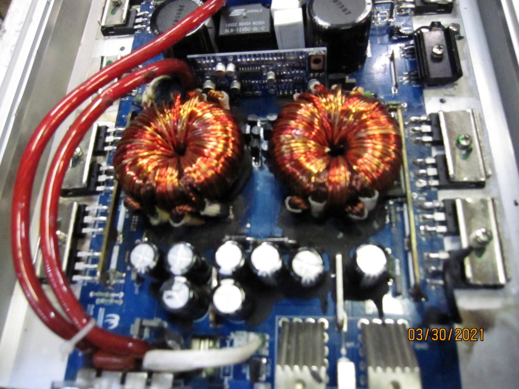

a little more background on the amp i forgot to mention.. i replaced all the power and output mosfets and a few resistors around the what i think is the transformer.. i had to pull the rail right next to it to get to it and it had appeared like the transformer itself was burnt on the bottom so pulled it and checked it but was fine.. was just soot from the nearby resistor burning. reading online said larger resistors are ok to use but not smaller. in physical size, property value still has to match.

reading pin 4 at -3.88v and pin 8 at 4.56v
theres 3 white blocks in the center of the board and the middle ones gets pretty hot after a min or two.. ive read those pages and they help a little hut im working on reading more as i find time..

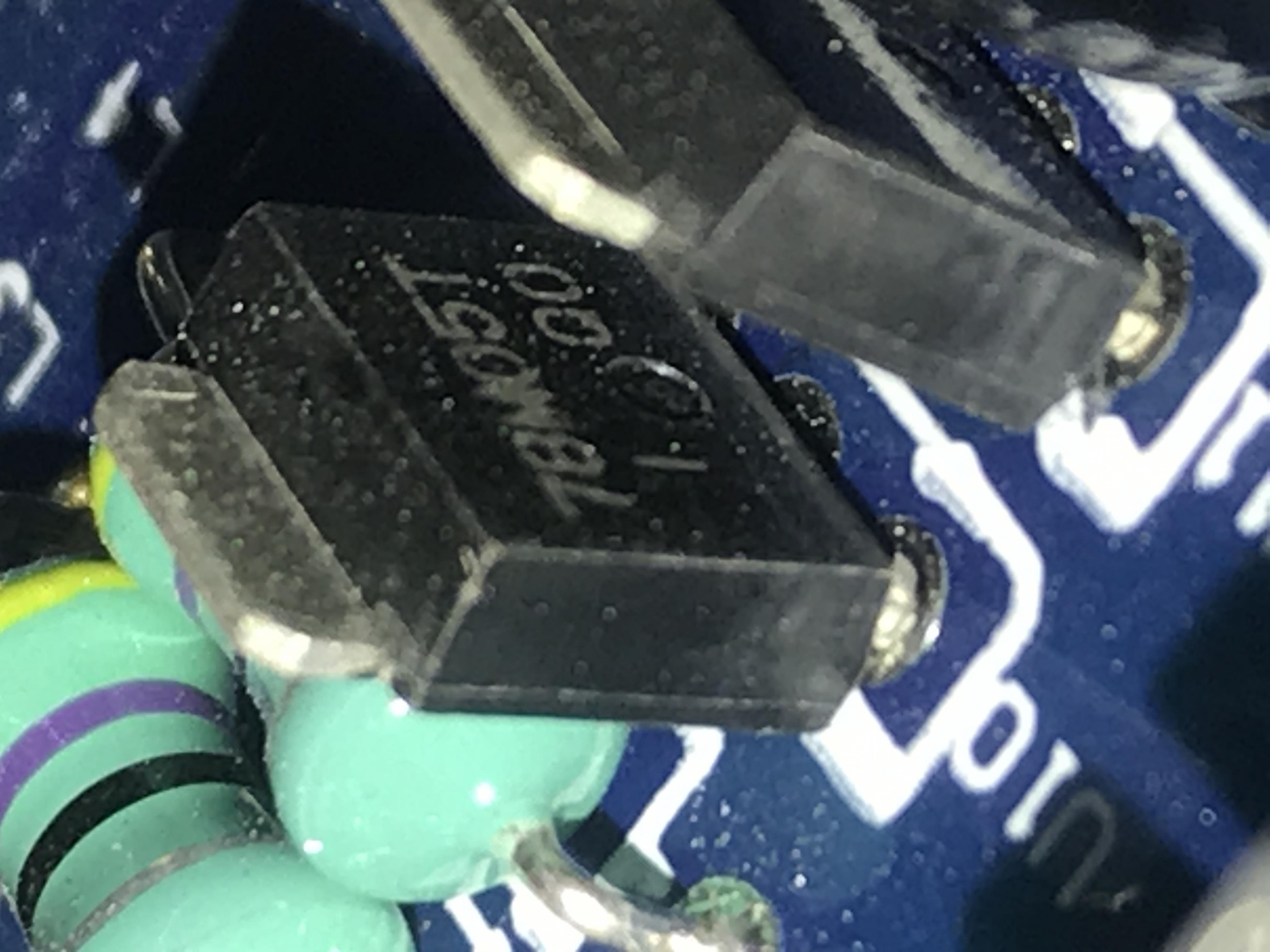

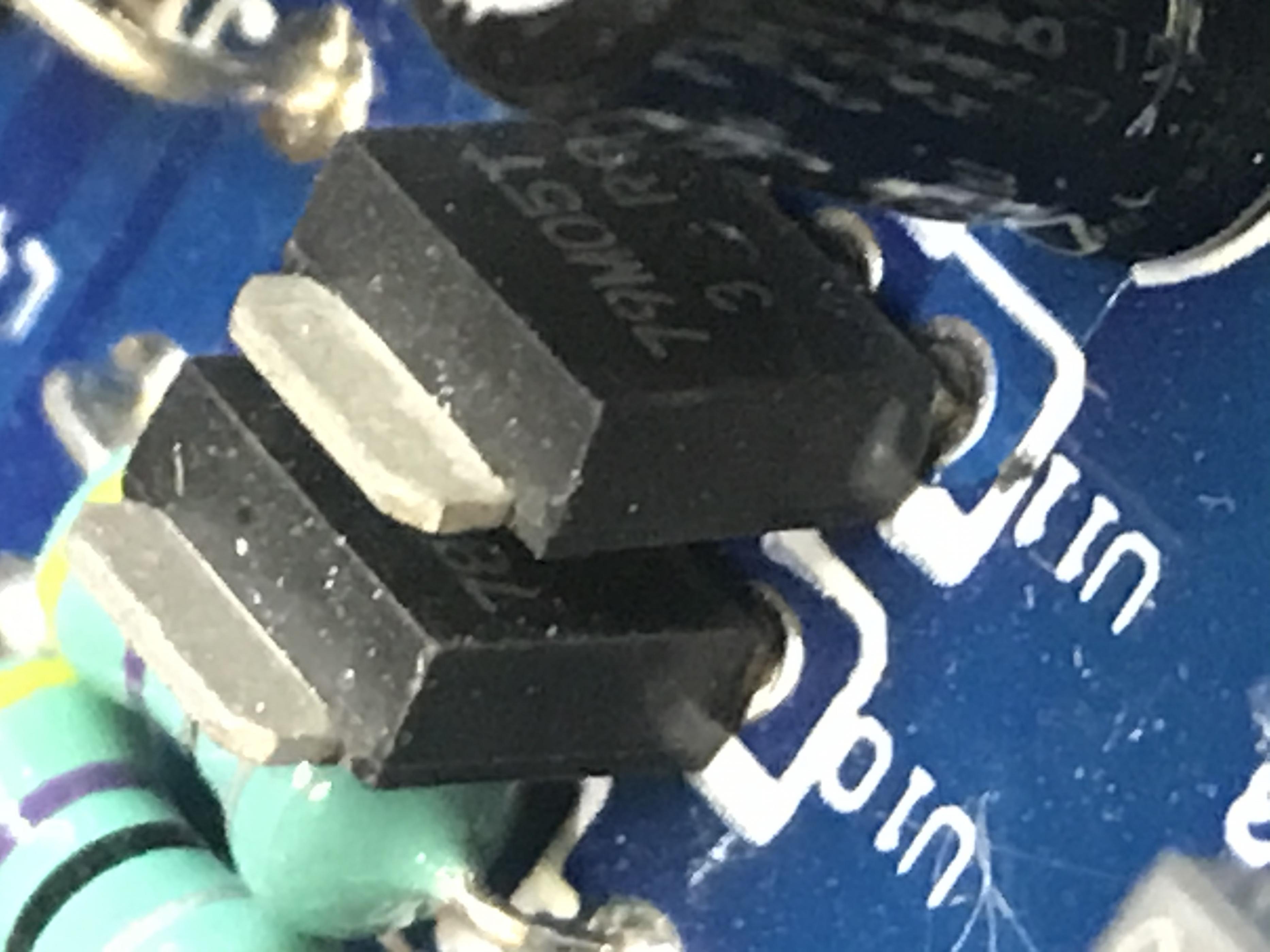

What are U10 and U11 at the end of the driver board?

heres u10 and u11

Post the DC voltage on all 3 legs of both of those regulators.
so if they work like a mosfet transistor with gate drain and source this is what i get
DC gate | drain | source
U10 15.34 | 0 | 5
U11 0 | -14.8 | -5
post doesnt keep format but think its close enough to understand

These are not like FETs. They are voltage regulators. The pins are:
LM78M05
Pin 1: input
Pin 2: ground
Pin 3: output
https://www.ti.com/lit/ds/symlink/l...17567&ref_url=https%3A%2F%2Fwww.mouser.com%2F
LM79M05
Pin 1: ground
Pin 2: input
Pin 3: output
https://www.mouser.com/datasheet/2/149/LM79M05-461616.pdf
Why do you have -3.88v on pin 4 of the LM211 when there is -5v on the regulator?
rechecked the readings and this is what i got
U10: 78MO5T
Pin 1: 15.39
Pin 2: 0.00
Pin3: 5.00
U11: 79MO5T
Pin 1: 0
Pin 2: -14.82
Pin 3: -5.08
LM211
Pin 4: -5.07
Pin 8: -4.58
and not sure if i said this before but one of the white rectangular blocks in the center of the board next to the relay gets pretty hot.. 179° F if thats considered hot or not for electronics.. way hotter than any other part of the board which was around 90°F
and i ordered the correct LM211 soic chip should be here tomorrow..
The difference between -3.88 and -4.58 is significant. What happened between measuring the voltage to make the readings so different?
