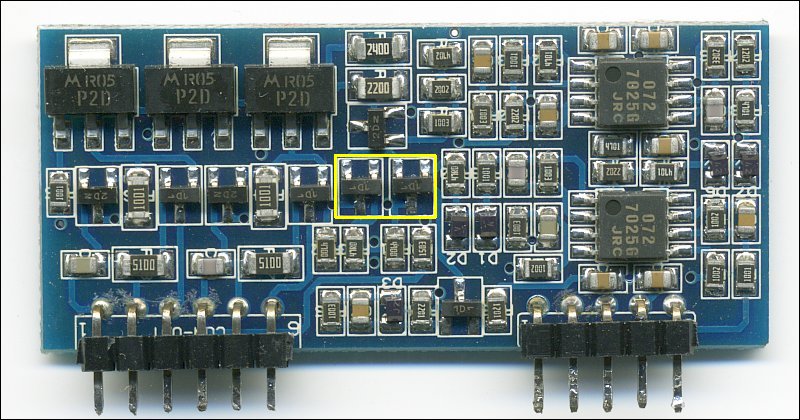

just a question q6 and q7 are those the 2 from the previous picture in the yellow square

question refers to this post by Perry
If there are no shorted output transistors and no output transistors with broken legs, the most common fault for amps using this driver board is the failure of the two transistors in the yellow rectangle.
There are at least two versions of this board (with regard to the circuit board designations). The ones in the yellow rectangle on this board are Q1 and Q2.
