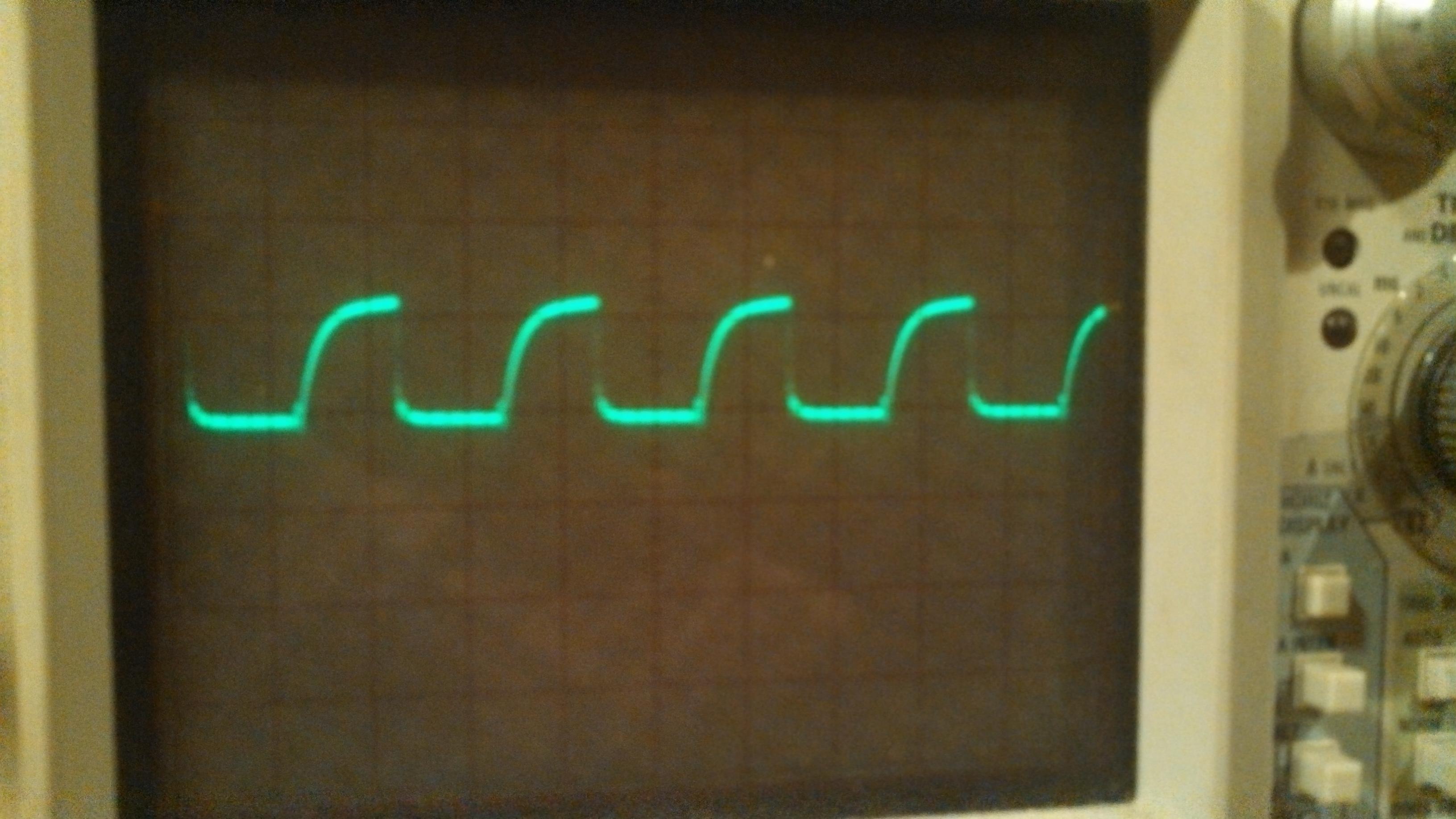

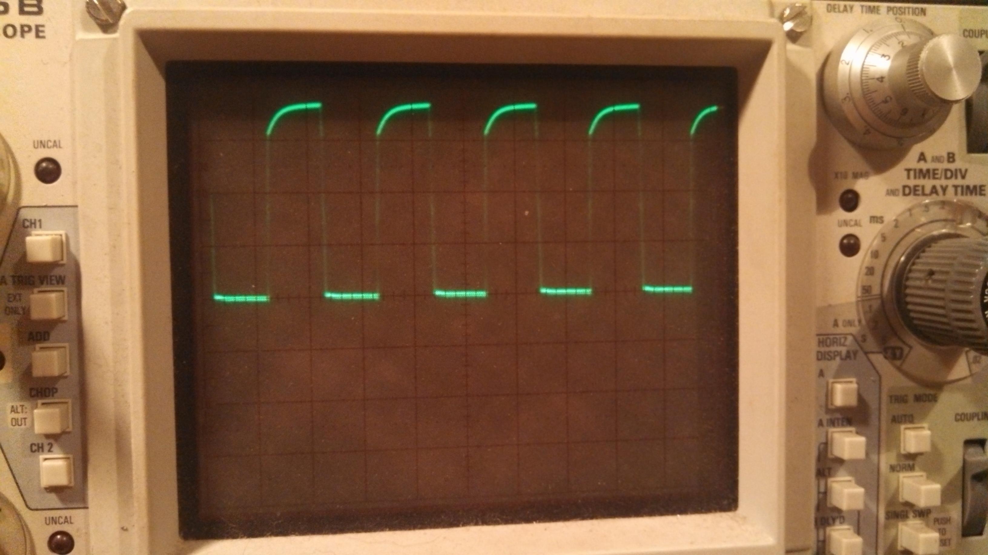

I'm so sorry for all the questions.Think there still may be a problem.The original burnt resistor still gets fairly hot.Just take a minute longer now.The other 10R stays room temp.
There's some static on the output with a speaker connected.The output is ever so slightly distorted.
Here's some pics of the low/high side outputs from the channel with burnt resistor.Actually both channels look the same.No input signal on these photos.
Current draw of less than 2 amps is OK.
The waveforms look OK.
What are you using for an input signal?
