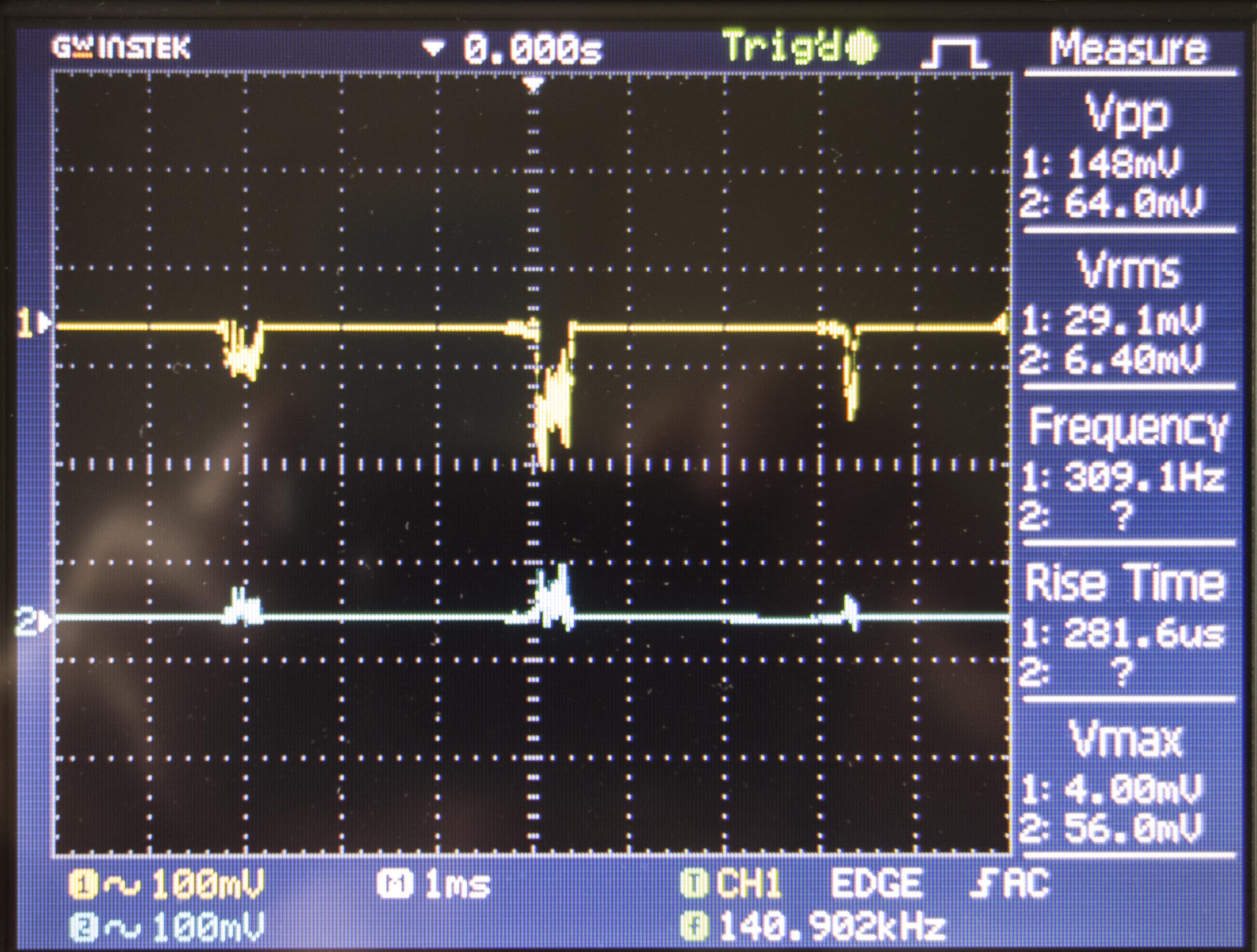

You have some noise issues Tony and we need to find out where its coming from. The metal shrouded IEC inlets often have X and Y caps internally - do you have a spec sheet for yours?
Can you zoom out in your plot so we can see the bursts and how far apart they are? Are they at 50Hz, 100 Hz or some other repetition frequency? Its very important that the noise source is located.

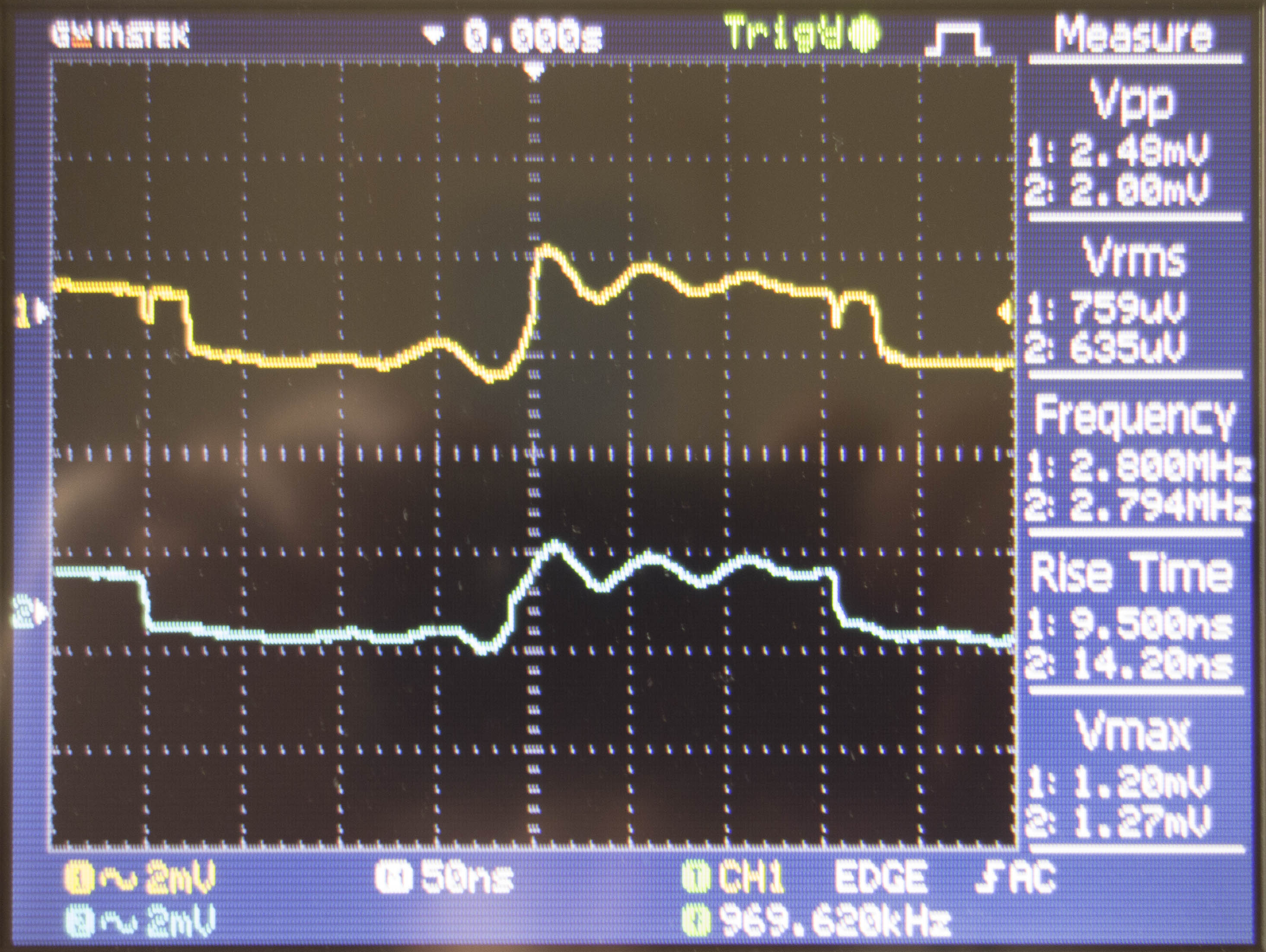

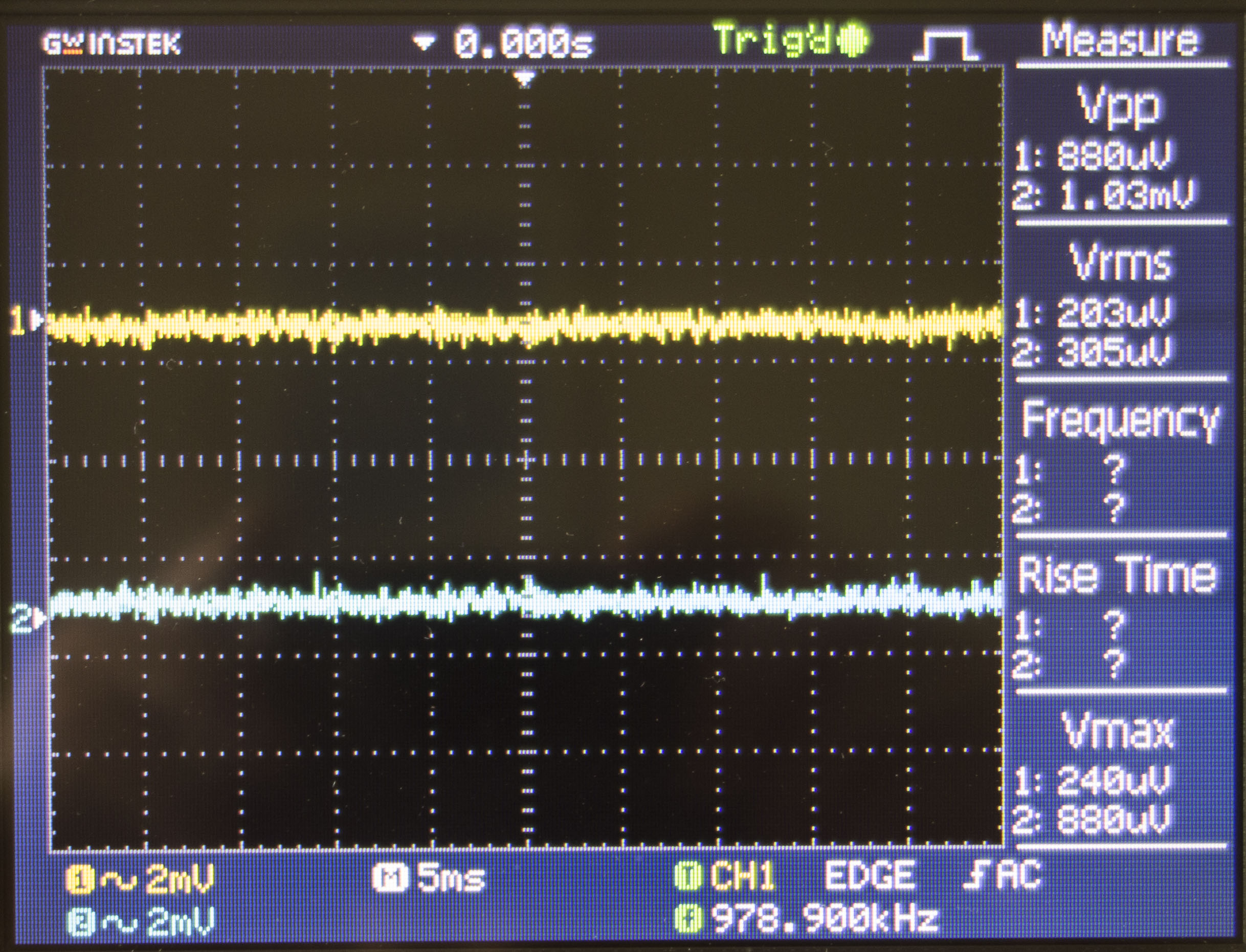

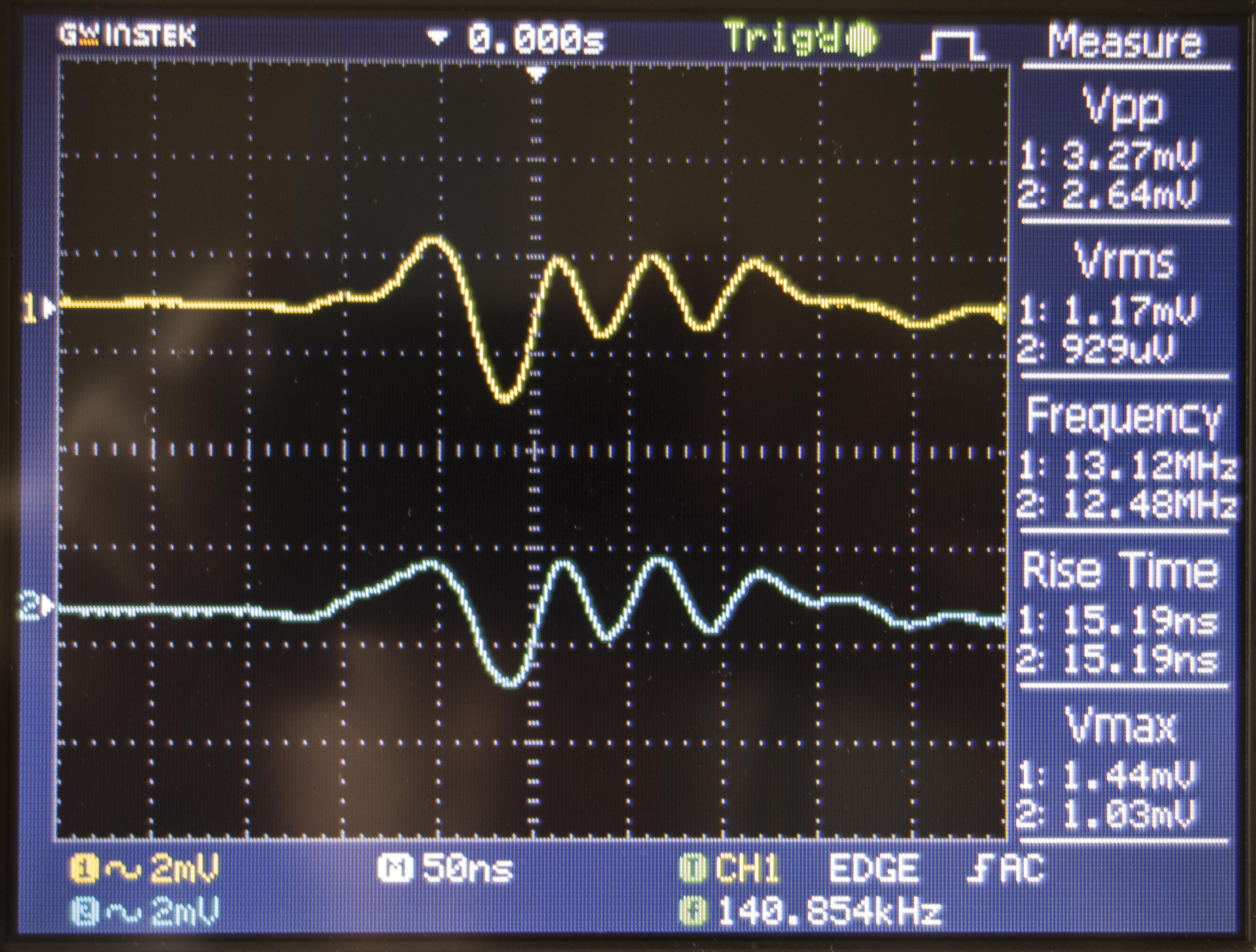

I had actually taken additional pics at 1 & 5ms and 50ns which are attached. Scope averaged at 256, probes X1, inputs shorted at RCA plugs as usual.
Note the difference in vertical scales though.
All pictures with a single earth to the perforated inner plate, as previously explained, which is bolted to the main chassis/case at 6 points with metal standoffs thus also grounding the chassis/case.
The 1ms (caps) and 5ms (no caps) were taken when I was checking for 50/100 Hz AC. Can't remember why I swapped from 1ms to 5ms though.
Those at 50ns because it was the only 'errant' waveform I could find across the frequency spectrum when no RCA caps were attached.

Unfortunately made no difference. These errant waveforms still persist with the RCA caps in place.

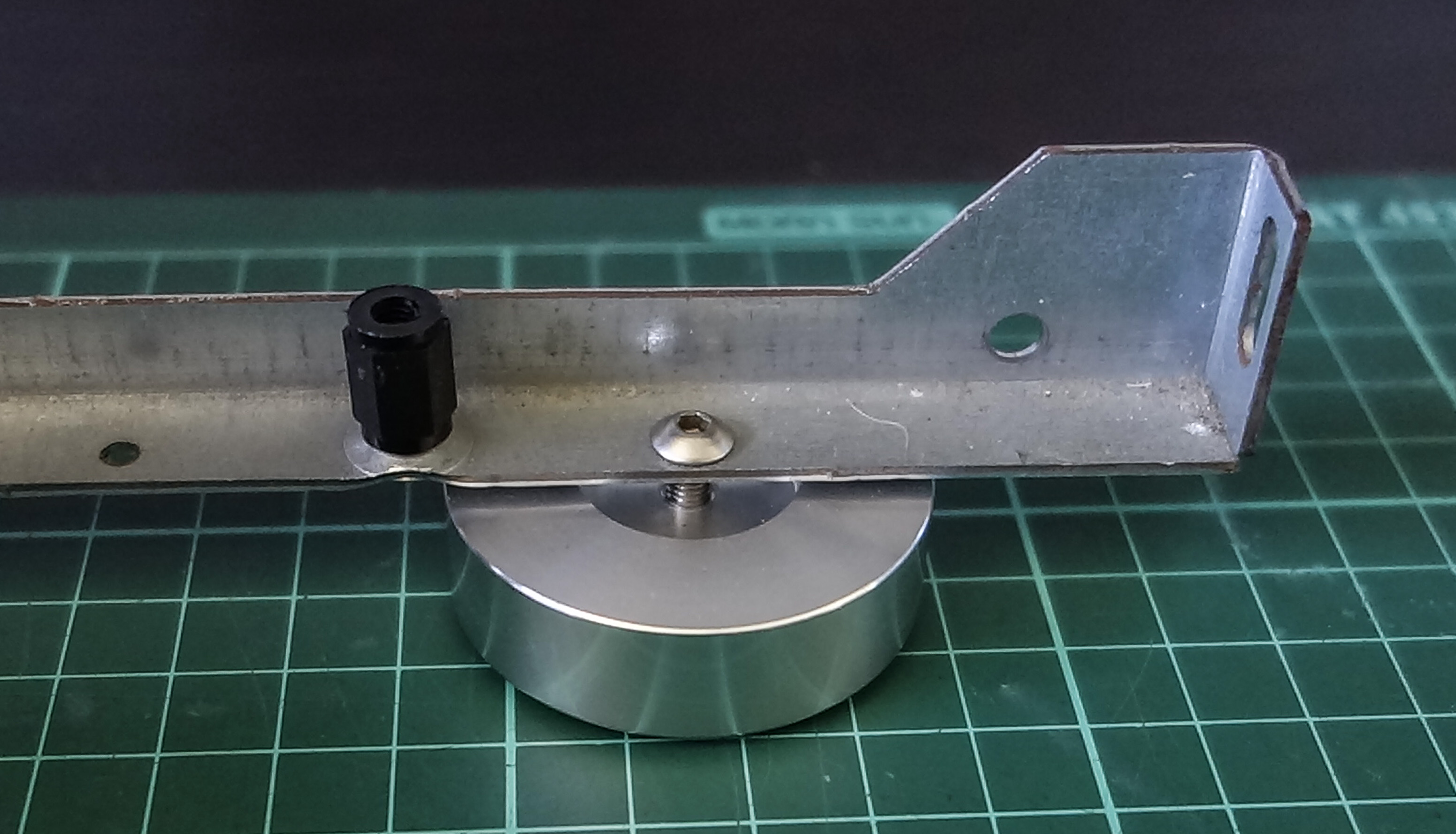

It's all in the case (so it appears).
The case/chassis (Modushop 4U) was set up with an internal perforated base from the same company.
The perforated plate, on which the surge regulator, transformer, and fuses are mounted is attached to the main chassis at 4 points using metal standoffs.
The mains earth was attached to the perforated plate whilst the 4 standoffs were used to earth the case via the perforated plate.
The Amps are connected, one per side, to the heatsinks whilst the 2 Ripple Eaters, one per amp, attached internally to the front, 10mm thick, front panel.
This setup gave multiple problems when the 2 RCA 2.2nF were earthed either at the chassis as I've previously reported.
A complication to this scheme was that the Schaffner IEC plug used has a metal case. Thus it was earthing both on the rear chassis panel punched 'hole', and via the direct connection from the 6.35 mm plug on the IEC connector to the perforated inner plate.
Thinking this 'double earth' might have caused the problems I used black electrical tape to isolate the IEC socket case from the rear panel making only the main IEC earth connection the 'active' one connected to the perforated plate. The chassis/Case is still earthed by the metal standoffs.
Unfortunately this made no difference.
This morning I removed the metal standoffs from the perforated plate and installed nylon ones - thus completely isolating the chassis from the perforated plate. The IEC socket case was still isolated from the chassis by virtue of the electrical tape around the metal case. In other words, the chassis/case was not grounded.
Connecting the 2 RCA 2.2nF caps between the RCA grounds and the chassis/case (no earth to chassis) worked very well. 😀
As above and adding a single earth wire from the perforated plate to the chassis gave almost identical results (as per 'scope'). Maybe marginally worse with a very small difference in noise. This is the preferred method as the case must be earthed for safety reasons.
Connecting the caps to the perforated plate gave the worse results - but still significantly better than what I had been getting. Mostly there's more noise with this schema and a very small amount of 'oscillation' at 25us as compared to the above two (one can see the 'oscillation envelope' but it's in the uV region rather than mV as previously)
Ultimately it seems that the 4 metal standoffs at each corner of the perforated plate were creating some form of earth loop within the case. Perhaps the experts can explain why.

In all cases above the 256 averaged scope readings at 1&5 ms and 25us were < 200 uV mostly less than 100uV.
Metal standoffs used were 15mm, nylon ones 12mm. If they were the same I would have used just one metal standoff for the perforated base/chassis/case earthing.
As it is I'll use a separate wire (which would probably give a more sound chassis earth anyway.

Hi Anand,
Basically the same thing, just replacing the 4 screws with standoffs.
It provides some space between the perforated plate and the bottom plate of the amplifier so that one can, for example, run the power cable to a front panel on/off switch from the rear. Someone suggested it on one of the DIY forums here so I thought it was a good idea.
I haven't tried screwing the perforated panel (PP) directly. Does the PP also make direct contact with the chassis along its length if screwed on directly?
In my setup the PP 'floats' over the main chassis/case with the only contact being via the 4 metal standoffs. Which is why I think maybe the configuration is allowing multiple earth loops?
Attached is a picture of a 12mm nylon standoff attached to the chassis. I had posted it on the DIY Audio Store Chassis forum to demonstrate how I was using the 4 corner base plate screw points to attach the metal feet I was using (The screw holes are tapped, bolts added and the threaded feet screwed in from the bottom. The feet hold the corners of the base plate in position along with the two central bases plate screws).
Hope this clarifies the situation.

Could be that the connection between the base plate and the rest of the chassis was not good due to the zinc plating. However, if you you wire with just a single chassis bond point, there should not be any noise loops.

Tony,
Thanks for clarifying with the picture. Indeed that's a unique method although it seems that it may introduce the possibility of a ground loop as you had experienced.
Where you have the nylon standoff is where a screw/nut combination is used (4 of them) to attach the baseplate (perforated panel) to the bottom bracket of the heatsinks.
In practice, I have never had your issue although I admit it may not be as aesthetically pleasing.
That being said, it is peculiar, as I would not expect your method of mount would make a poor ground connection (even though your DMM says otherwise!).
