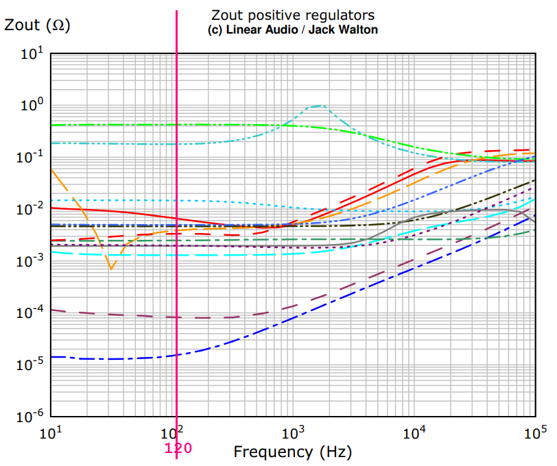

Eventually you reach a point where the economic optimum is to build a full fledged voltage regulator with negative feedback. NFB circuits have incredibly low output impedance at (2 x fmains) if that's what gives you the woody, see excerpt from Jack Walton's article in Linear Audio, below. Pink line at 120Hz. Do you see 6 milliohms? Do you see 1 milliohm? Do you see 0.1 milliohms? Do you see 0.02 milliohms? I see them.
I happen to own a class-AB power amp (50 watts/channel into 8R) whose power supply is in fact a voltage regulator with huge amounts of NFB: the Akitika GT-101. Consider it an "existence proof" that NFB voltage regulators can indeed drive the rails of a class AB power amp. Akitika publishes all schematics online, including the schematic of the GT-101's voltage regulator / power supply. Have a look and calculate its Zout at 120 Hz, I expect your estimate will be very darn low.
_
I also happen to own an Akitika GT-101 and I have performed measurements on the regulated power supply. I measured 17mOhms output impedance @ 1.6A output current.
I also measured >1Mhz ringing on the turn-off edge. Although, this is unlikely to happen in a real amp due to the input bandwidth limiting filter slowing the slew rate compared to my switching load.
Perhaps Bonsai's next amplifier project, in a couple of years, will be a 200 watts/channel class AB amp with regulated supply rails of vanishingly low output impedance. Then when he unveils this amplifier, you can copy his regulator design, without needing to purchase twelve boutique electrolytic capacitors (at 26,75 € apiece) to get the output impedance you want.
Or perhaps it won't, who knows. I can't speak for Bonsai but I do know that MY next power amplifier project, will definitely not have voltage regulators on the supply rails.
