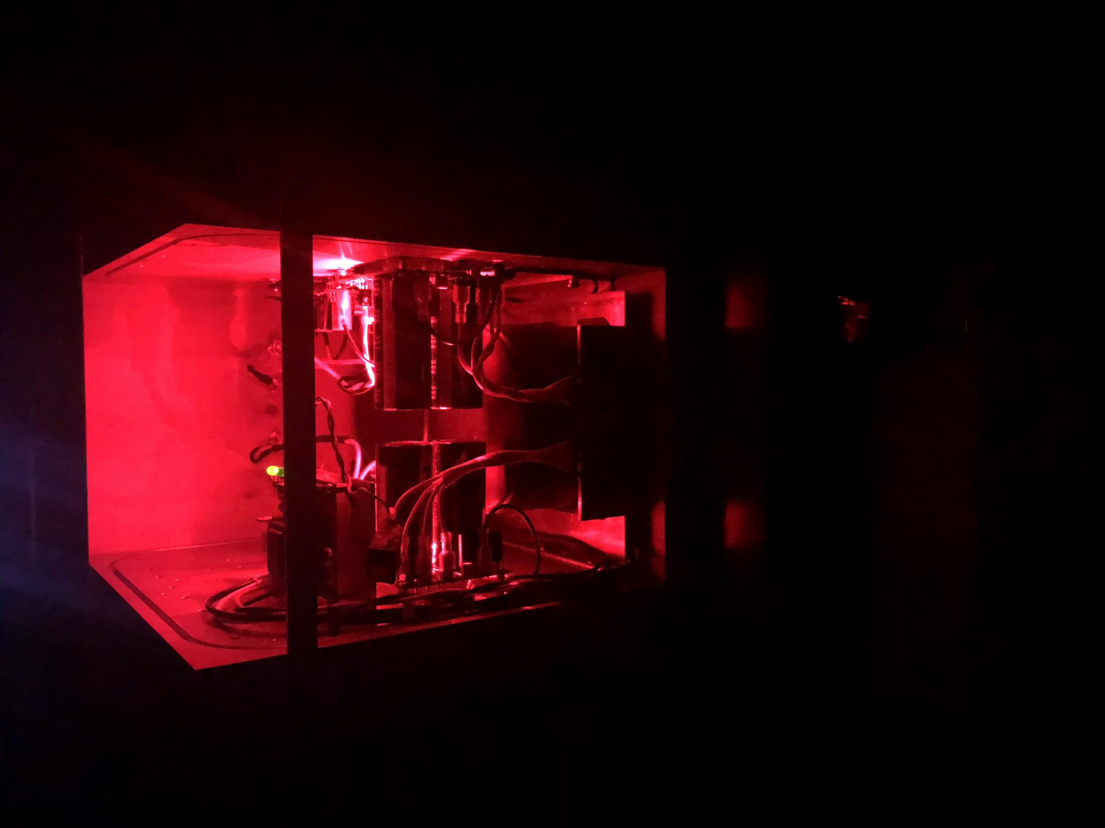

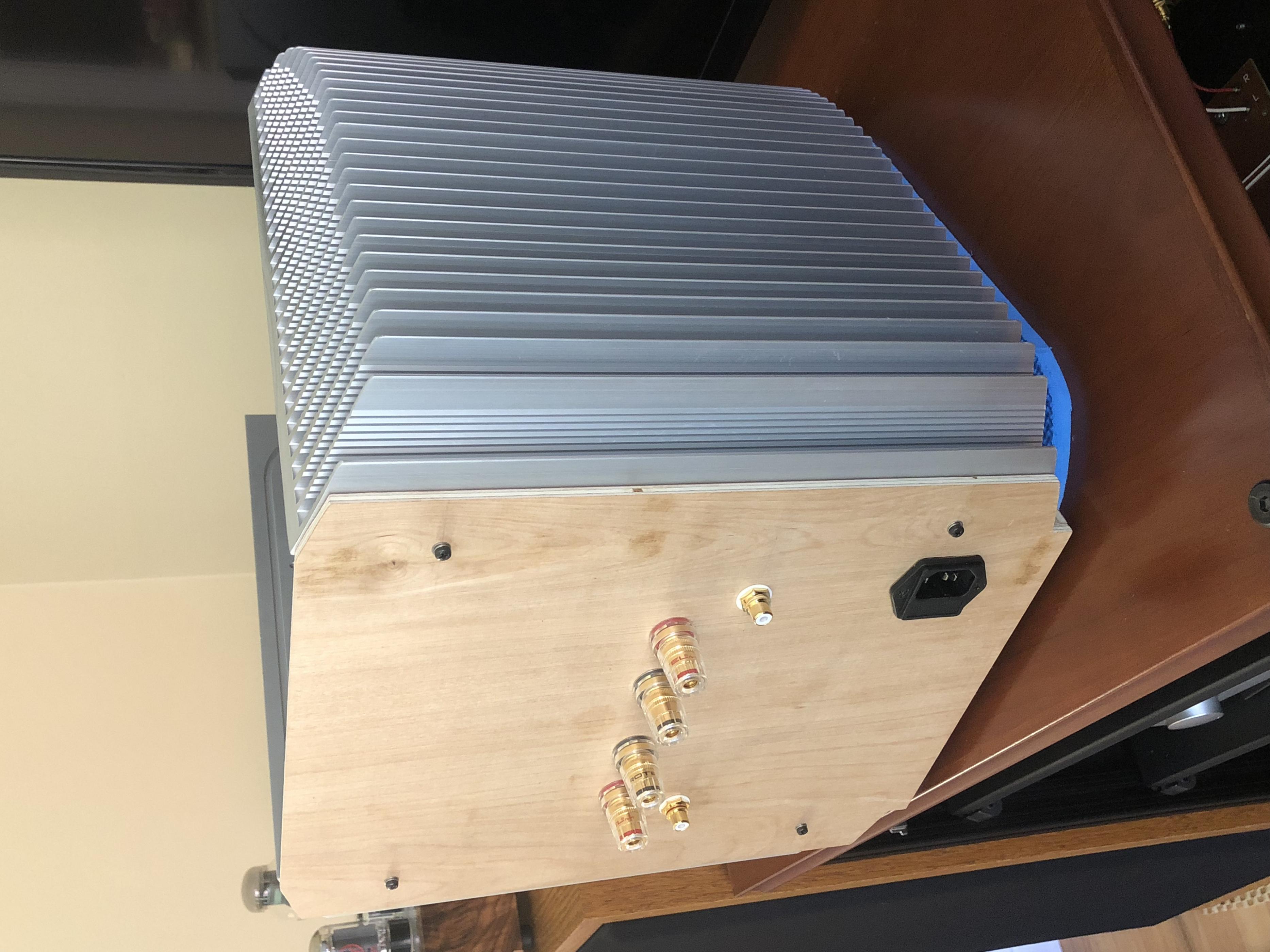

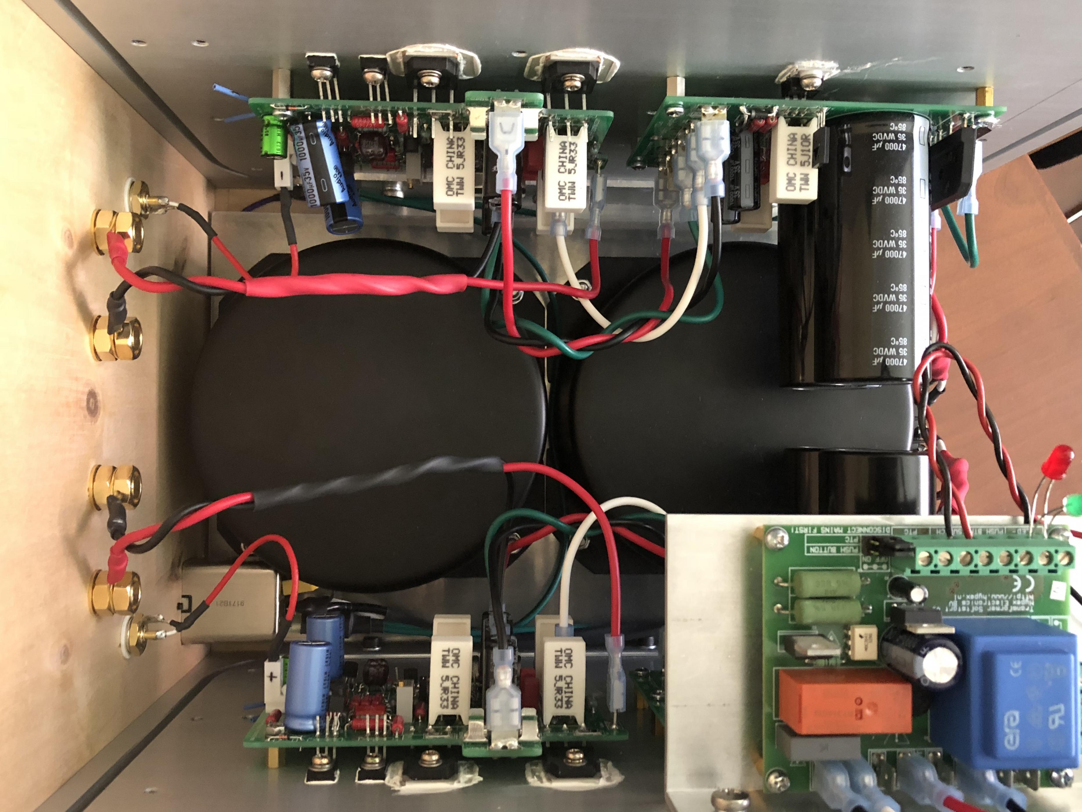

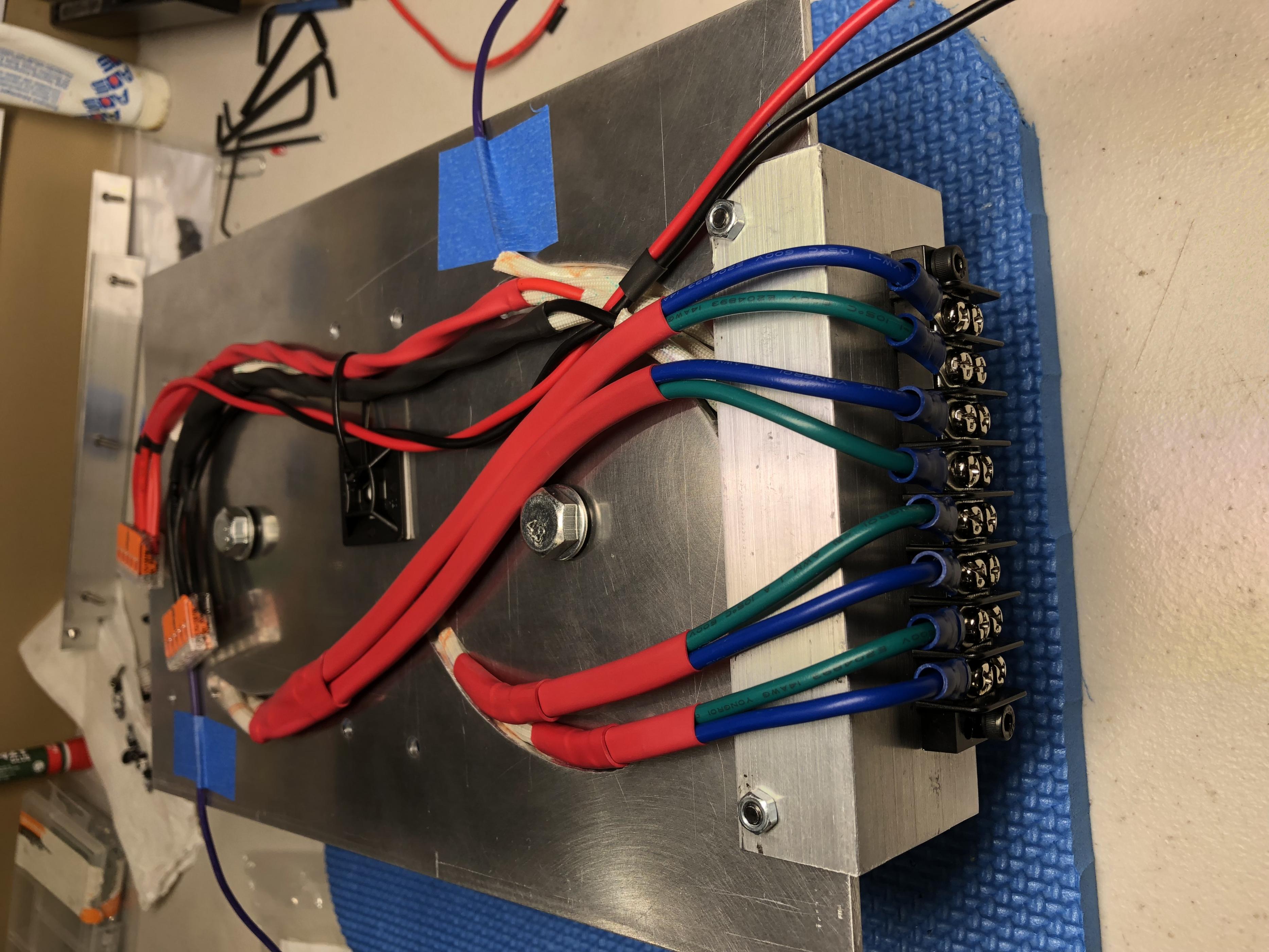

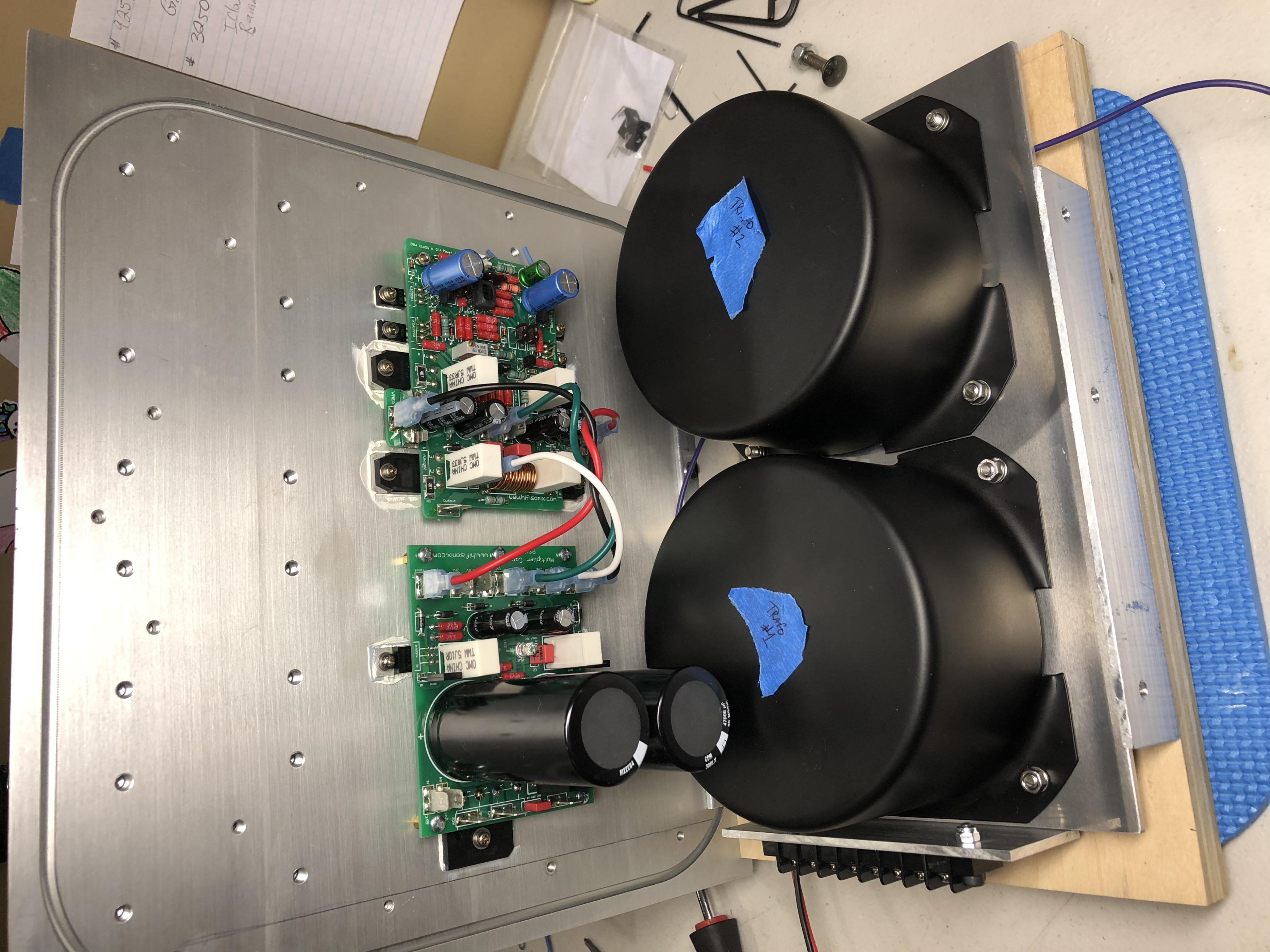

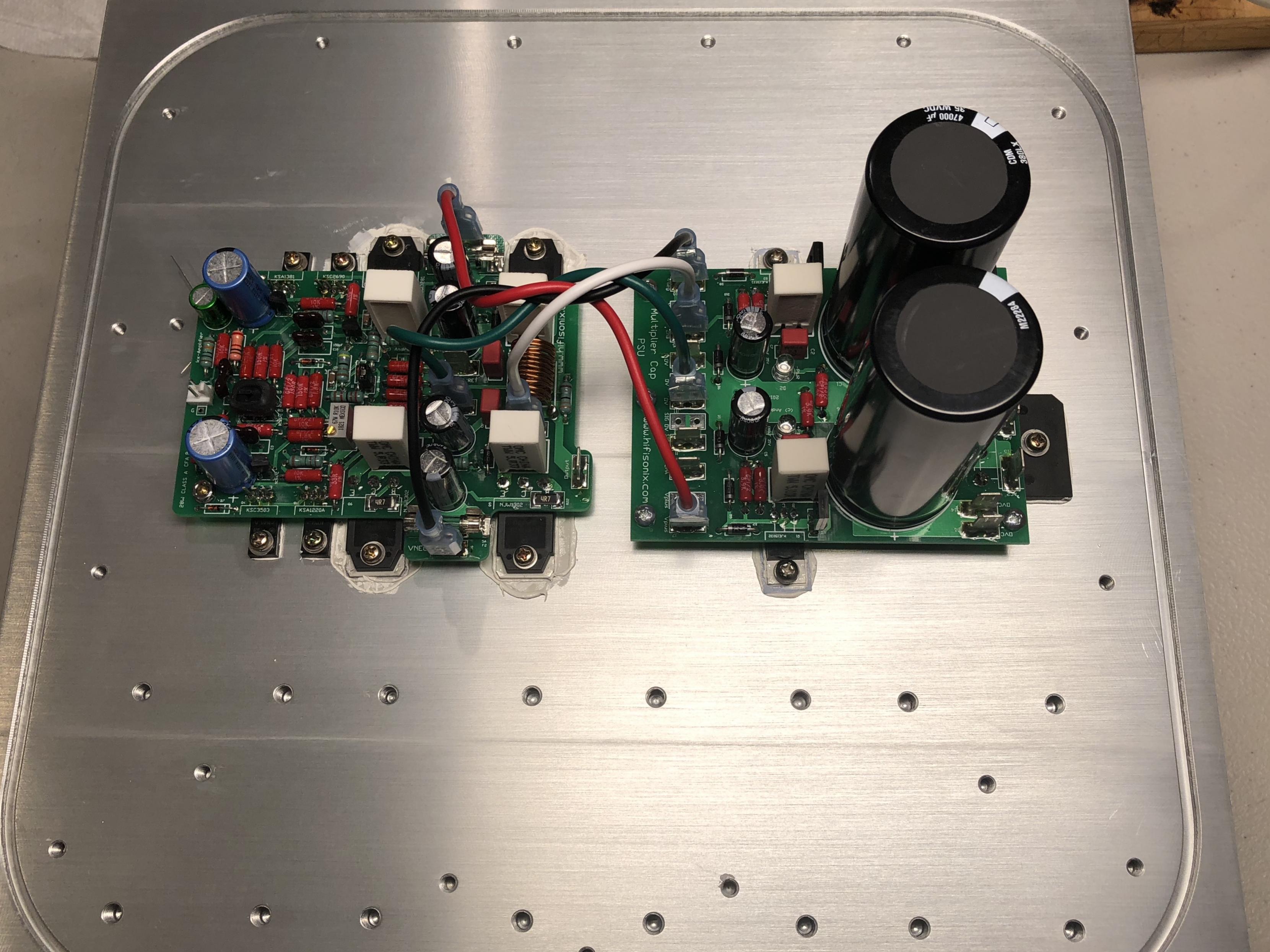

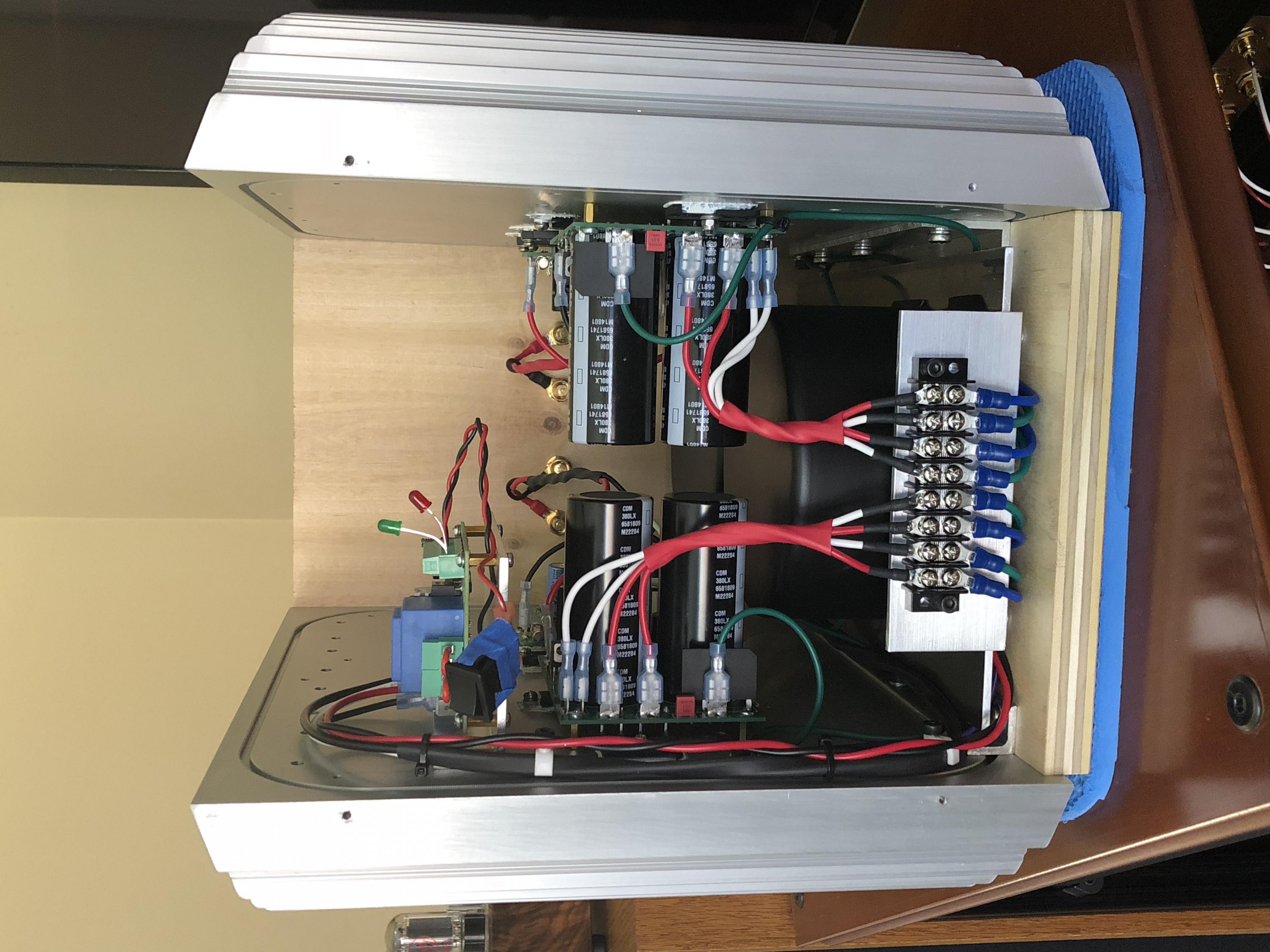

Hello Bonsai!! Your timing is impeccable, I’m so glad you started this thread for the KX amp. My build is almost completed, the Walnut wood top and front panel need to be fabricated along with placement of switches. In the meantime this newborn is singing away!! Here are a few details: Pair of Antek AS-3224 transformers w/covers Pair of Ripple Eater psu’s This combination gives me final voltages of -28.5vdc/+28.1vdc loaded. The dc offset varies from -5mV to +5mV when the KX is at operational temperature.
The reclaimed heat sinks are large enough to mount both the psu and amp board without a problem keeping the heat dissipation under control even when running at the high side of 28vdc. I do not have experience with your other amplifiers (SX/NX) so unfortunately I can’t compare to them. In my short listening time, the soundstage is very impressive. Music seems to flow from well outside the speaker “box”. The bass is very solid and articulate. Definitely not an amp that should be cranked up in an upstairs apartment, the downstairs tenants might think a thunderstorm is approaching 🙂
On my test bench, the speakers are low efficiency 4ohm bookshelf type. I couldn’t hear any hum/noises. Now, I have the KX in my main rig paired with very efficient 8ohm floorstanders and there is a slight hum that’s audible. I’ll have to get that worked out. Thank you Bonsai for sharing a wonderful amplifier project, I’m really going to enjoy this one.

I can build the amp but can’t flip the pictures, I apologize.

Wow - quite a build Vunce!
Trust it goes well and you'll have it up and running shortly. Once you have finally wired it up f you still have noise issues we can sort it out. Remember to twist the power cables from the transformer to the PSU board, and from the PSU to the amplifier boards. Same for speaker terminals to amplifier boards. Keep input cables well away from power supplies and associate wiring.
Vunce,
Impressive build, congratulations!
Those heat-sinks look like they mean business 🙂; love the clean layout and wiring, well executed. The chassis dimensions and red glow remind of high end gaming rigs!
Schaffner FN 9244B IEC inlet filter
Vunce, I can see a RF/EMI IEC inlet filter in your DIY. Which?
Years ago I was researching about it and those who had better specifications were those manufactured by Schaffner, and by far. I have a few in my two systems.
Schaffner FN 9244B 3A
