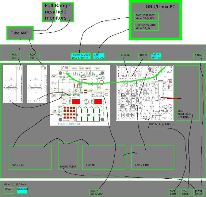

I don't know much about eletronics. I'm simply a Synth DIY builder and user for ~3 years now, and a Linux Audio User since 2002. I am using as a Jack Card a RME HDSP9632 and a Card Zoo of other Alsa Devices to plug & sync to the Jack Audio Server a couple of Beis AD24QS via Alsa_In, for monitoring and pre-mix / virtual summing applications. I'm very enthusiastic about the State of Art Sound from Linux Audio in conjunction with the Cirrus Logic Flagship A/D - D/A Converters. A Alsa_In example: http://demosynth.dyndns.org/files/beis/JackServer.png ...The beauty of Linux RT or Low Latency & Jack Audio Server is the removal of the Jitter caused by the OS.
Soon I would buy & try this nice board!

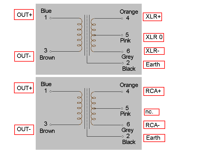

Therefor I am thinking of trying this DAC board, first without the Output Transformers. Yet I do not understand whether the 1K min. load is needed also through the Caps Out?
In case I do try the Sowter 3603, could someone please explain to me a wiring example for the Secondary to the >1Kohm>RCA? ...is this tansformer suited for XLR Balanced Connections? (Pins 4, 5, 6, 2) http://www.sowter.co.uk/conpics.htg/3603.gif
I've obtained these answers from Sowter and Lundahl companies:
According to the data sheet this is a voltage out DAC. The output impedance is ~120 ohms and it should be loaded with not less than 1k. The level is ~7V p-p max.
Our type 3603 would be very suitable for this. You will need to use a ~1k resistor across the secondary to ensure the DAC sees the correct load.
However, LL1690 is an input transformer with a certain copper resistance. For your type of application I would normally recommend the LL1527 or LL1527XL. These transformers performs very well with most DAC boards and chips.

Really, nobody can explain to me how to try wiring the pins 4, 5, 6, 2 of the Sowter 3603 output transformers?
I need to know another very important thing, in order for me to expand the monitoring ADC Inputs on my System... Could it work simultaneously on this Board the Toslink or Coax Input and the USB Out?
In this case, which way is possible for me to make the internal connection with the ADC/ Coax Optical or both?
If it worked, I'd be very happy to be able to connect two more analog inputs... The internal Coax connection was perfect to maintain the a external Toslink Out from the ADC... If this USB Alsa Device is recognized with another Device-Name (arecord -l) than the miniStreamer, two times as happy for 2x more analog inputs possibility, seeing that it is impossible to use more then once same chipset or device (alsa device number ordering configuration for the usability: /etc/modprobe.d/alsa-base.conf).

And the USB part has SPDIF input on board, default connected to the TX(pin21)of WM8805, through R6 on the bottom side, that means you can use the record function when playing. May be you can do some solder work to make it works as you mentioned.

Hi, puredyne. I saw the green wire in your picture, and it's ok if you use the input1~2, the signal will come out from DAC and USB to PC at same time.

There is differential output connector on board.😉
Hi, may be you can try this connections.🙂
Is there a specific model of transformer that is highly recommended at reasonable price?
