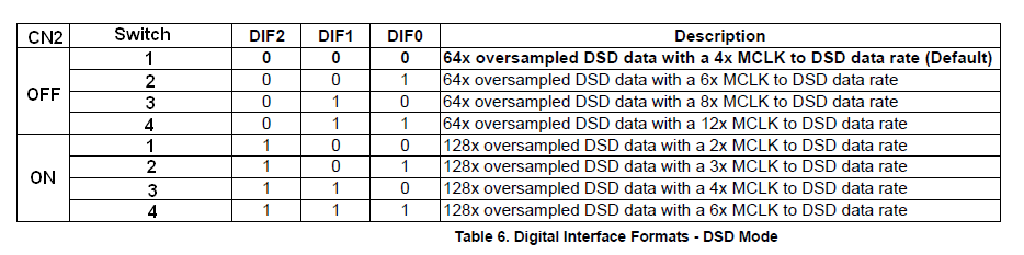

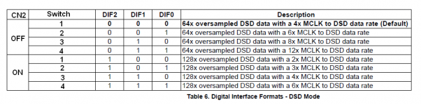

DSD mode settings
Hi, we use the small switch board to set DSD over-sampled rate. State list bellow.
