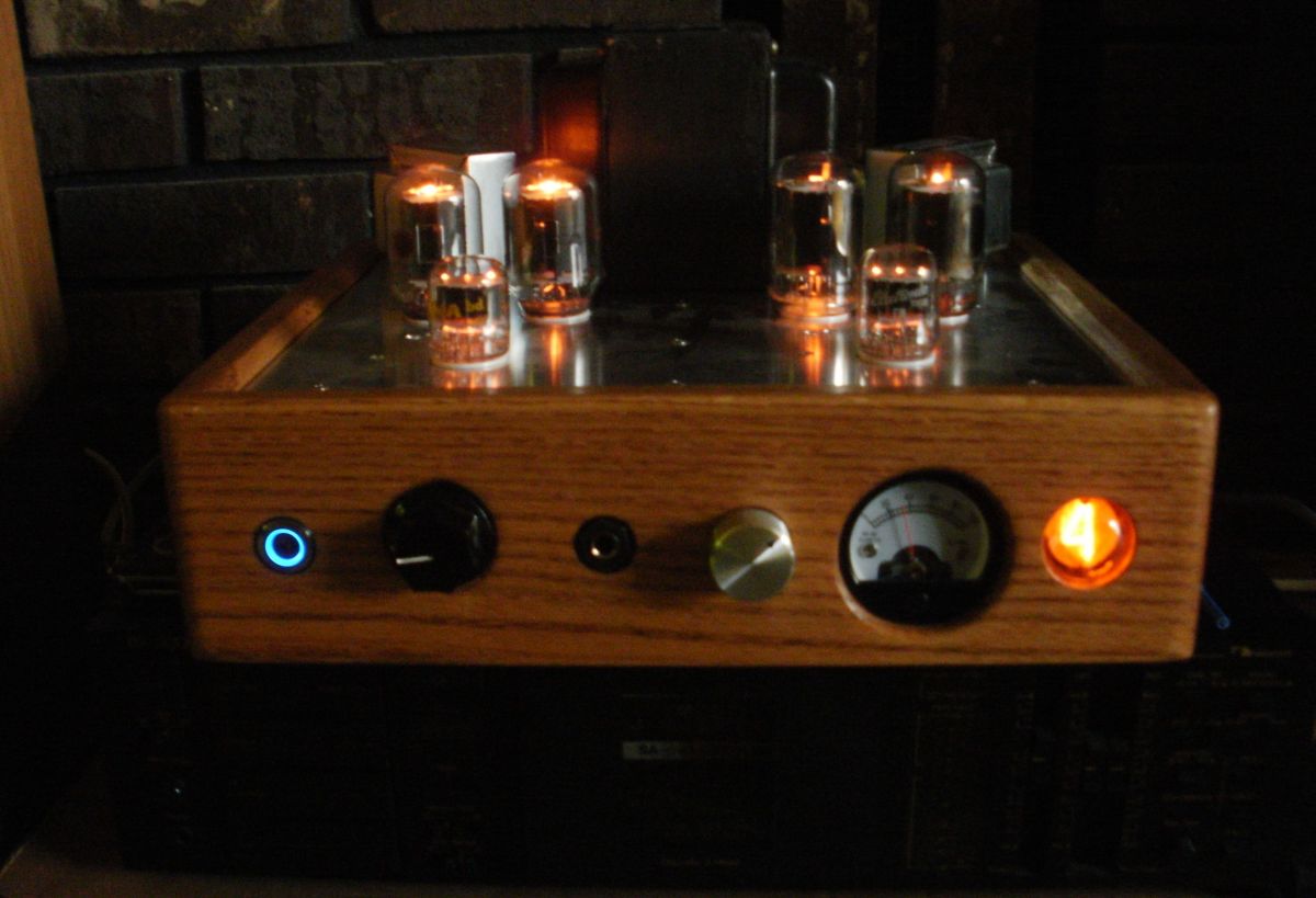

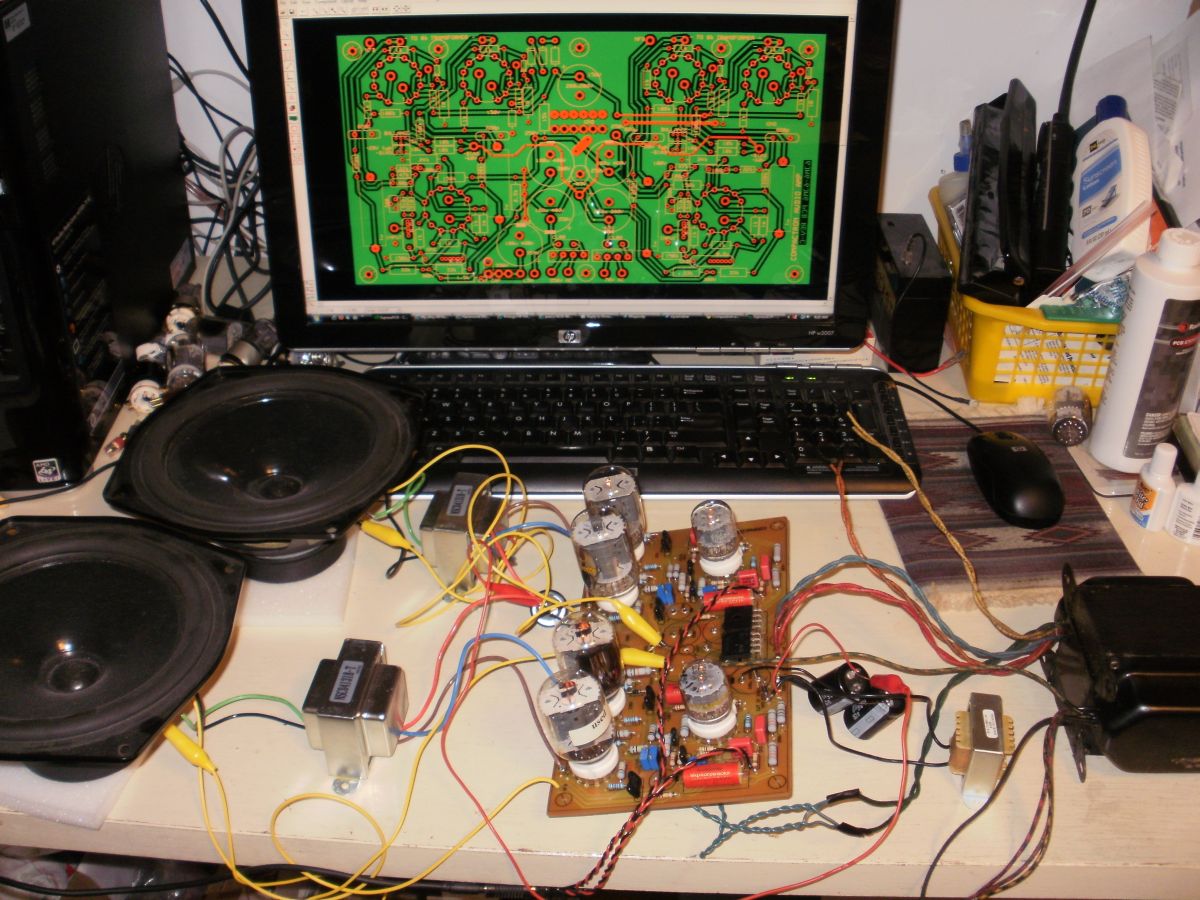

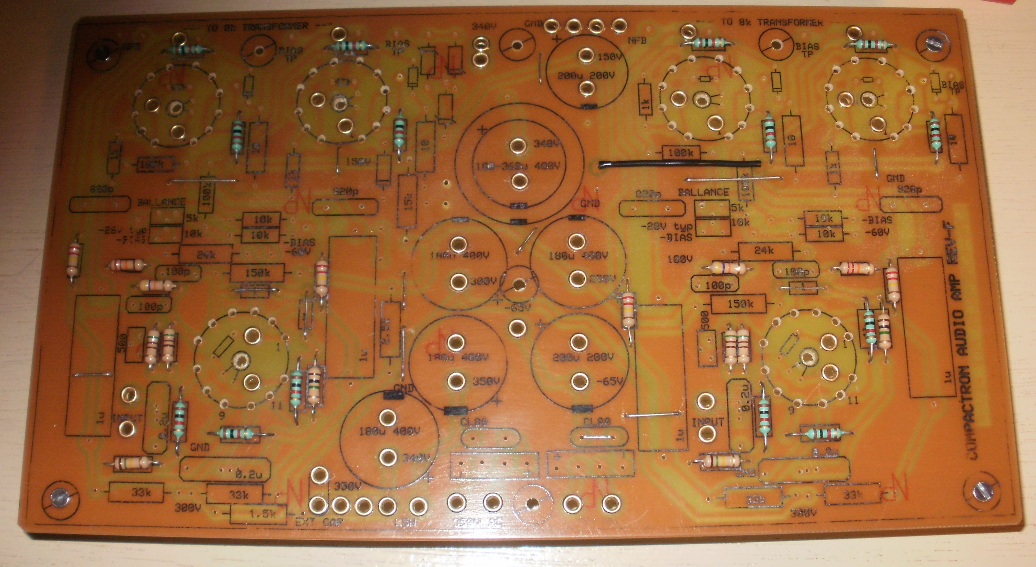

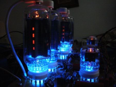

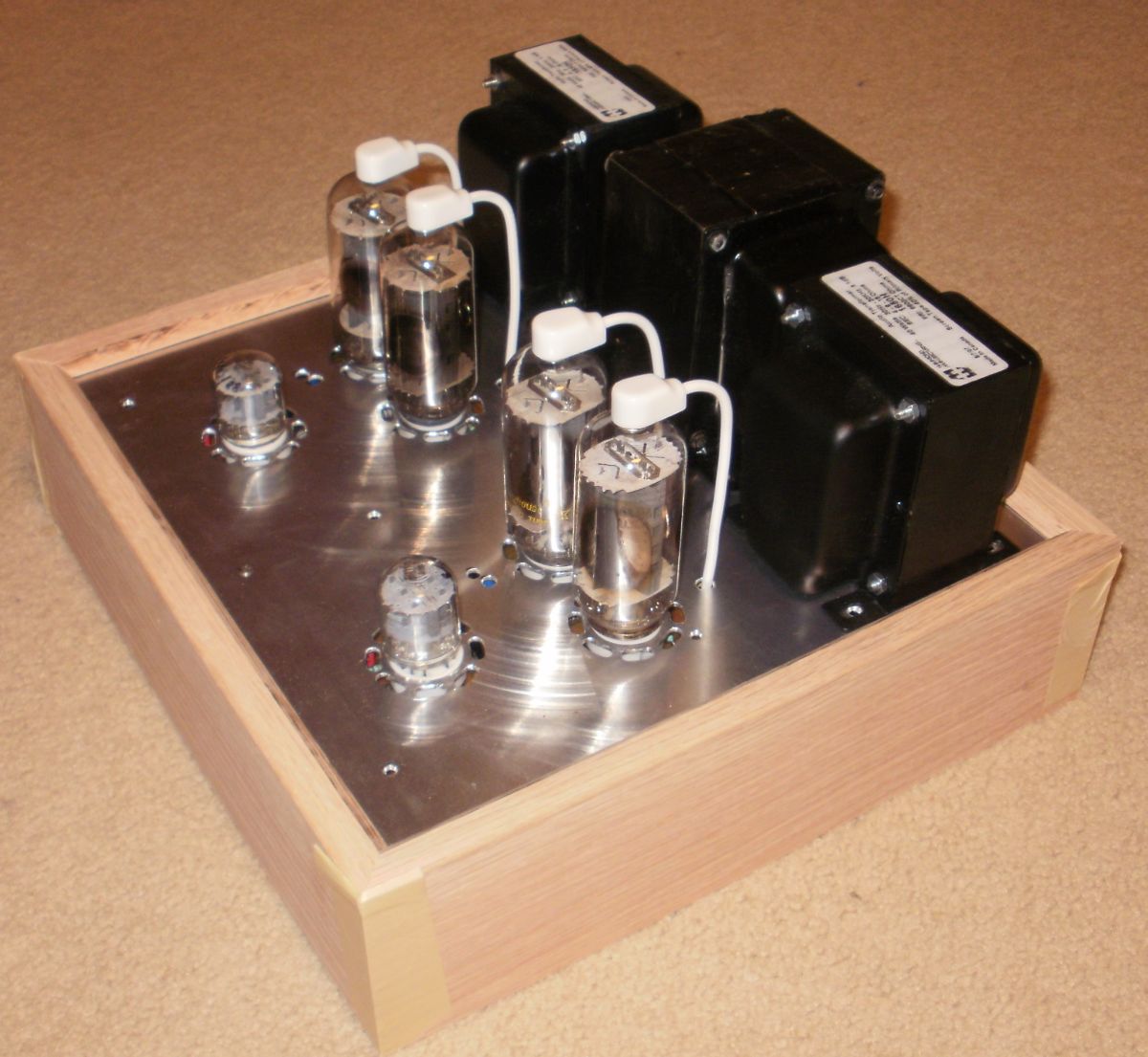

How about 20 watts /channel and simple to build, fantastic clarity and sound stage.... inexpensive output transformers about $45 for the set, tubes are about $4 each, power transformer was about $30 delivered, Sockets were $2.50 each, 400volt and 200volt caps in the power supply. Home brewed PCB with feed through eyelets for mounting the caps on the back side, on board power supply for B+ and adjustable fixed bias to allow for using mismatched tubes if you want. Inexpensive oak frame with a .080" 12"x12" alum top plate. Most online shops have 12"x12" standard size sheets.
Turned out to be a stocking stuffer at Christmas, the elves were very sad to see it go, had to build one for the workshop.....
Can be upgraded to 60watts/channel by larger output transformers and a new set of output tubes.
Working on the second one for 40/channel by upgrading the output iron, the third design will be 60 watts/channel with the larger output tubes and a bump in output iron.
