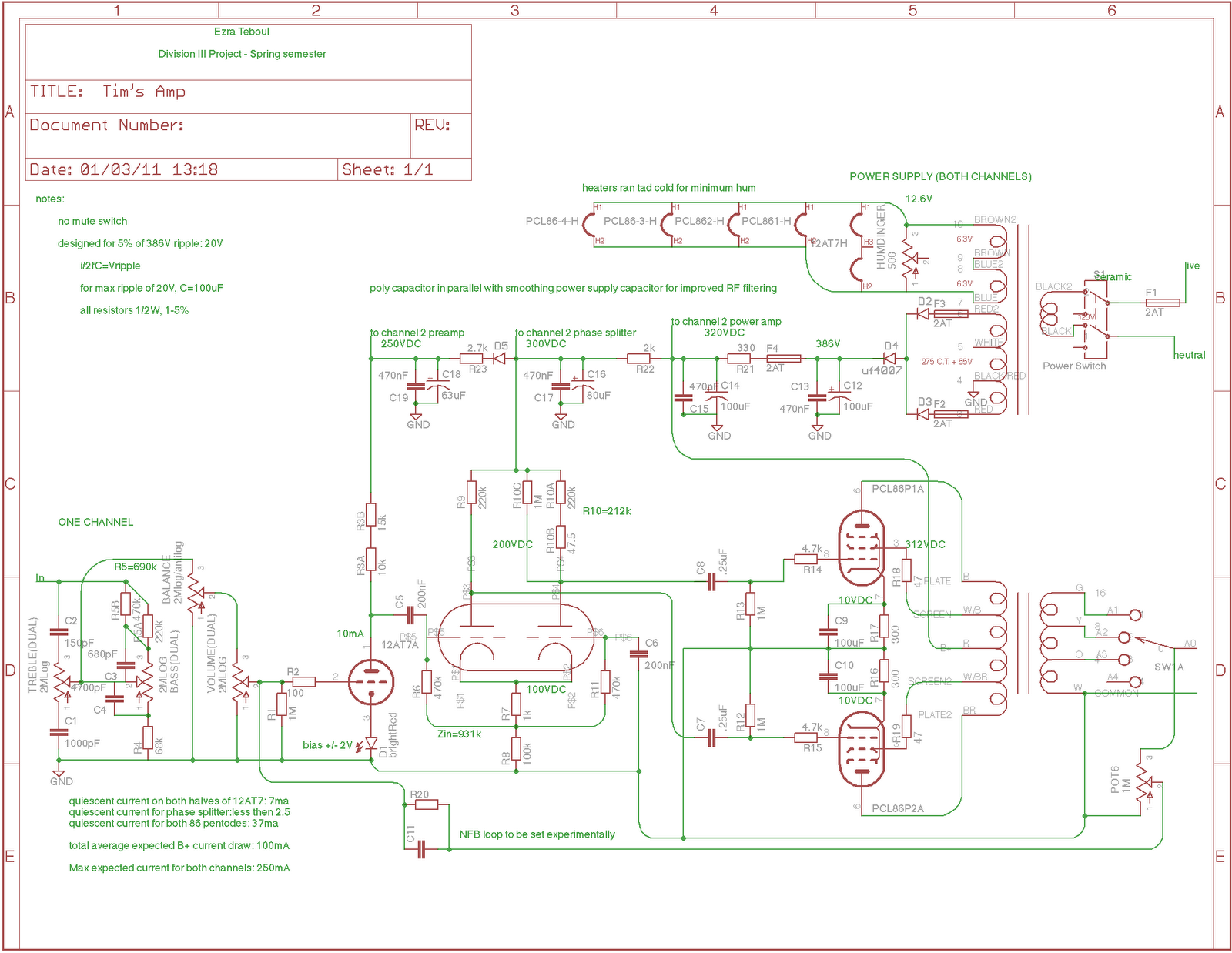

I'm going to pick tubes and figure out the schematic for that compactron push-pull power amp tomorrow. Once that's done I'll post that here and figure out what kind of preamp would be best to drive it. If time allows I'll still try to design and test a triple parallel triode preamp stage for it, but in the meantime I guess I'll just stick to something in the vein of the Mullar 5-20 ef86 preamp topology.
Again, I'm learning things here. Apologies if I have randomly strange ideas.
Ezra
After some inspiration from the mullard 4-10, it seems like the pcl86 (13V heater equivalent of the ecl86 - cheap, available) could be a pretty good bet for the power amp. Thoughts?
If no opposition/roadblocks appear, I'll be making a schematic for this, picking a precise OPT and moving on to find an appropriate preamp tube.

Uploaded it to my own website:
https://lh6.googleusercontent.com/-...AAAAAASs/I6i5k_mN20g/s1600/Schematic+V0.2.png
Please let me know if that works.
Much better, especially when using the zoom key.
A couple of comments....it appears that you went a little fuse happy in the PS......one on the mains should do the trick, no?
Consider a choke in place of R21 if budget permits ($15)...and possibly bumping up the value of C14....these will reduce ripple...have you modeled the PS in PSUDII?
Also consider bypassing D2 and D3 with 10nf/2K ceramic caps to reduce switching spike noise.
Since you have a handy 50V bias tap, have you considered fixed bias?
If you are concerned about RF filtering, consider one of Eli's "hash filter" stages in the PS, ie an LC stage with a 1.5mh choke ($2) and a 1000pf cap.
I have no idea what D3 does, but then again I'm also a semi-newbie.....
Did go a little fuse-crazy here. I was following Blencowe's recommendations in "Power supplies for tube amps" and ended up with that.
That, just like a choke in place of R21, will depend on whether or not I get a grant for this project from my school or not.
I didn't do any PSUDII stuff because I don't have windows, but I can have access to it - thanks for suggesting that.
Fixed bias wasn't really considered for the sake of simplicity and costs. Do you have any strong arguments for this specific design? Please do share if that's the case!
Eli's Hash filter sounds like a great idea. I'll add it if I have RF problems.
D3 is half of the two phase rectifier, which I believe is fairly classic (please correct me if I'm wrong). Did you mean D4 or D5? D4 is a "UF4007" fast switching diode to fix the switching noise of the two phase rectifier diodes (D2-3, which I guess is why I don't have ceramic caps bypassing those), and D5 is a way to make the preamp's B+ cleaner (both D4 and 5 are recommendations from Blencowe's "Power Supplies" book).
