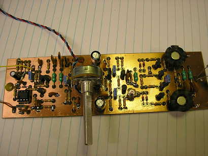

Attached below is a picture of the first completed board – the AM modulator and line driver.
The board accepts a 1.8MHz carrier from a buffered switched crystal local oscillator, a 1V peak audio signal for 100% modulation and can drive a spectrally pure 500mW PEP carrier into 50 ohms, which is more than enough to drive my transmitters pre-driver stage.
The line driver stage is a diamond buffer circuit (as used in a few audio opamps) preceded by a rather linear symmetrical VAS loaded with a low-Q tank circuit and followed by a 5 pole 2.2MHz LPF for harmonic attenuation.
The mixer section, which does the actual amplitude modulation of the carrier, is a discrete differential BJT pair driven into saturation (like in a MC1496) by the carrier signal, with the tail current being modulated by the audio signal.
A 5 pole LPF immediately after the mixer kills the harmonics generated by differential switching.
A TL071 opamp wraps up the tail current source BJT, so the modulation is highly linear.
The pot on the PCB is a carrier level control, which sets the line output carrier level and thus the transmitter power.

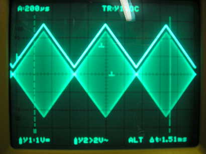

And here is the output signal, driving 500mW PEP into 50 ohms - carrier modulated 100% with a triangle wave to show off the linearity.

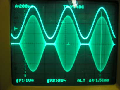

And lastly, over modulation with a sine wave. The modulator over modulates very cleanly with no funny behaviour.

Cheers to you Glen, that linearity is insane for not only zero-rf-detected-feedback, but low-level AM as well!
