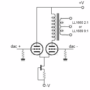

Only using one leg of the LTP, no even harmonic cancellation ?
Current out DAC driving a low value resistor as passive IV ?
Patrick
Patrick
