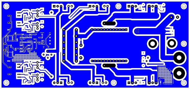

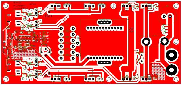

this is what i have so far.. there are a couple of thins i want to touch up
bottom
no i haven't gotten them yet. i got the feedback fairly stable. but i seem to have bad ground looks and radiated stuff running around at higher currents....so.. i thought i would put some stuff together and try it with a better layout.
and when i get them back, i am going to parallel them and run them at current each driven i think in master slave or from the same out put and sense the total power..........
we'll see how much smoke and fire i can make:hot: :hot:

Jimbo,
Boards look nice.
