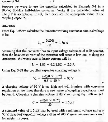

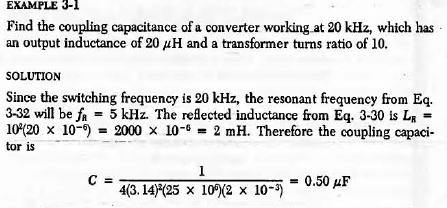

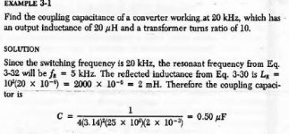

dc blocking cap
so...
what would be a good way to determine the size for the cap in series with the main transformer?
to handle the current?
i have 4, 0.1 @ 600V non polorized in parallel...
so...
