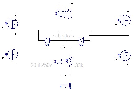

Here you have a couple suggestions...
Transformer gate drive with buffered turn off:
Use fast high current small signal transistors like BC327 or BD140. The 1uF capacitor has to be low ESR and not polar. The diodes may be replaced by Schottkys like 11DQ6.
Full bridge snubbers:
There is a center tap in order to grant symmetric switching, that may help to cancel common-mode EMI depending on how the transformer is wound. By the way, if the bridge is operated properly and the RC across the primary winding provides enough damping to prevent the "second bounce" due to leakage inductance resetting after turn off, then you will no longer need to care about body diodes
Component values are only for reference and have to be tuned to each particular application. RC networks are intended to tame a particular tank circuit resonating at a frequency F, and optimum values usually satisfy the following formula: F=1/(RC) where R is chosen to be the highest value that produces reasonable damping. By the way, I assume that you own an oscilloscope.
Note that SMPS is a bit more critical than 50Hz switching. Concerning IR211x they are fine, I have used them without problem in circuits switching high voltages quite fast, all what they require is careful layout because PCB parasitistics can produce unexpected voltage drops and currents that could blow the IC by exceeding its ratings. Indeed, in SMPS you will discover that everything is full of unexpected voltage drops, currents flowing where they shouldn't and unexpected tank circuits resonating at several Mhz made out of PCB and component parasitistics.
Enjoy 😉
Enjoy 😉

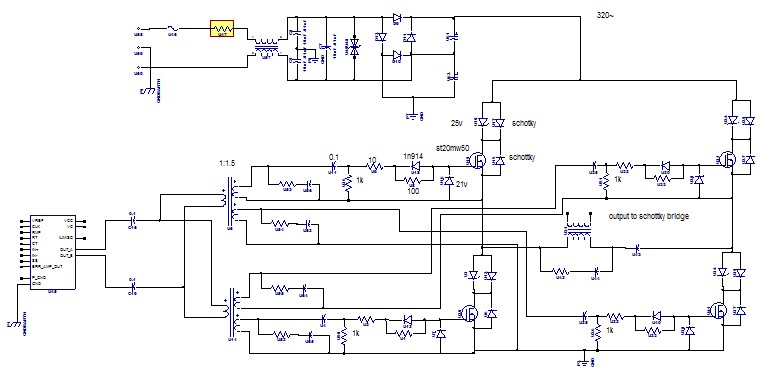

Jimbo,
I have not read this thread too thoroughly so forgive me.
Anyhow I looked at your last schematic, why do you have lots of diodes around all switching FET's??
If the bounce is MORE than the rails voltage of 320 Volts it wont be clamped because your diodes prevent the intrinsinc FET diode to clamp the overshoot.
Also you have more switching losses with these diodes and they cost money, make no sense to me.
Cheers Michael
