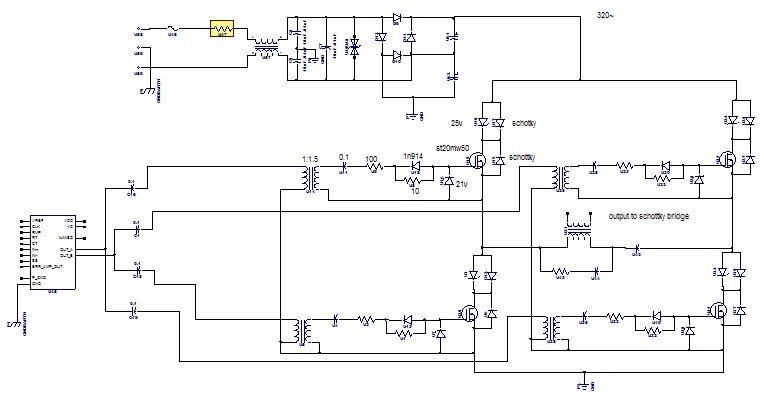

jamesrnz said:steve,
i found the pfc schematic i was looking for. it was posted be cocoholic.
i sent him an email with no answer back yet.
i have attached his scchematic.
and was wondering why the 1n5407 across the boost inductor?
jimbo![]()
Eva said:The diode across the boost inductor is only employed during startup. It prevents excess energy from being stored in the inductor and then dumped back to the output capacitors, as too much energy is likely to be transferred, thus causing an overvoltage condition.

This diode can only partially avoid the start up resonance and eventually overvoltage. The effect which Eva describes is not only caused by the chokes in our circuits. The chokes in our circuits cannot store much energy due to saturation effects. The energy from them will normally just cause minor overshoot. Unfortunately the mains also has an inductance, which can store huge amounts of energy and cannot be bypassed by a diode. Especially with a soft power line and unpleasant phase angle of powering up - there can happen a remarkable voltage overshoot at the output of most boost converters. Hard powerlines are less critical because the resulting Q of the undesired resonance is lower then.
(In anddition to this overshoot, some topologies are suffering from some 'self made' active overshoot, caused by unfortunate regulation behaviour.)
There is another reason for me to put this diode.
Our power lines do show impressive voltage spikes once and a while. They can cause stress and defect to the MosFet. The diode across choke+PFCdiode is clamping such overvoltage surges vs the output caps, which can absorb quite some energy without excessive voltage change.
In European immunity standards there are surge tests with 1kV(symmetrical) ... 2kV(unsymetrical) defined. ...some 9uF cap charged to that voltage and then coupled with some single Ohms to the input of the unit under test, which is driven by a line with standardized impedance...

well,
i have found that in the full bridge that i iam blowing one of the pairs apparently due to some thing turning on the opposite pair.
some things.
i am using gate drive with zeners caps and transformer. simple.
i read about fets on the same heat sink can cause turn on of the opposite pair.
i wonder if the turn on is caused be the toriod interfering with the 33025.
i wonder if the schottky output bridge is causing problems, i donthink so.
jimbo

Your problem is related to poor gate drive. Please show us a schematic or tell us exactly how you are doing it.
Jim,
R U using separate xfmrs for each MOSFET? Is there a way U can put two MOSFETs to a common driver transformer, or maybe drive all four from one core, or are these drvr xfmrs off-the-shelf parts?
Your gate drive is all wrong. The 10 ohm and 100 ohm gate resistors must be swapped with respect to what is shown in the schematic. Also, a DC bleeder resistor (say 1K) must be connected in the secondary side of each gate transformer, between the right leg of the 0.1 capacitor and the lower leg of the winding.
Note that you could do it better with a single gate transformer with 4 secondaries and a single primary connected between OUT_A and OUT_B. Adding turn-off buffer transistors to each gate drive cell would be another great improvement.
