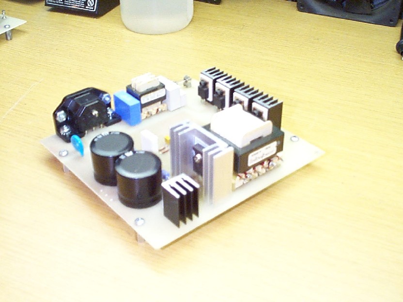

What's the Frequency?
Jimbo,
Forgot to answer your other question: 83.3kHz (Osc) 41.6kHz for the transformer is OK, but you ar egood upto a couple of 100kHz before core losses become significant.
I finally dug up the equation for the frequerncy:
F(osc) = 1/[C(t) (0.7R(t) + 3R(d)], where R(d) is the deadtime resistor between pins 5&7. Mostly this is zero, but can also be 100 W/.
So say, for R(t)=2.21K, R(d)=0, and C(t)= 6800pF, your clock frequency will be:
F(osc) = 1/{0.01E-6 x [(0.7 x 2000) + (3 x 0)]}
= ~95kHz, or 47.5kHz on the transformer.

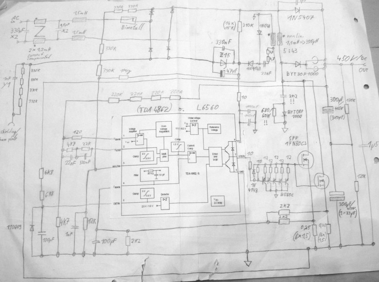

i found the pfc schematic i was looking for. it was posted be cocoholic.
i sent him an email with no answer back yet.
i have attached his scchematic.
and was wondering why the 1n5407 across the boost inductor?
jimbo :cuss:
The diode across the boost inductor is only employed during startup. It prevents excess energy from being stored in the inductor and then dumped back to the output capacitors, as too much energy is likely to be transferred, thus causing an overvoltage condition.
