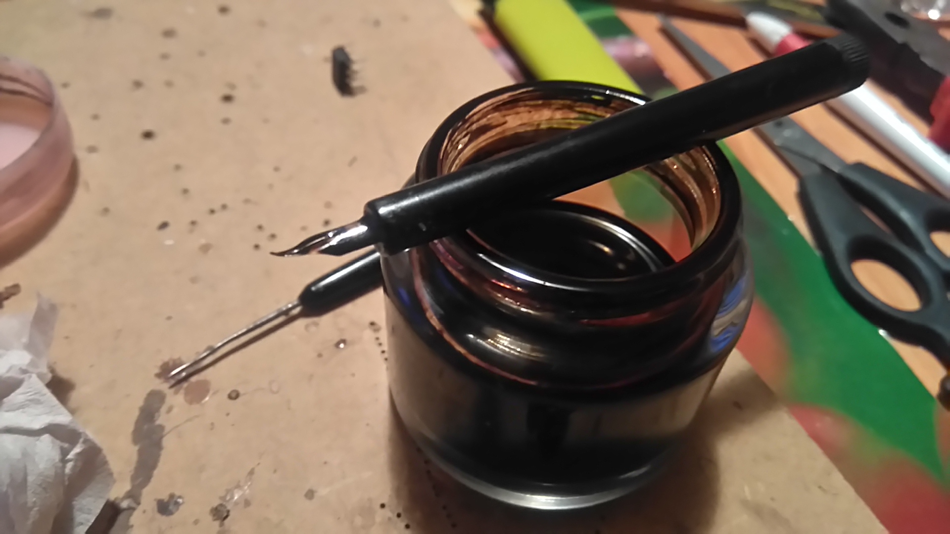

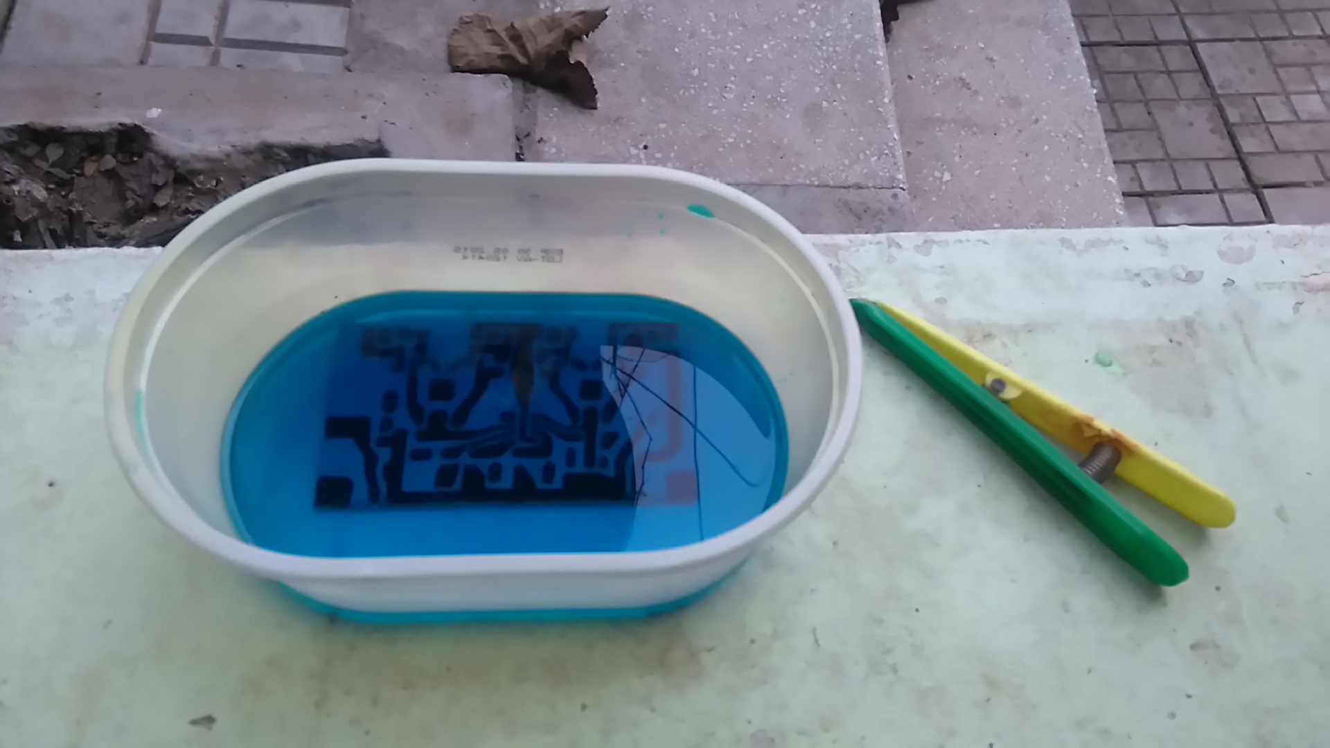

Yes Im 20 😀, I saw usually people print the pcb ( actually pcb means printer circuit board...) than put the paper on the board heats it, than wraps the paper in water so the black ink remains on the board..
My printer died...so I do it with " tar, pitch..I dont know how is it called in english,) and a pen like this one
I was also 20 when I built my first amp, the one that oscillated. I remember I was impatient and enthusiastic and made a lot of mistakes. Now it's your turn to do all those mistakes. 😀
in english, just say "permanent ink magic marker" 🙂
wow, that brings back memories Bruno. I am LONG past 20 🙂 back then, i did it with very solidly black ink magic markers. i found at the time that a statedler lumocolor no. 317 black marker was far and above the best marker for making fabulous quality patterns for pcbs and i never had to retrace. i see they still make them and they are even refillable! i wonder if the ink is still the same ....

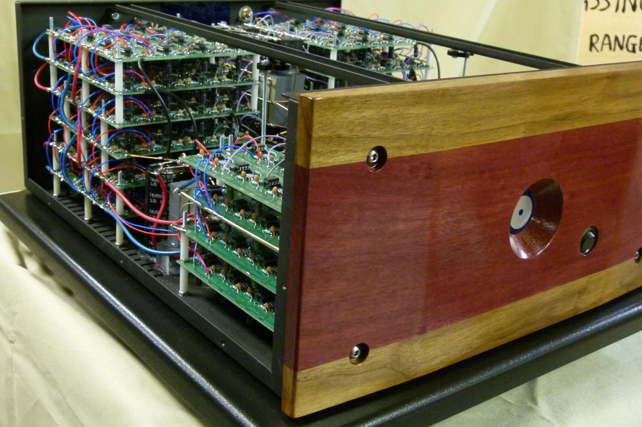

I'm another person who has discovered the benefits of deep NFB and a few more transistors. My TGM8 amplifier sounds much better than my simple ones.
http://www.diyaudio.com/forums/solid-state/245619-tgm8-amplifier-based-rod-elliot-p3a.html
That TGM8 isn't that complex. In par with the old AKSA amp? It is regarded well sounding.
Perhaps the sugjectivist amps and the more THD focused amps tend to have different virtues? A short, moderate NFB may give the amp a sound that lets you absorb the music and sink deeper into the sofa. A bit introvert.
The THD optimized ones perhaps gives you a more stringent feeling - the one that makes you sit right up in the sofa an exclamate: "This is seriously good stuff".
