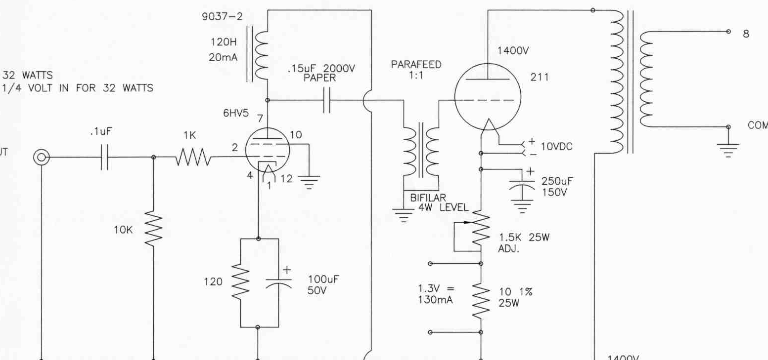

It might of interest to some users if you can post the schematic of your amplifier.
Base schematic driver 6HV5 tube 211, Gm70, 845, 813
Andrew polskihiend
My new Gm70 OVERTURE work 1000V plate 125mA current with tube biasing regulated, or 1200V and 100mA.

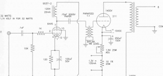

Second schematic 2 stage amplifier choke loaded.

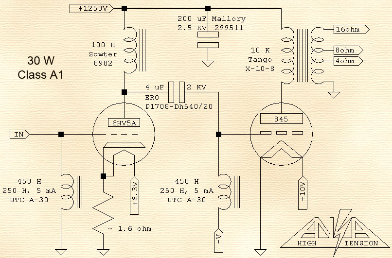

Nice 8Hz resonator. A grid resistor at least would damp the resonance. Bad design, IMHO.
A good grid choke + a good plate choke + 2.5KV 4uF quality cap are not that cheaper than a proprer interstage.
It Is not my design.....design HIGH TENSION.
8Hz in audio its nothing for good quality speaker 20Hz to 20khz
Good choke and good cap quality only.

A resonance is resonance. 8Hz resonance will nicely couple with PSU resonance in the same range, especially in SE amplifiers, and also shows its effects well into the audio range, most of the bass, with a rather reactive load. A proper transformer is miles better.It Is not my design.....design HIGH TENSION.
And so?Im not GREEN! work 20 years with tube amplifier repair, upgrade AUDIO NOTE, CARY, AYON,LUXMAN and many many brands.
Good for you but it doesn't turn that design from poor to good. As I said you only need to remove anode and grid chokes and the coupling cap. Replace those with a good transformer. Measure it and listen to it and you'll see.
You can try with a Lundahl LL2756 or LL2762. Both are suitable for 5K source impedance. You can also optimize the air-gap for best combination of DC current and primary inductance. If the plate choke has much more DC resistance and you want the same anode voltage then you can add another RC filter before supplying the driver. It's easy. With 20 years experience you should be able to do it....
