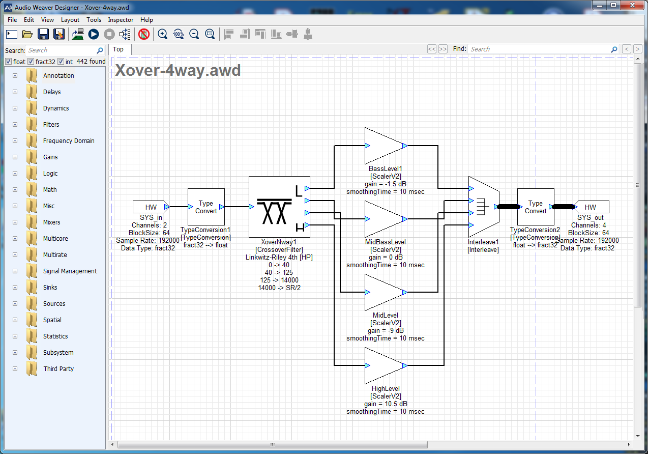

It's nearly two and a half years since I originally set-up my Ultimate Preamp as a 3-way system.
Tomorrow I'm trialling it with a 4-way system, replacing a fancy preamp and Accuphase digital crossover and I need to re-program my Ultimate Preamp.
I'm fine with the software and uploading etc.
However the Accuphase is currently set to 40Hz, 125Hz, 14kHz with levels -1.5dB, 0dB, -9dB and +10.5dB.
The 125Hz to 14kHz unit is a high efficiency full-range driver and yes, the super-tweeter is very inefficient.
I seem to recall advice to set the Ultimate Preamp to a maximum of 0dB (for which I would program -12dB, -10.5dB, -19.5dB and 0dB) but can't find the reference anywhere.
Can anyone point me to the original 0dB recommendation and does the " -12dB, -10.5dB, -19.5dB and 0dB" program sound OK?
Thanks!

I modded the basic four way design on our website and include a scaler in the bass channel so you can customize the levels to what you want. If you want the awd file let me know as I can't seem to attach it to this post 😉
regards
david

The one on the web site looks unchanged but I can replicate the script in your image.
Thanks very much!
