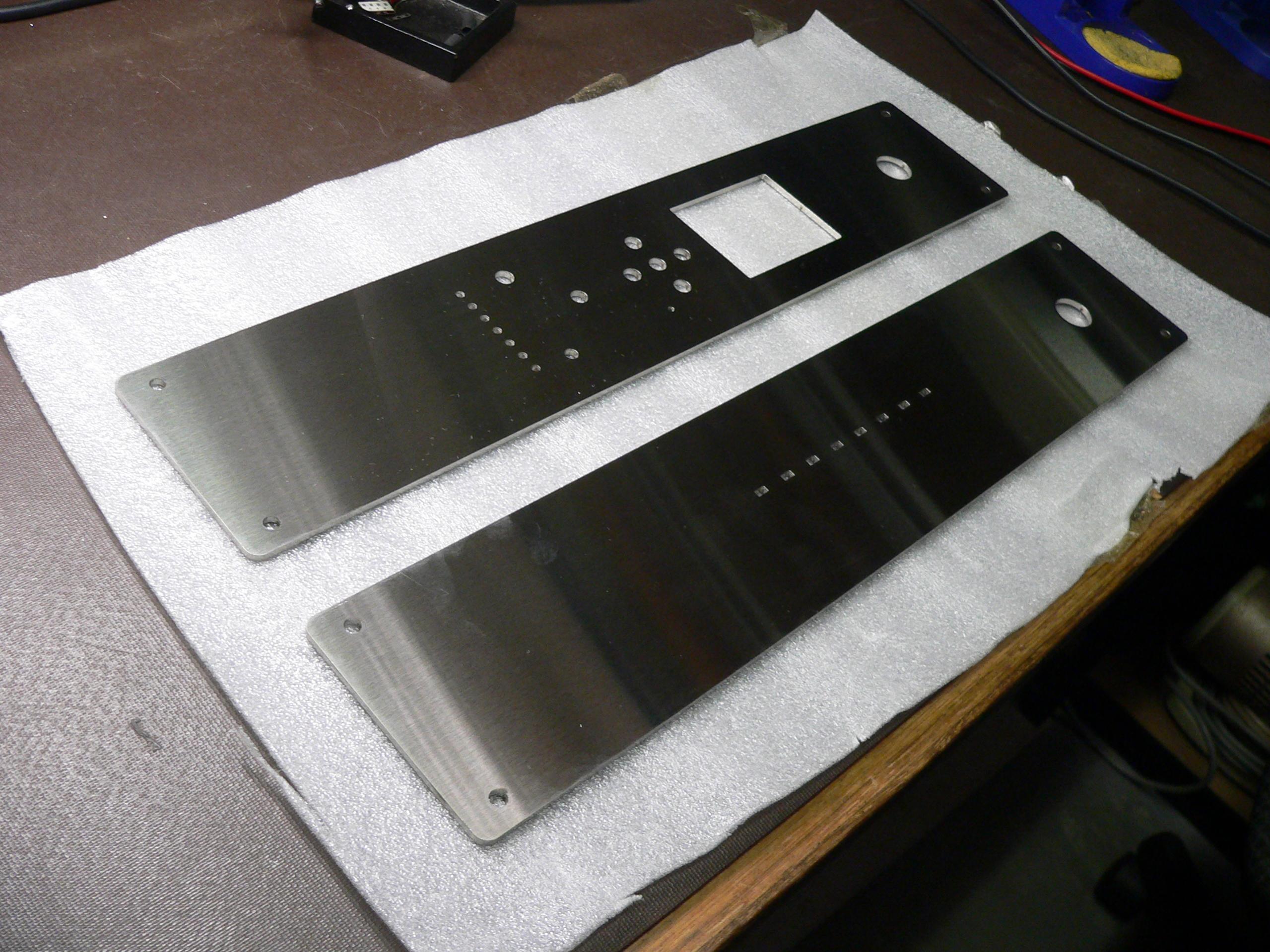

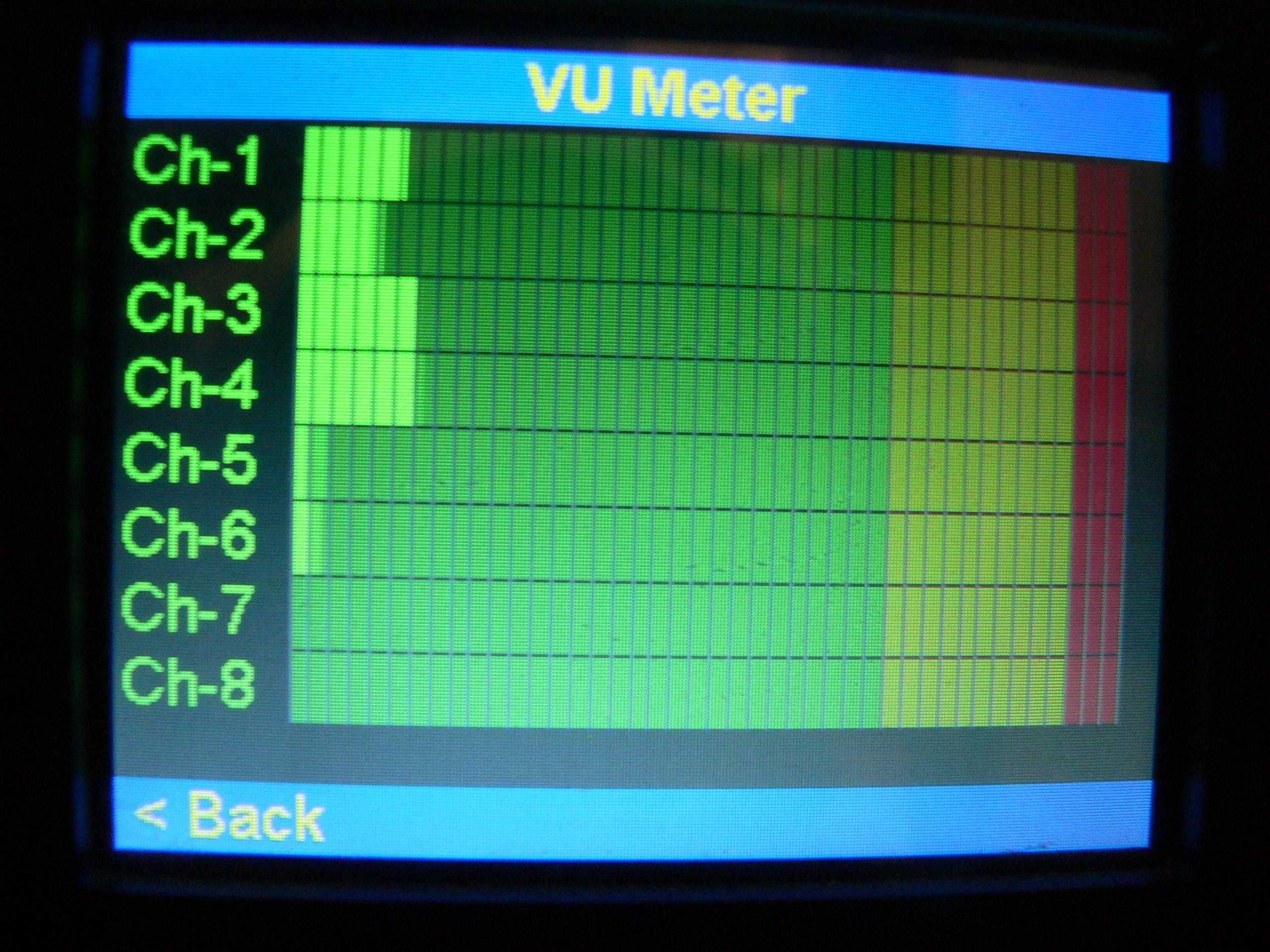

We did not skimp on the case. Most vendors, even high end ones just use powder coated folded sheet steel cases. Our case is a custom designed with 3 mm thick black anodized aluminium panels and 3 mm thick micro brushed solid stainless steel front panel as shown below with the front panel for the matching multi-channel amplifier 😉
Also no need to for VU meters. We have already implemented this in the firmware for display on the LCD 😉

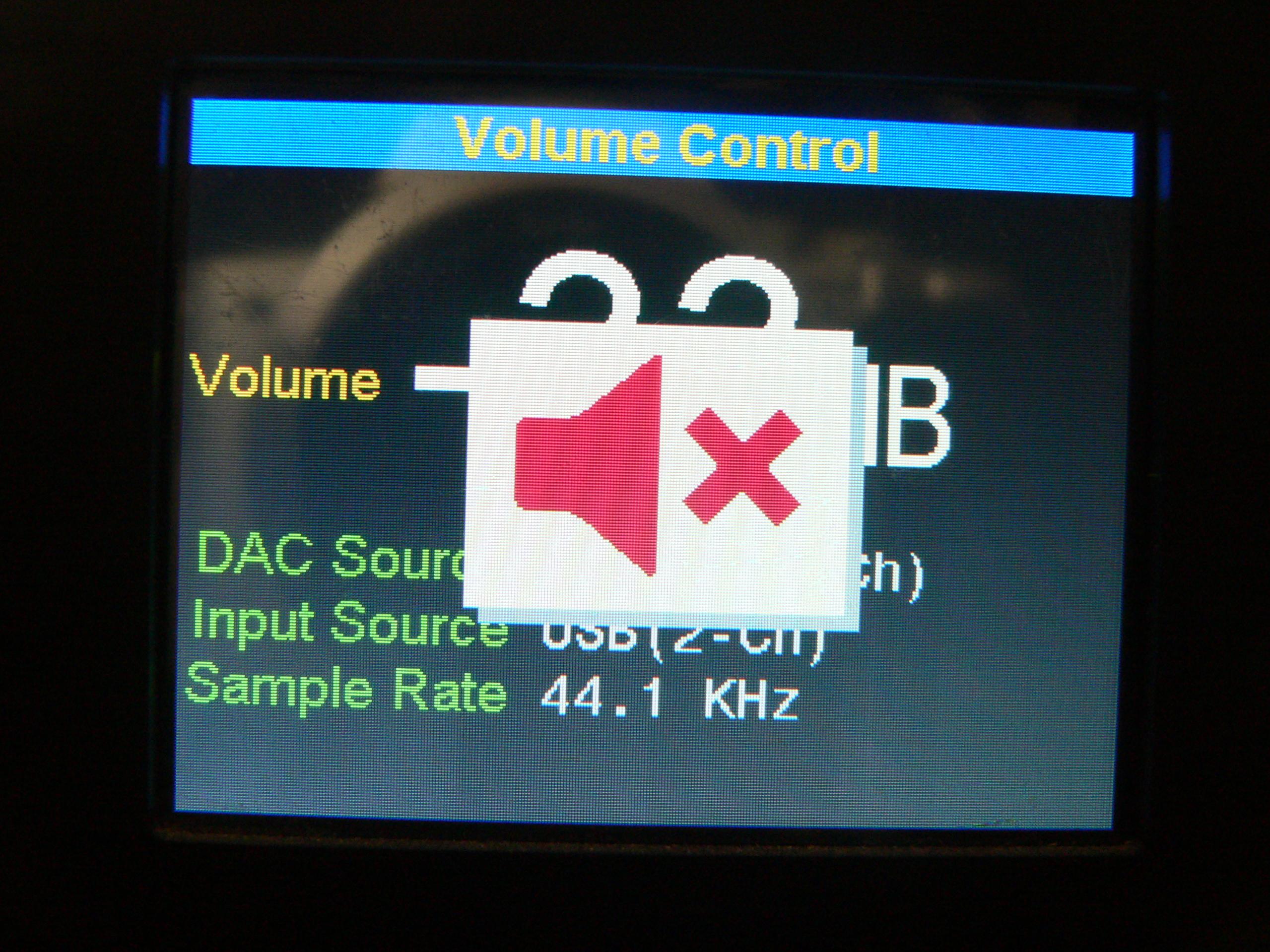

First the gain structure. If I understand correctly the volume control on the front panel and on the remote control is the digital volume control of the ESS DAC and is independent of the DSP processing or anything I do in Audioweaver, right? This is important to me because I always want to be very very sure that whatever I do in DSP can't blow up 4000 dollars worth of loudspeaker drivers. This happened to me ones, and believe me, you don't ever want that to happen in your life. As far as I have looked into Audioweaver a tiny mistake is easy to make, so yeah I want to be the master of the master volume at all times.

Yes the master volume control, controls the ESS DAC volume control and is independent of the DSP. There is also a master mute activated by depressing the rotary volume control or the pause button on the remote. There is also a standby mode which pretty much shuts down everything and even enables the relay muting 😉
