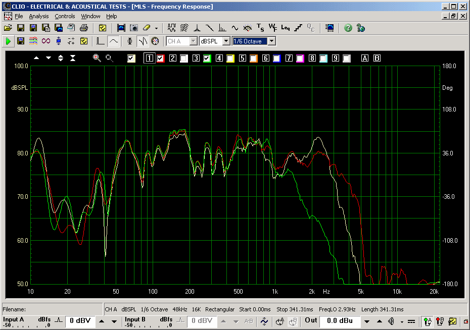

apelizzo,

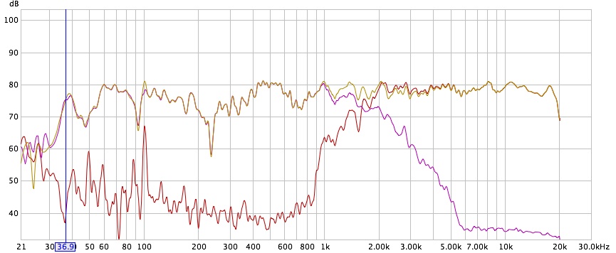

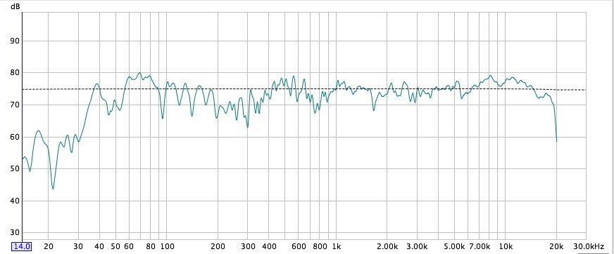

Here the frequency response of the woofer without any filter (red), with my 1KHz (green) and with your at 2.5Khz (white).
mic distance 2meters and height 90cm.
All these 3 plot are equal until 1KHz and only the cut-off is different.
So probably your measurements are in different conditions.
There are 2 image for 2 different resolutions.

to eliminate any doubt about the validity of the cut-off at 1KHz I am sending you the plot showing the distorting of both drivers in the near field (5-10cm).
We can note that at 1KHz the driver CP380 remain at around 1.5% as the woofer.
So with regards to CP380 distortion at 1K I was right: at 2.5K is half. I think ears are more sensitive with 1.5% distortion on mid-high then 1.5% on mid-bass. Perhaps it doesn't mean enything.
Of course other aspects of the speaker system are probably more relevant that overrides distortion objections. In fact I can hear the female voice more clear at 1KHz xover point. Male voice so so.

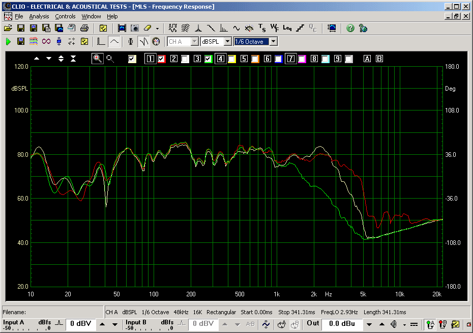

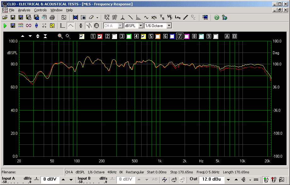

I've done some tests and I agree with you with regards to the directivity of the woofer at 2.5K. Also that nasty 2KHz peak needs to be chopped off with parallel eq filter. That peak is exactly how the crossover simulator predicted.
Are you considering of making the horn frequency response more flat or you leave the natural roll off slope from 2k to 10K (~4-5dB).
Do you feel some details missing?

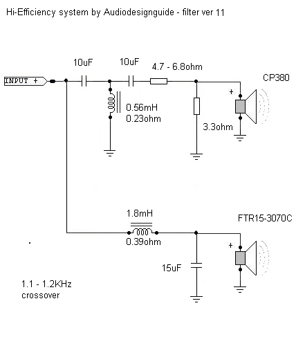

I can see is getting more flat. Looking good! Decreasing 30uF to 10 and less L-pad = more top
I normally use Solen caps. I will try these Solen inductors both from local supplier. (reseller prices in AU$)

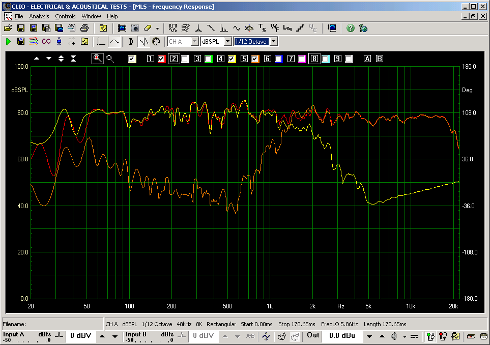

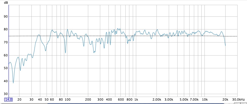

New crossover. Response 1/12 on axis and 30 degrees and 45 degrees
I'm happy with the DDS dispersion pattern.

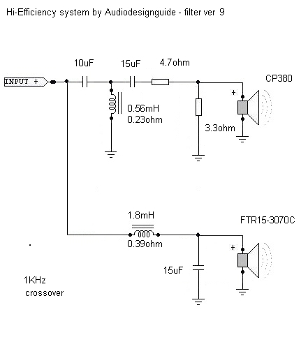

My DDS and Stereolab have different freq response so I modified the Audiodesign xover
Crossover frequency ?
Sound result ?
I don't like my DDS at 1K starts sounding "cha cha" so I compromised your design but not excessive as before at 2.5K. The woofer is not so much directional as before and almost unnoticed. I think this is a good balance for now.
I changed a couple of values in your design. 10uF is now 3.9uF the 4.7R is now 10R and the 1.8mH is 1.64mH. All the rest is the same. It's still under experiment.
The sound is better then before and the sound stage is huge and deeper then at 1K xover point. With one speaker the sound stage is already there and the speaker tend to disappear (horn 80%). With two the horn also disappears 100%
At crossover point the phases are opposite according to measurements so the horn has polarity inverted.
So far I'm happy. Still trying to get a little lower with the horn before start sounding bad.

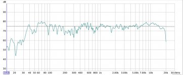

new filter, tested with all Scr caps.
Nice work
![cheers :cheers: :cheers:](https://files.diyaudio.com/forums/images/smilies/cheers.gif)
The horn measures extreme flat very good Andrea. I bet it sounds very smooth together with the low distortion of the horn driver.
