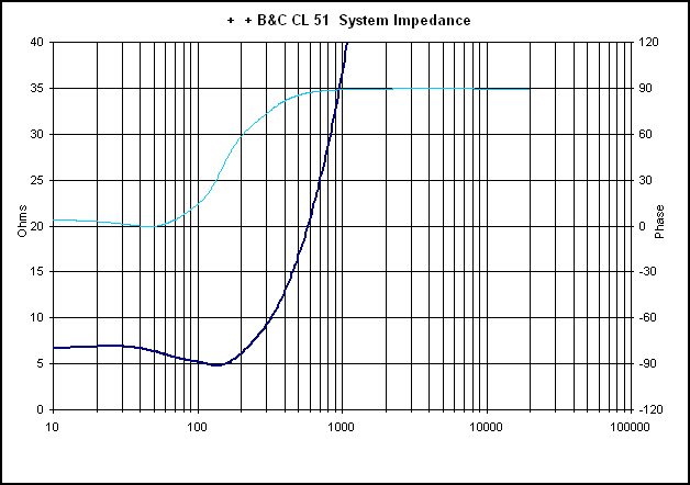

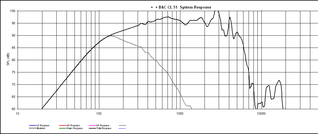

B&C 10 CL 51
I reckon you want something like this. It's got higher sensitivity
than RS 270 and it is of good quality and affordable, it appears so.
In a sealed cabinet of 14 litres with Qtc=0,7.

Ok so now this sensitivity is overboard 😛 101db!!
I should have targeted a range because I am using mid that is 91db and a tweeter that is 92db. i can always padd down the MT but not the woofer.
