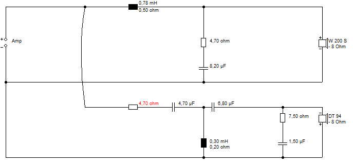

Looks a good substitute for a Celestion HF2001 if you adjust level down. No ferrofluid I reckon and 100mm. This is what I did with that Visaton DT-94 tweeter at 3kHz. Just like the Celestion circuit really. Mylar is overly bright at the top end, hence the 7R5 / 1.5uF Zobel.
Still at it, buddy? You change things unpredictably when you put a resistor after the filter. In front of the filter always works for me, especially with a zobel. 2.2R will be about 2dB into 6 ohms.
I always model things to see how it works.

Yes, I'm still experimenting 🙂
Original tweeter zobel is 8.2r & 1.5uf. I want to experiment with a 'half zobel' 😉
So, which values are you suggesting?
edit: Installing boxsim under linux is bit tricky. But I managed to install. Thanks.
