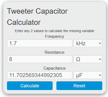

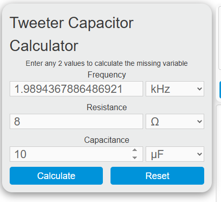

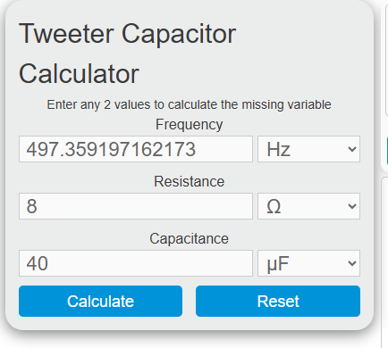

My current assumptions about this speaker is it contains two amplifiers in a bi-amp with a DSP filter between the 15 inch woofer and the horn. The horn is molded to fit the cabinet and replacing the horn is not possible. In the past the original driver may have been damaged by excessive power. The second driver was likely damaged by lower frequency signals rather than excessive power. The DSP has some well though out filtering for the drivers that ensures good sound and has a fairly fast rolloff for the HF driver.
You have a few options here

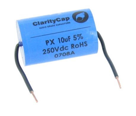

Buy a D280T1 and add some sort of protection filter. You may find there is a fault with the HF amp and may need to abandon the speaker or amps.
Buy the D4400ti and replace the horn if the existing horn is a 1 inch exit. Still add a protection filter in either case.
