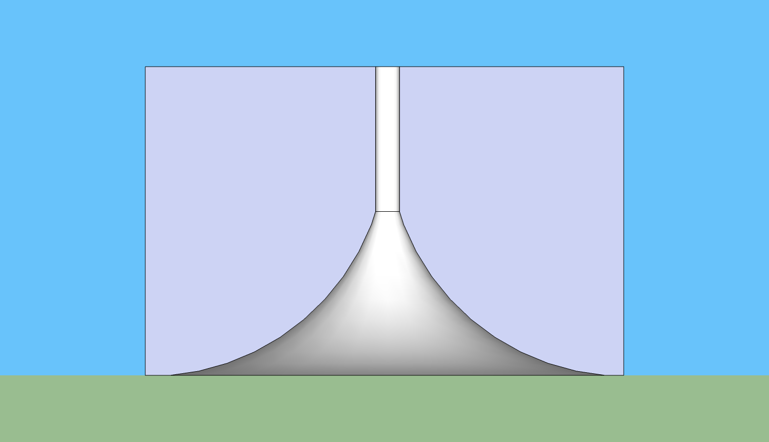

Which one of the two drawings do you like best: the left one, or the right one?
Well, John, the left one. But...seems like there's a lot more going on than just the aesthetics between the two, so even given the other differences, I'd say that one has a lot of promise - along with substantially more effort and cost. Cheers.
I think the left one would be a bit easier to make, to be honest. With that one, I only need to make one mold. Then pour pairs, turn one over and stack their bases together, and the rest is straight forward.

I just wanted to let you all know that I have reordered more silicone, and it has been over a week now, but it has not arrived yet. I am going to do this a little different,in that I have ordered twice the amount of silicone, so as to have a more sturdy inner mold. And instead of using more plaster, I'll go with a urethane outer 'mother mold' which is much lighter and easier to handle.
I don't believe I have mentioned this, but I also have another, yet smaller, lense portion, I had thought of using for a smaller project, before taking my leave of absence. Where the one in the picture above is 13.5" in diameter, this one is right at 11.5".
Here is a picture:
It had been sitting in the back corner of my walk-in closet. While comparing it to the larger one, and letting my mind roam, I remembered that I was still having trouble thinking of a good way to suspend the lense assembly with six metal tubes. Originally I had planned on drilling recesses into the lense and letting the tubes sit firmly into that recess, anchored by a metal washer.
But I had another problem as well. The larger part of the lense is 13.5" in diameter, which is the hexagon's shortest point(measured from half way between the two corners of a side, and over to the opposite side. Somehow the diameter of the lense did not look as pleasing as it would if the diameter had been 16", which is the distance between each corner and its opposite on the other side of the cabinet. Were I to be able to come up with a larger lense, I would not only be able to have a larger one, but also have a means of moving the supporting rods out further toward the corners. But I didn't know how I was going to be able to do this.
And then, right before going to sleep, I had an answer. I could make an outer section, made of high grade plywood, and support the lense from the outer section. But how was I going to affix the outer section to the inner lense? Well, here is where the smaller lense comes in.
If you go back to the image at this post, you are able to see how it is done at Duevel. The Sirius uses two lense assemblies, the bottom one deflecting sound, and an upper one that appears to be channeling the high frequencies. I don't believe this one is critical, and I am going to stick with just one main lense.
But if you look at how the outer section is set up, it is different from the bottom one. On the upper lense assembly, the outer section is partially cut away, leaving the lower section to support the entire lense. This is very straight forward, and easily obtainable. All I would have to do would be to use two 1/4" pieces of plywood, and cutting different size holes to accommodate two different size lenses, which would be glued together. But how could I come up with a smaller lense.
Well, I already have one. It is the smaller one that was sitting in my closet. If I were able to make a smaller lense, and use it as the one facing downward, and also make the larger one, used as the one facing upward, I would be able to create an outer wooden section that would support the entire assembly. I could take the two pieces of plywood, use my router and accurately cut a 16" outer shape. Then I could cut out the holes for each half of the lense, and glue them together. That way the smaller diameter section would be able to support the urethane resin lense assembly. And I could do all of my drilling into the wood, not the urethane lense. It would look exactly like the outer section of the upper lense in the picture.

I have actually made full ceramic speakers using slip casting in a plaster mold for a university project.
I haven't had the chance to read the whole thread, but if I understand correctly, you are trying to create a female mold from which to cast a composite cone?
I think the easiest way would be the plaster mold, with a small hole through at the top. This way, once you lay you fiberglass and resing and let it set, you can force a bit of compressed air through the top and free the whole thing.
I'll try and illustrate what I mean after work tonight.
There's also no reason you couldn't actually make this out of cast clay...

I'm not sure if you are still planing on using plaster for the support mold. But if you are, I would use plaster for ceramic mold making, I'm not sure if the difference between this and industrial plaster is very big but I imagine it would be a finer grit of plaster which is need for retaining extra detail.
This is just a general guide to mixing plaster for this purpose from my university ceramics lab:
Measure your water at 21C (70 F). It should feel
cool, not cold or warm. Too warm and the plaster cures too quick, too cold and it takes forever
Weigh your plaster in a clean, dry, container. Any leftover cured plaster in the container will activate a fresh mix quite a bit faster
Sieve or sprinkle plaster into the water. Standard kitchen sieve would do, but the finer grit the better.
Slake the plaster for 3 minutes undisturbed, except for the occasional tap on the side of the container. You could let it slake for quite a while before running in to any issues. Another thing to look for is the water will creep on the dry plaster mound, once the whole surface is slimy looking, you can start mixing.
Mix by hand for 4-5 minutes, making sure you donʼt
introduce air bubbles. Look for the little trails.
Pour your plaster gently so you donʼt introduce any
air bubbles.
Bang the table top a few times to dislodge any bubbles on your mold face.
Getting the ratio right the first time also helps, for this you want 66ml of water to every 90g of plaster.
A good mix of plaster should not crack.
If you want to get the nicest surface with plaster, you can mix a small batch and brush it on. this will get a nice bubble free surface. After that, you can just plaster over it without worrying about bubbles and whatnot. Instead of pouring the plaster over, you can also wait for it to get to the consistency of sour cream and just slap it on with a spatula or something. This method wouldn't even require a box, but its tricky to get the timing right.
Instead of doing all this, could you not just lay fiberglass on the existing greenware mold? After that sets and is removed, you can sand and smooth the interior surface, rub some mold wax and lay fresh fiberglass in.
I've tossed in a quick render of what I meant for the mold. essentially you would have a small (size of a pen) hole towards the top from which you can send compressed air into the cast.
